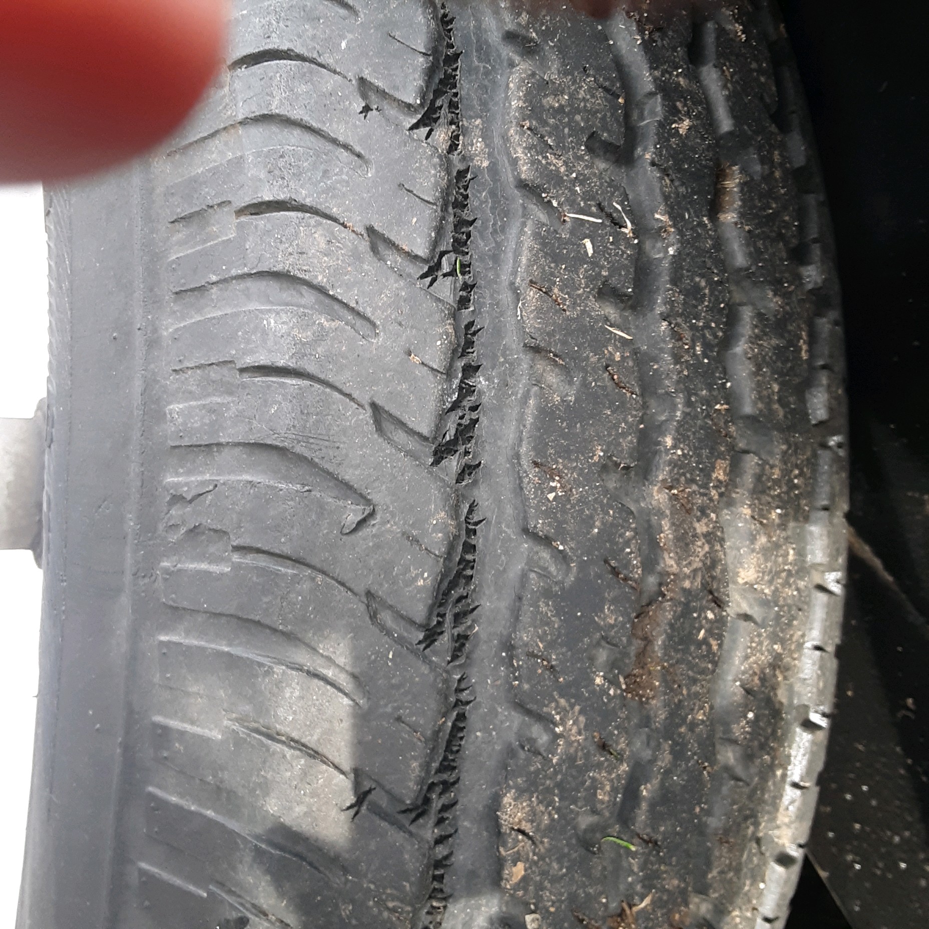

i'm on my second set of trailer tires in 2 yrs. both sets of tires have separated. both sets of tires from china i believe. what do you guys like for 7K car trailer tires. thanks

It would be interesting to know more about the blown 205 75 15s. Brand, type (P, LT, ST), load and speed ratings, bias or radial, recommended pressure on the sidewalls, etc.
If your trailer only has 15 inch tires, you are probably regularly overloading it. 15 inch wheels probably only has 3500 pound axles.

the trailer is a 16ft car trailer. hauls a race car, small tractor for the neighbor, long lumber and stuff like that, hasn't been overloaded. tires are 205 75 15 and i keep 50 lbs or so in them as per tire store.
Always inflate tires on a tandem axle trailer to sidewall maximum. The inherent stresses of tandem axles in turns are very hard on sidewalls. The stoutest sidewalls are bias-ply LR E, ST tires. https://www.easternmarine.com/arisun-st225-75d-15-trailer-tire-load-range-d

the tires didn't blow out, the plies separated. 3 of the tires on the trailer look like a egg mounted on a wheel. the first set i bought in 2000. not a lot of tires to choose from. when they separated i bought these tires from local large tire dealer. they are no better.

205 75 15 covers a wide range of tires from "may pops" to high quality tires. Beyond saying they are 205 75 15 tires you have given no info about the tires you are using. Knowing what you have used might get more thoughts to help with your issues.

the tires are towmax 8 ply. the dealer no longer sells the brand. the dealer told me the tires were a better quality tire when i bought them. i'll do some research before i purchase new tires, i have a 24 ft deck over 14k trailer as well, but overkill for most of what i do anymore. it has 16in E rated tires i believe.

Reviews I find for Towmax trailer tires include a number of tread separations and blow outs, a few saying they got good service. Given the 205 75 15 size you will likely be better served with a better brand name, like Carlisle, 10 ply tires and keep them inflated to the pressure on the side wall.

i agree. that's the way i'm thinking. thanks
