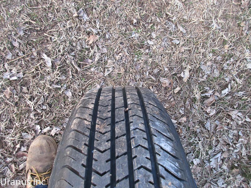

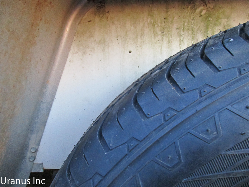

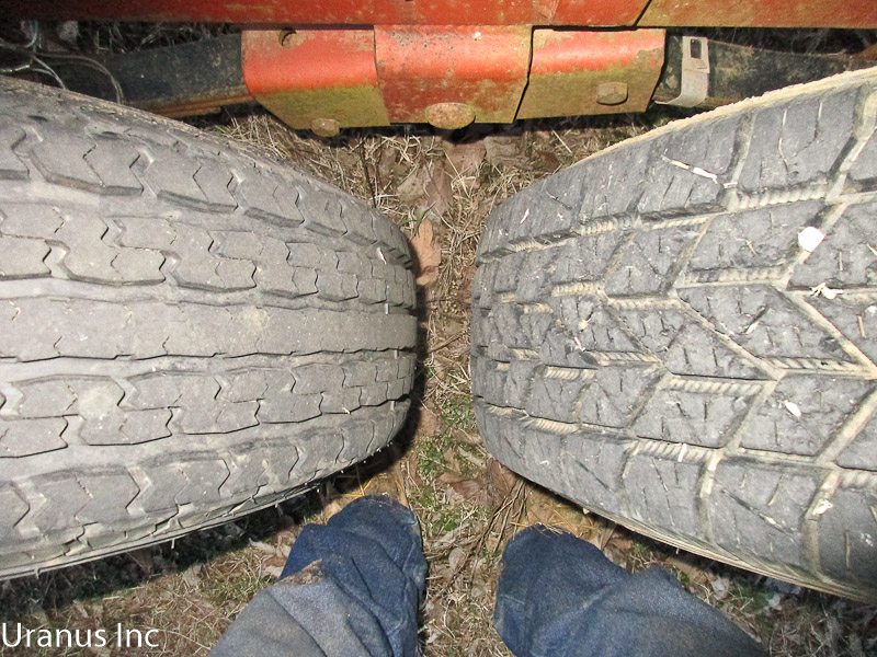

All tires are load range G.......14 ply....90 psi air..........
2006 Dodge 1 ton....
Cummins Diesel...Trailer is always loaded...Tires on W9 / WD9 and 600 are loaded......
Case 930....WD9...and 600 are placed on blocks...........
Tires are balanced.....:)
Tires are designed for a TRAILER.......
I have been flagged into a Government Scales...........all was good....:)
Bob.......
