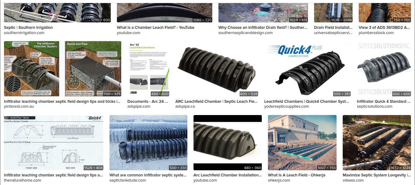

The tree is a Siberian Elm within 8 feet of one of the lines on the leach field. Soil is all Clay. The system uses half round plastic pipe approximately 2 foot diameter from what I can tell. very little rain falls here eastern Colorado. I think our annual precipitation is around 12 inches to 17 inches.

From what you have described you have what's called an 'infiltrator' style leach field. Similar to what's shown in this picture.
These types of systems are pretty forgiving and very suitable for clay soils (very poor drainage in clay). In my experience most of the effluent water rises through the soil to the surface (slowly) and is evaporated away even in winter. Depending on what your effluent flow rate is and the fact you don't get much rain, that tree is gonna love getting some water. Its just my opinion of course, I would not worry about that tree upsetting your leach field in the least. Now I wouldn't go planting trees on top of the leach field but 1 tree 8 ft away from one of the 'chamber trenches' isn't gonna hurt anything. Then again if you don't like that tree anyways for what ever reason...
8 feet is awful close. In dry conditions trees seek out water, and when they find that close line will stimulate more root growth to catch more water and nutrients. It’s not uncommon for a tree to completely plug a tile line with roots as they increase the root mass in that area. Generally the roots are as far out as the branches above. We put tile 30 feet from a tree and run into problems sometimes.

The chamber system described is not affected by tree roots if draining properly. It is not like a drainage tile or a sewer main that are full of water , tree roots will not grow into open air space under ground and will not plug a chamber system.
