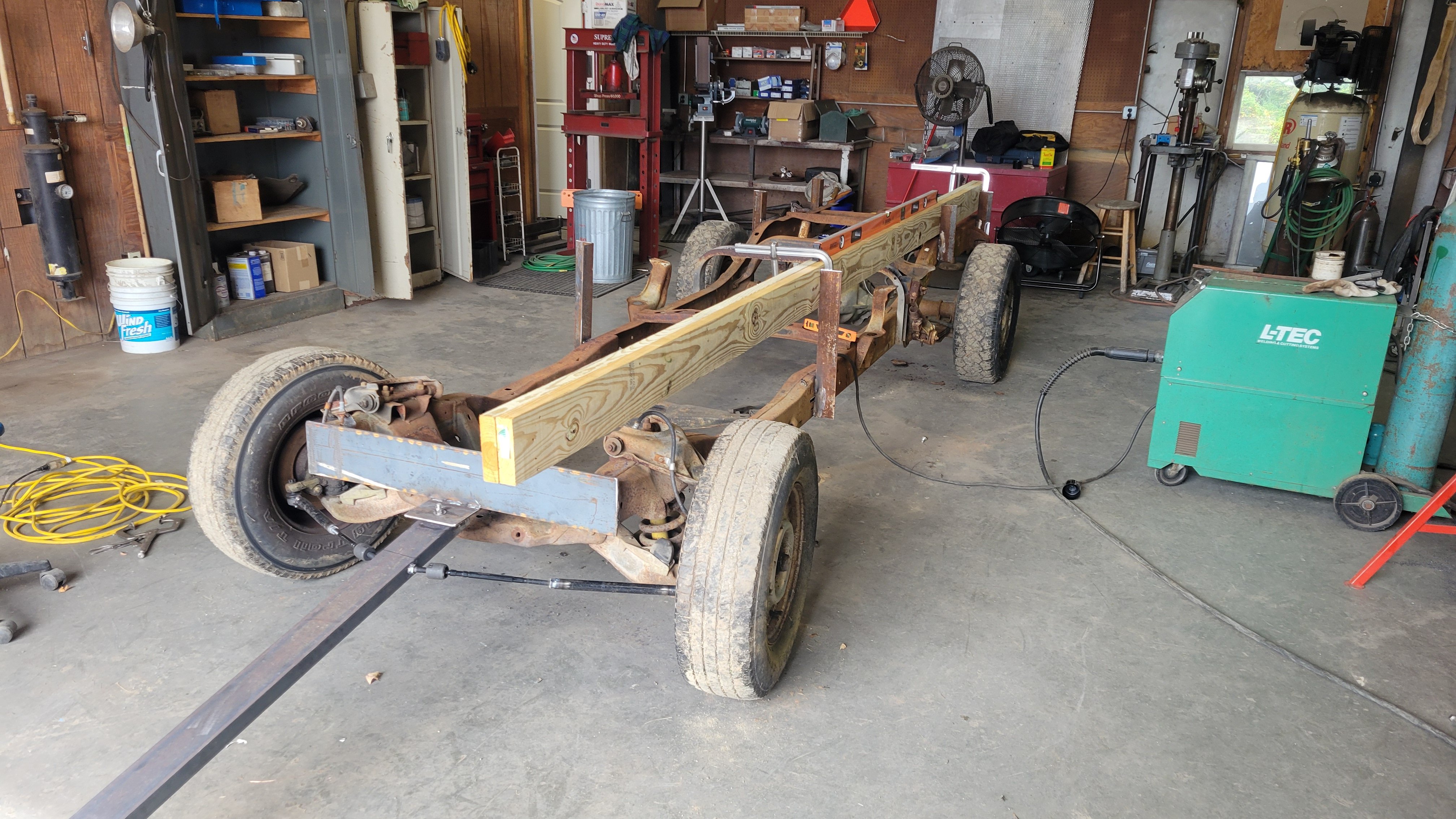

A couple months ago I posted to get information about a tractor that belonged to a friend who passed away. I figured I should also post this here as yall might enjoy it. One of the projects that my friend had sitting around and never got to was turning the truck frame from the truck he started his business with and turning it into a hay wagon for our church to use for hay rides during our fall festival. I decided I would make it happen with the blessing of his wife.

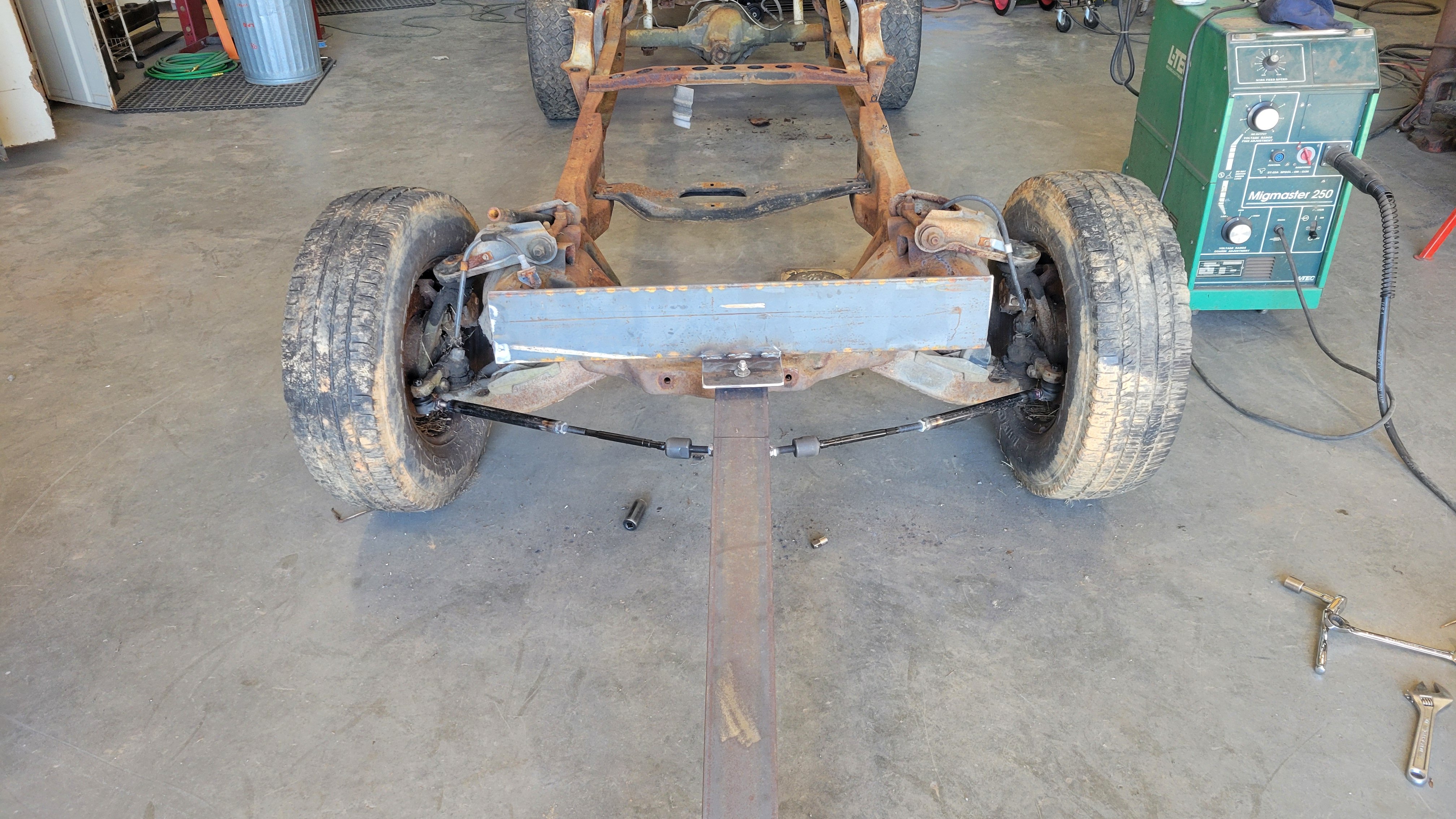

I cut the frame and welded a plate across it so I could mount the tongue. Then I fabbed up a custom steering setup.

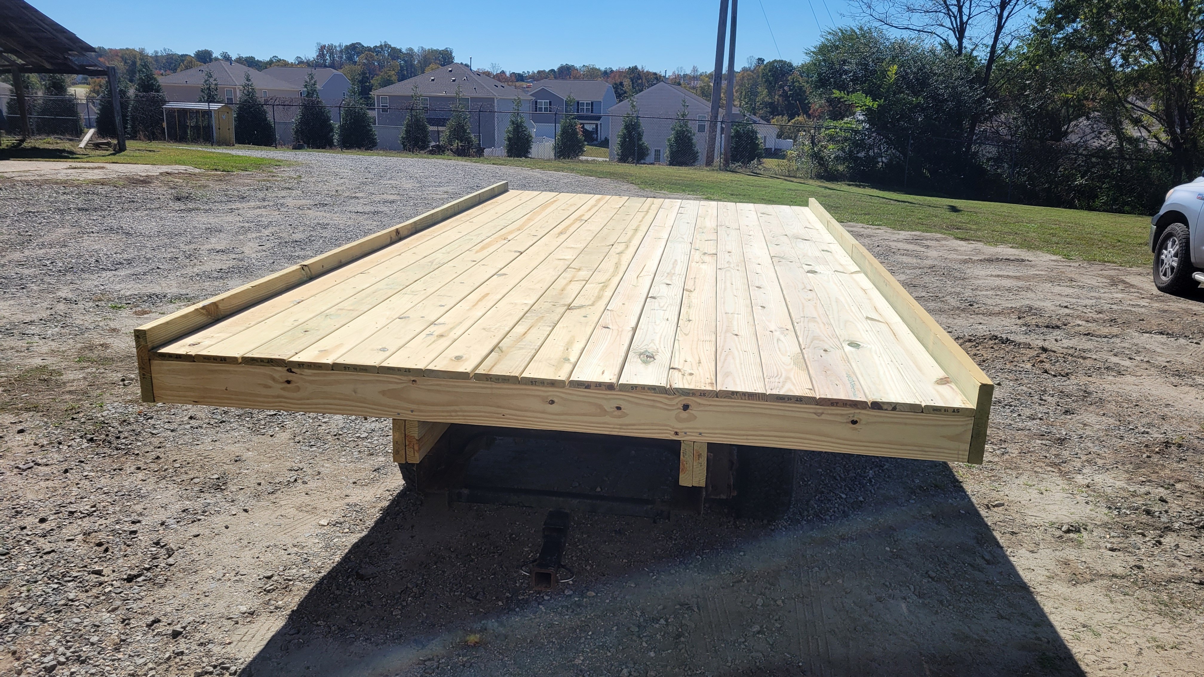

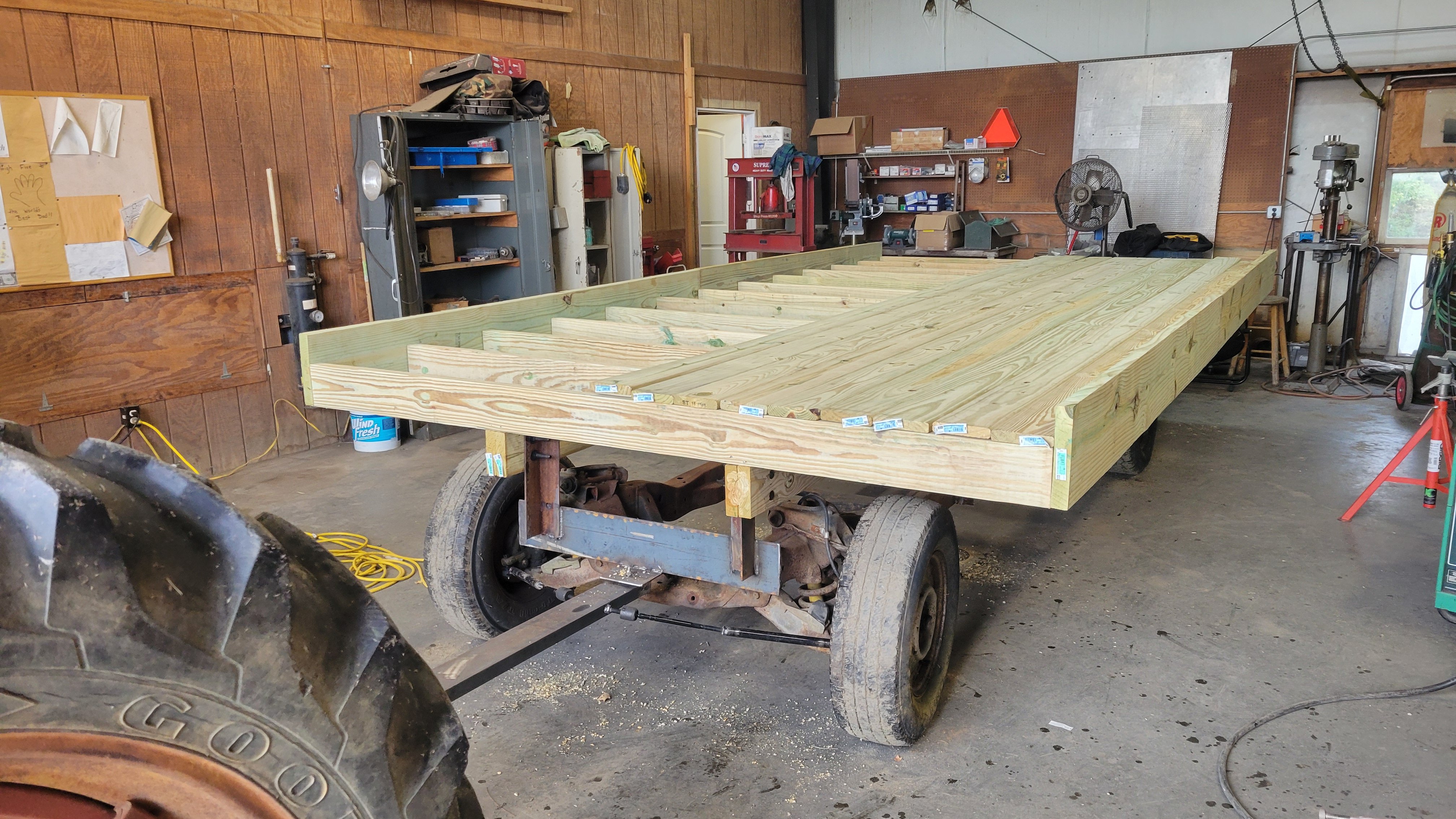

Next I welded on supports for the runners and attached the decking.

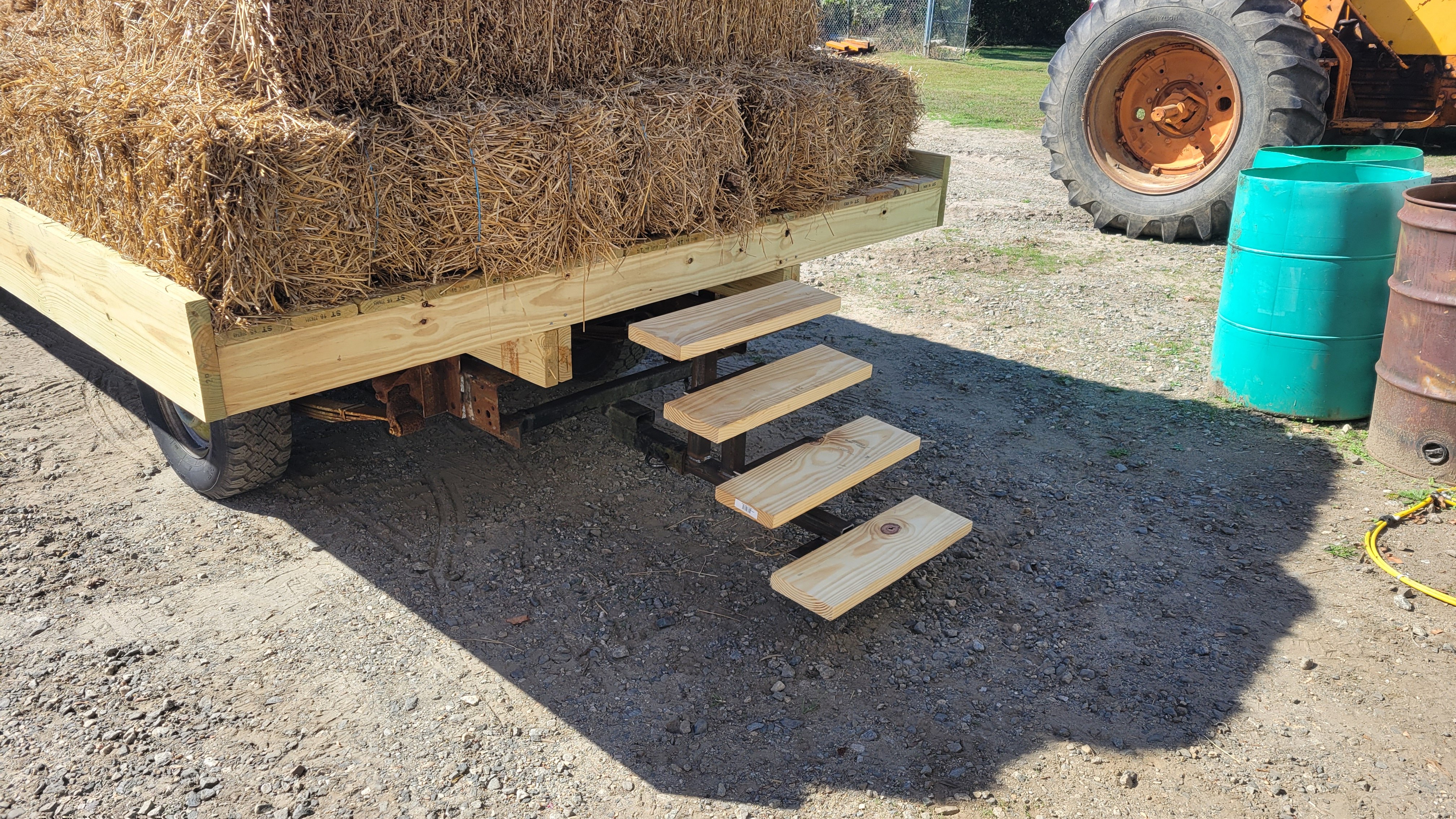

And finally I put on some steps to make it a little easier getting on and off.

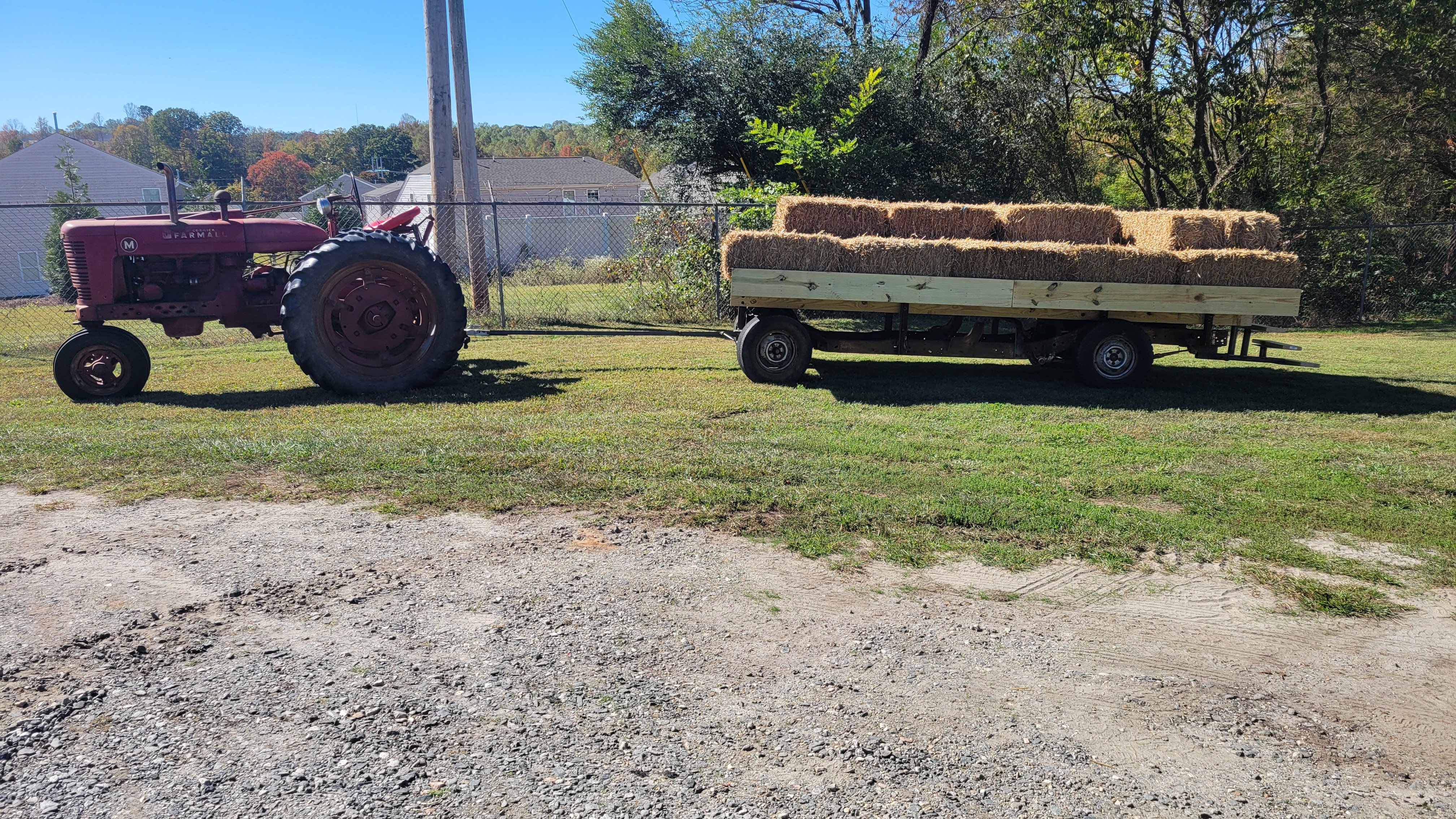

The fall festival is Saturday at church and I'll be pulling the wagon with his M for the afternoon.
