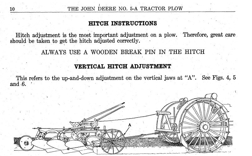

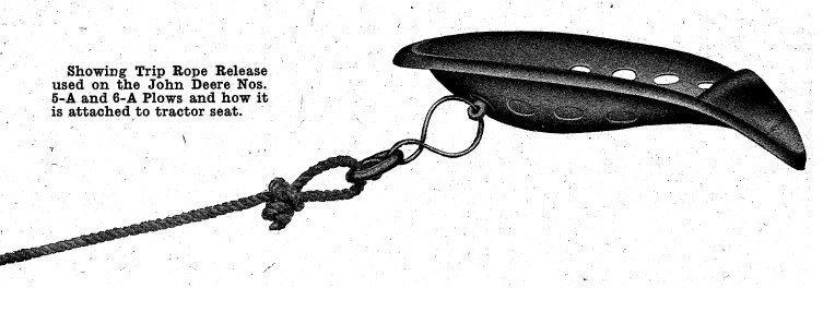

Never asked Grandpa...How does this work? Rope tied to a metal ring? Just a big knot in the rope? Ring or knot into the first twist or all the way up?

Jim.ME: Did that operator's manual happen to describe rope size? I appreciate the help.
its nice to have at least a half inch rope , so when you pull on it you have some grip. say compared to a 1/ 4 inch rope. it dont take much of a rope to trip the mechanism.

I am looking at DIR140 for a 5A plow. No size is given for the rope. There is a part number of 13904. I believe the clip is supposed to release the rope if the plow breaks away (the direction calls for a wooden hitch pin for the plow, but not too hard of a wood). The breakaway clip would let most any rope at hand be used and release if the plow broke away.
When I was a kid I made the mistake of tying the rope to the spring under the seat of a farmall M When I hit a big Rock with the plow and it unhooked the rope pulled the spring out and down came the seat. I hooked my legs under the light bar and pulled myself up. Once I stopped shaking l looked around to see if anyone saw me. After that I always used a piece of tie wire to attach the rope to the seat!
that is why u use a round metal ring on the end of the rope. such as in old horse harnesses for example has them. some of them plows had the actual hitch trip if you hit a big rock or stump. so if you loose the plow the rope must unhook also. or pull the seat off or break the rope which is what would happen. i have even used a light wire so that it breaks and can tie it anywhere handy. i have one of them breakaways for the steel seats just like that.

Somewhere I have a bag with an NOS plow rope with the John Deere tag and part number, pretty sure the rope is 3/8 inch diameter.

When I was a kid, I remember one of them was replaced with clothes line rope. We also had the seat clips then.
We always used a rod instead of a rope on Oliver plows. I use a rod on the one I have now for plow days. Of course the Olivers were made different. The crank was up on a standard and you can run the rod through that.
I've never seen a picture of those clips used the proper way, all I've seen in the wild is the rope was tied to the spring clip and the seat edge or something similar had a hole for attaching to the tractor.
Was it a wooden draw pin or a dowel that went through a hole in the trip mechanism in the hitch?
We had a Case SC that had an outfit that was like a rat trap made right in to the bottom of the seat assembly. You'd just put a loop in the end of the rope in that spring trap.

Dad just tied a knot in the end and we just slid the rope into that first opening. This was on the John Deer plow , as the Oliver plow had a steel rod with a loop for your hand.
