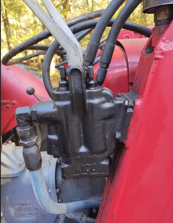

My old Workbull 202 has been a good tractor but, today, I must have broken something in the hydraulics. I was digging in a pile of wood chips and on one pass the bucket went down but when I went to lift it again nothing happened. The lift handle was just loose and would go down and raise the front wheels off the ground but would no longer lift the blade off the ground so I could drive the tractor. In the photo it is the lever on the left. The spool goes up but will no longer go back down into the valve body. Sounds like metal to metal when I work the lever. I assume I need to take this off and have it rebuilt I really don't know where to begin so I appreciate any suggestions.
The valve body is marked AICO A5A-44R. I know it's obsolete but I hope to find a used one. If the spools or a rebuild kit were available I could have this rebuilt but they don't seem available anywhere. Anyone know of a source?

You can pull it apart and if you are lucky, the centering assembly on that spool might have come off the end of the spool.
As for replacing spools. Most valves, especially of that vintage, did not have replaceable spools, they were fitted to the bore in the valve body. So, I would say the thought of replacing a spool is out. It is likely you won't find a kit either. It likely only has a few O-rings, which you can match up at a hydraulic shop or equipment dealer. I would stay away from the hardware store pull drawers.
If the tractor and loader are in good condition and you plan on keeping it long term it might be to consider up grading to a new valve. It will take some fabrication as I believe the valve's return to reservoir port is through the mount to the loader frame.

Hi Jim, What did you end up doing with the AICO Valve? I also have one of these that has a broken bottom cover.
Tim K
Pull bottom cap on valve centering springs are right there. You can make a gasket for it if need be it's already broke might as well look in it
Really nothing to those valves

Hi, Tim, I have the old valve off and a new one mocked up with hoses attached except for the return. It's temporarily mounted to a 2x6 to approximate the final mounting position. I have a guy who is making a cover plate and plans to weld some angle iron onto the plate to mount the new valve on. I am not sure how quickly this will all come together but once it does, if all works as well as I hope, I will be glad to share any parts from the old valve. Is your valve mounted on the right hand side of the tractor? They also made a valve to mount on the left that has some casting parts reversed.
Hi Jim , That would be wonderful. Let me know how it goes. Mine is located on the right side. I would think the bottom cover plate would be the same on either installation.

SUCCESS!
I finally got the old AICO hydraulic control replaced on my MF202. It took a while to find someone with time and expertise to cut and fabricate the new mounting plates.
I purchased a Summit single joystick #P80G-2A1 21 GPM and had them add "float" for $50 extra. Maybe I won't find much use for it but wanted to modernize as much as possible. I only used the new valve a short while but it seems to be just as fast as the original. It does surge a little when going up all the way but that could probably be air in the lines as I mussed around for days trying to make the lines reach without hitting each other. That was the hardest part.
As you will see in the photos, I mounted the new valve just a few inches ack from the original and a little lower. We cut a plate to cover the discharge hole in the loader frame and then welded an ORB weld-on port to it. We then made a template of the mounting holes on the new valve in the mocked-up position where I wanted it. We cut the steel plate and drilled it for the valve and to attach to the new discharge plate. This was all way over my expertise but the guy that did the fabricating made it all look easy. I looked for a quite a while before I found someone willing to fabricate this mount.
The discharge on the new valve and the new discharge port on the frame ended up to only be about 4" apart. I was told that it could be hard-piped but I really wanted a hose so as to absorb any vibration. I ended up with a 45-degree elbow on the valve and a 90-degree elbow on the loader frame so I could route a 36" hose between them without kinking. There are so many hoses there now it isn't really noticeable that there is one more.
David - the bottom cover on the old valve looks fine. I will be glad to send it to you if you PM me your address. It looks like the retaining clip popped off of the bottom of one sleeve assemblies and that's why the valve stopped working. I am sure all these parts are worn out but if anyone has a need just let me know. These old valves are impossible le to find parts for and I looked a while before I committed to replumbing a whole new setup.
