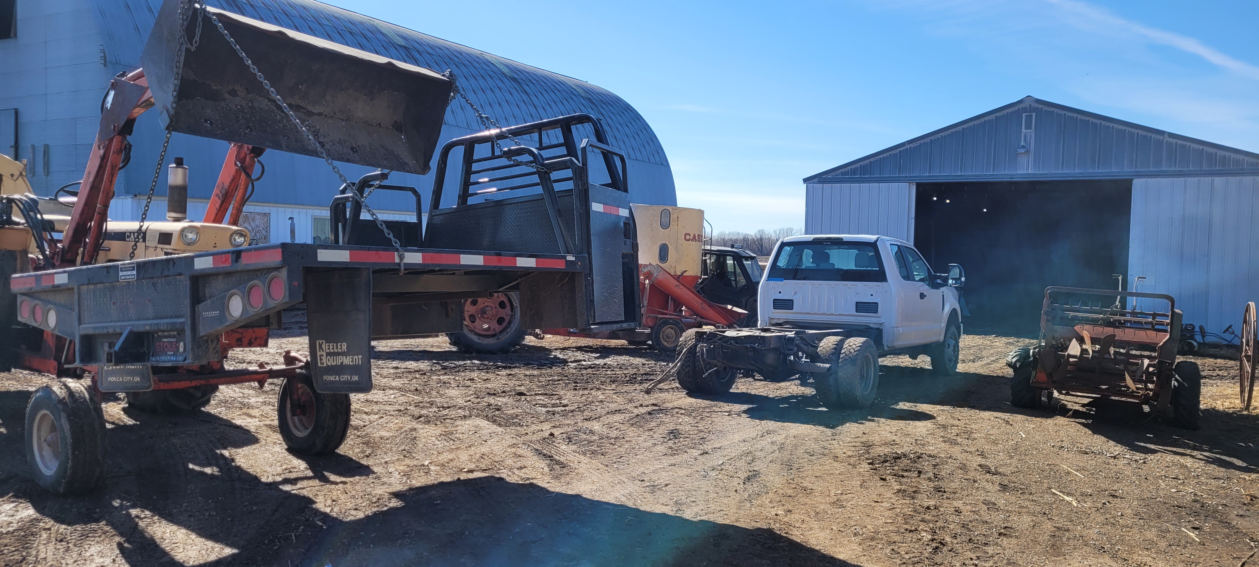

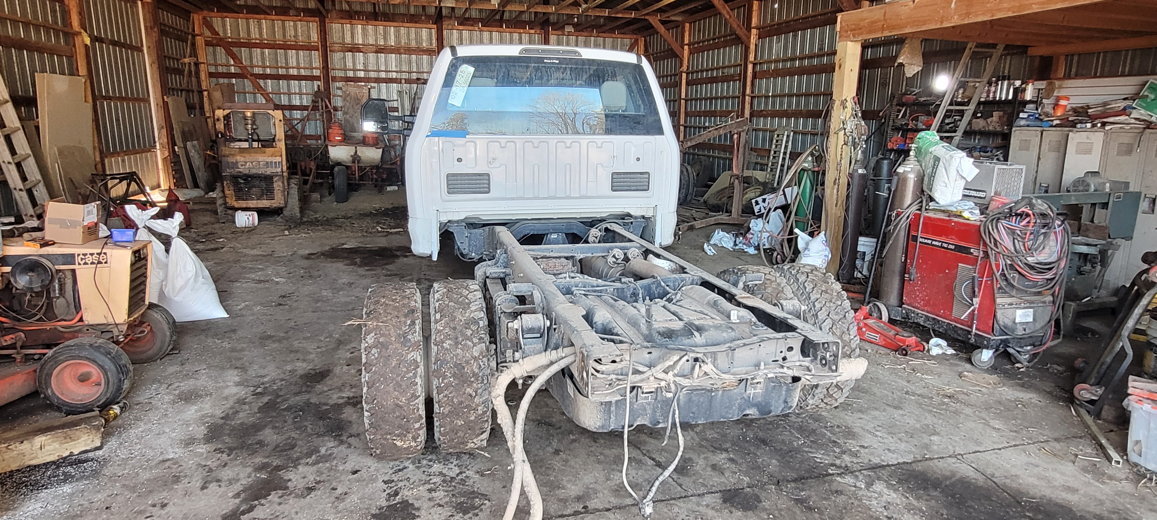

Spent most of the day putting the finishing touches on my 530 so it's all ready to go to work. But I did get started on the truck bed project. Picked the steel bed off, it is very heavy,, I'm guessing close to a ton. It is made out of all 1/4 and 3/16 steel.

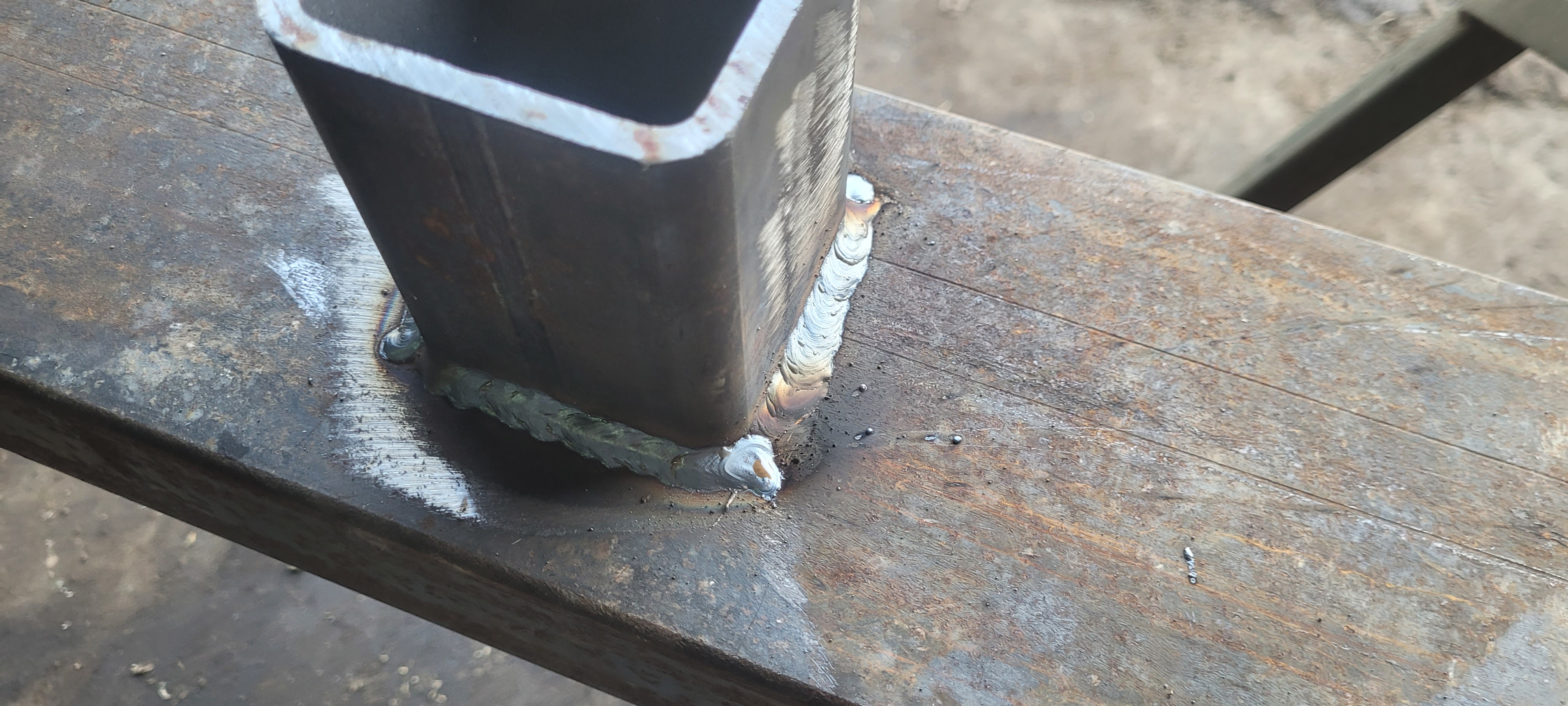

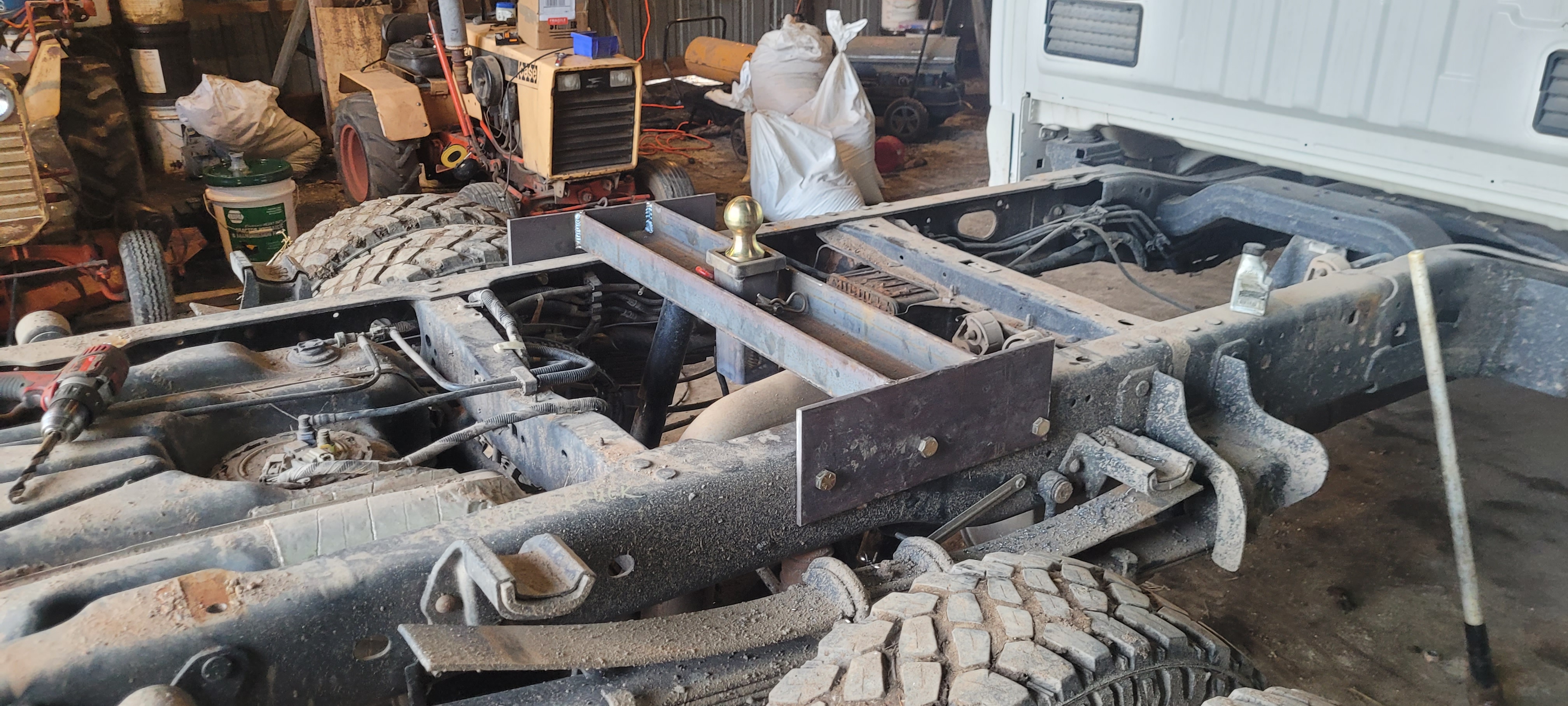

Got the gooseneck hitch made and installed today. Started with a real heavy channel.
Bought a removable ball and sleeve and welded that in.
I welded a sleeve inside for the ball to sit on so the pin doesn't have to hold all the weight.
Put 3/8 plate on the ends to bolt to the frame.
Finished with a couple safety chain loops.

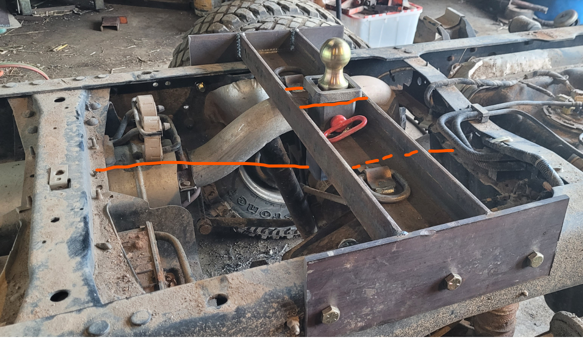

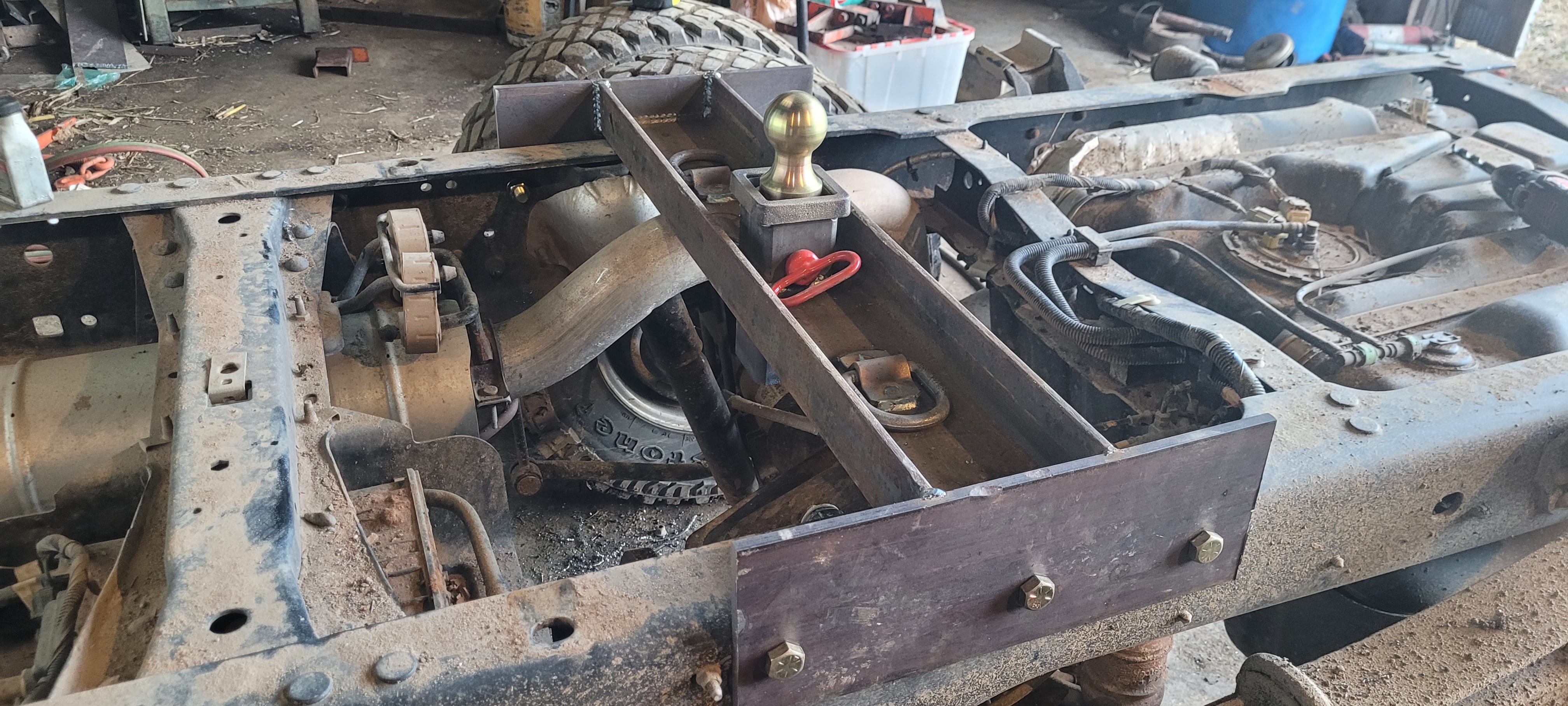

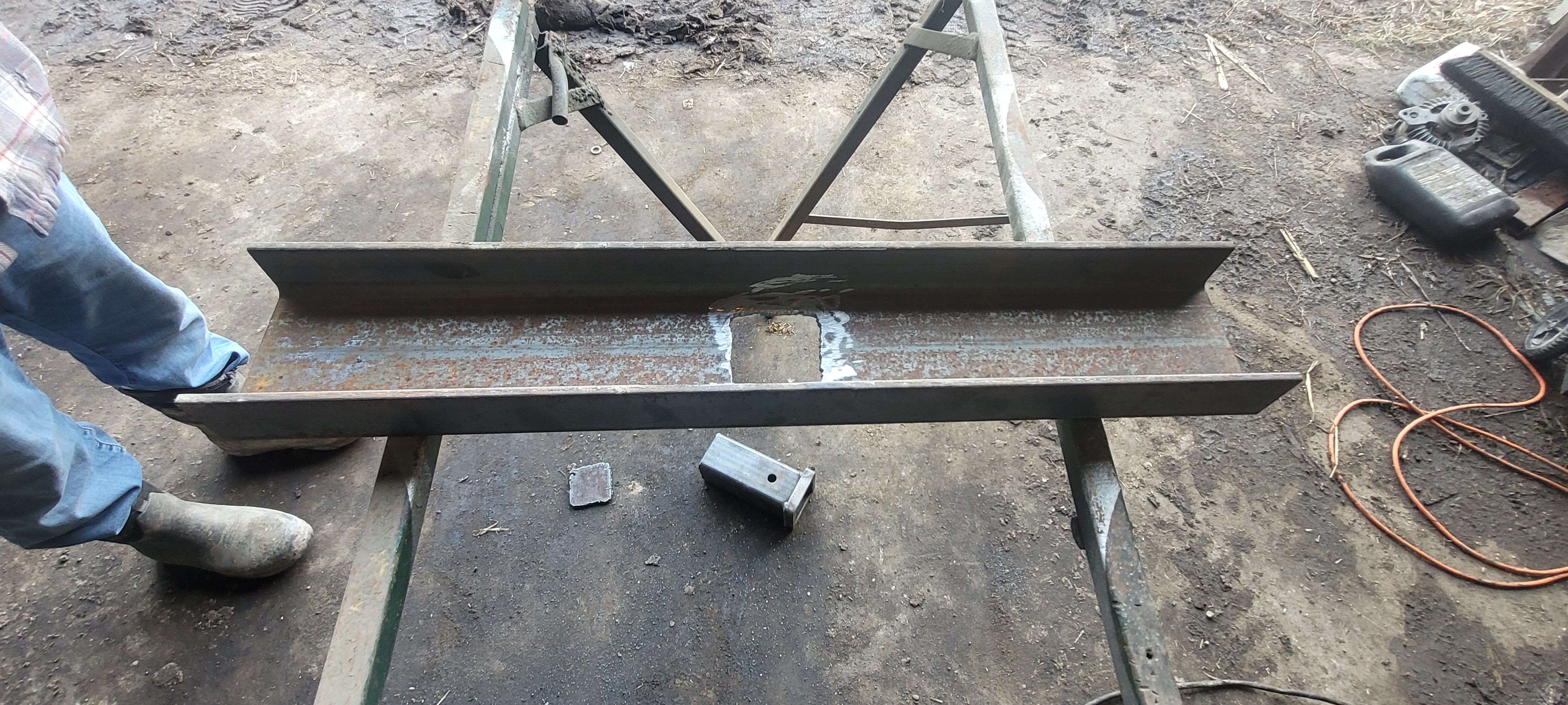

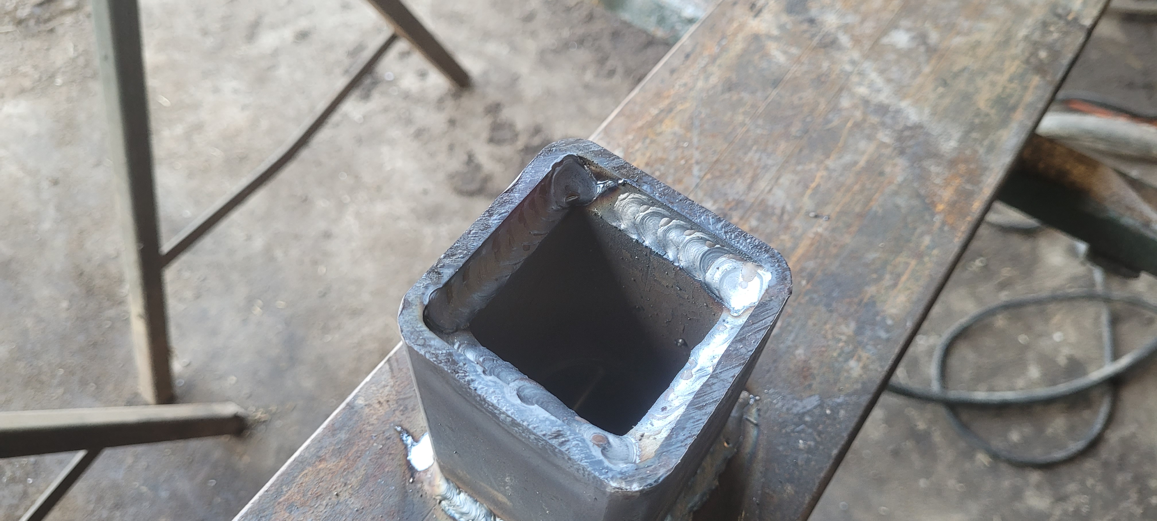

Tomorrow I'll start on the new aluminum bed.

Are you concerned that the channel is going to collect a lot of dirt, salt, etc the way it's sitting?
If it remains open to the truck deck, and a couple of 1 inch holes are put in the horizontal (bottom) surface, it should be OK. The folded tiedowns lean toward that assumption. Jim
Thanks for reminding me, I had intended to cut the end plates down in the center of the channel where it's not needed for drainage, but forgot. I would have been Lee's than pleased when that was full of water ad it was all done. Lol
@jon f mn
I like it. But.......................
Common channel iron tends to be all toes and little web, unless it is ship channel.
So depending on web thickness, it might be a good idea to stabilize the tubing to prevent forward and reverse forces on the ball from flexing the channel web. Maybe a brace from very bottom of tube to the cross members, fore and aft? Or a "X" brace starting at the bottom of tube and going out to secure to frame.
But this is coming from a guy that worked in a fab shop when small pieces of steel for a project like this walked out the door at the end of the day when the owners had already left for the day.................
