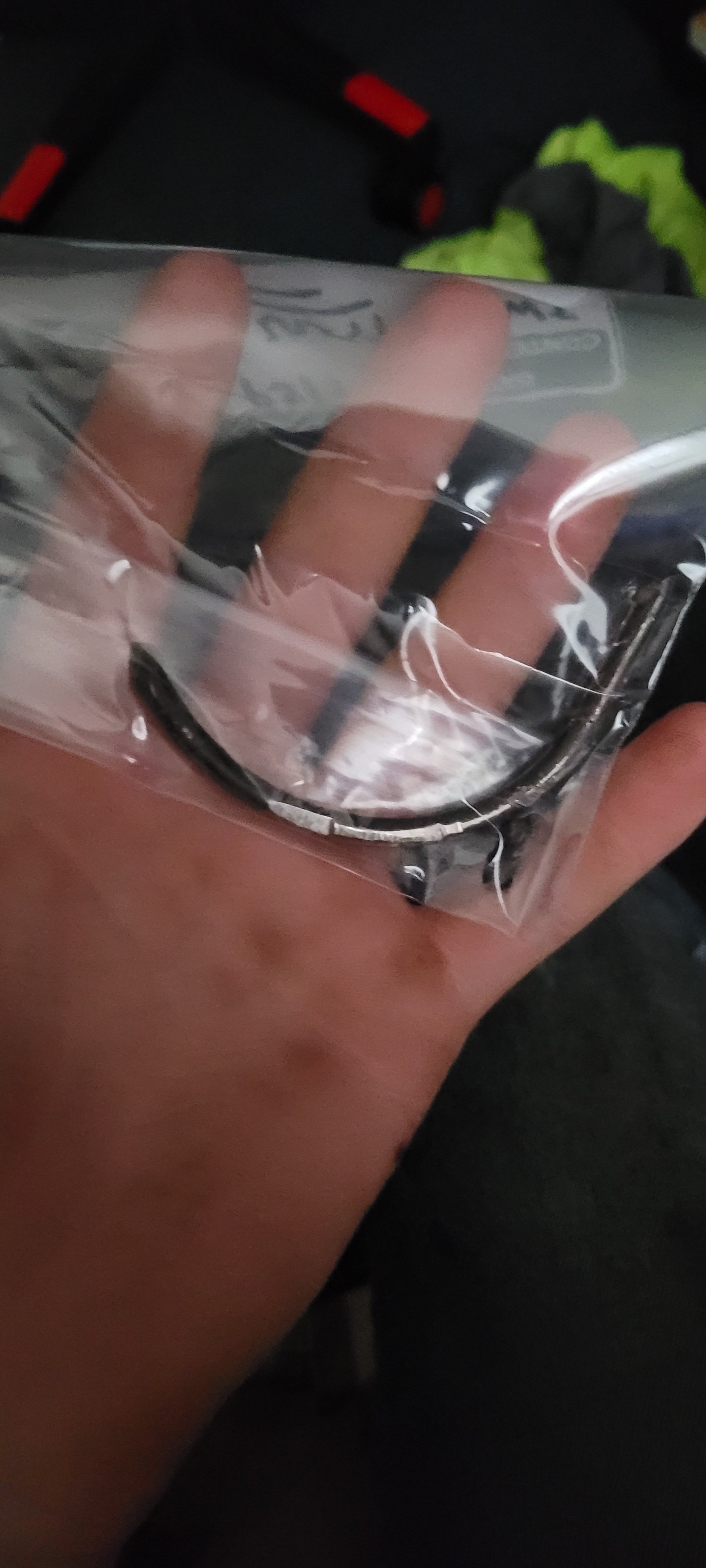

So, I drained some fluid out of the main tranny which I believe is the one that connects to the engine. I stuck my finger up in the drain hole, and felt chunks. I pulled out a piece around 3in long. It was sheared and bent I belive. I will link a picture to this post. Any idea what it is? The oil was metallic too which didn't surprise me after I pulled those pieces out. Can I rebuild this transmission without taking off the cab? Just splitting the tractor?
So, I drained some fluid out of the main tranny which I believe is the one that connects to the engine. I stuck my finger up in the drain hole, and felt chunks. I pulled out a piece around 3in long. It was sheared and bent I belive. I will link a picture to this post. Any idea what it is? The oil was metallic too which didn't surprise me after I pulled those pieces out. Can I rebuild this transmission without taking off the cab? Just splitting the tractor? View attachment 92084
It doesn't matter at this point what the piece is, you are looking at a transmission teardown. Yes, the transmission can be removed without removing the cab. I support the front of the cab and roll out the engine and trans as a unit. The trans can then easily be removed off of the engine.
