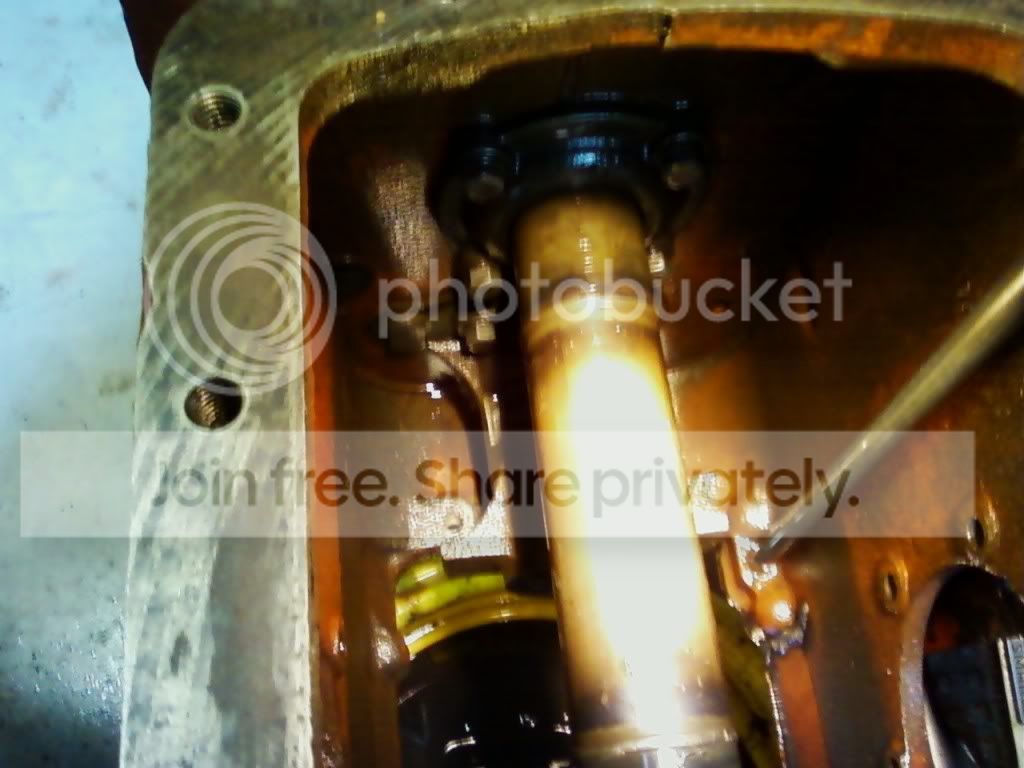

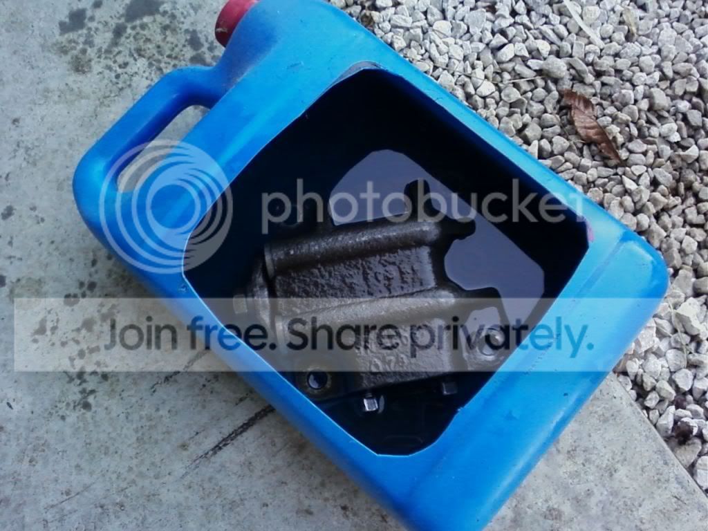

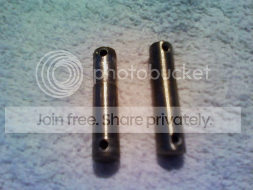

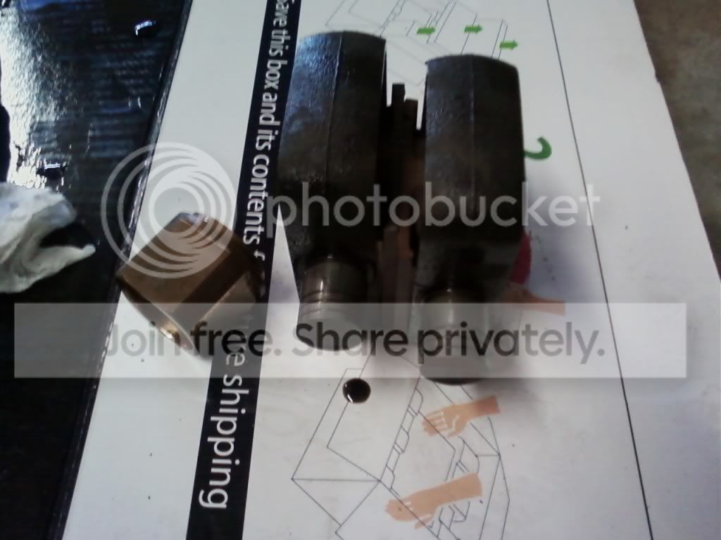

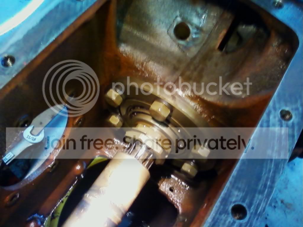

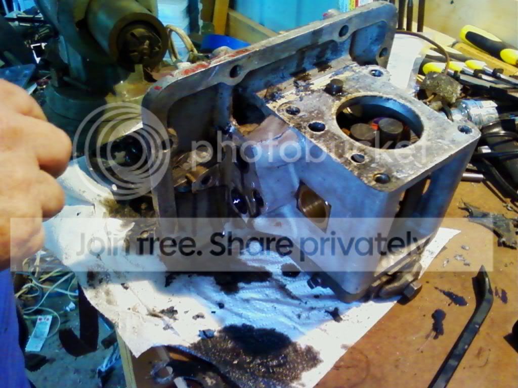

Have the pump down and in work cleaning it up. the dowel pin for the rocker shaft was worn so we found a bolt that fit and made a new one.

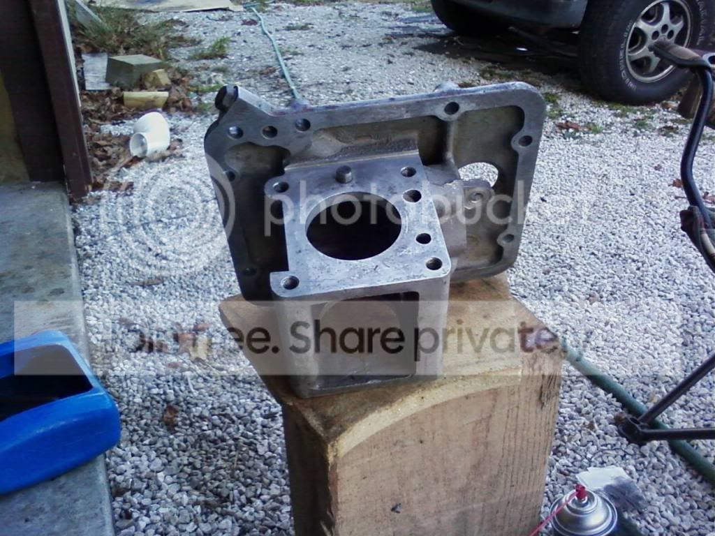

Things did not look too bad in the housing so clean up will not take that long, the hard part is getting the old gasket off the valve chamber face, but will take our time with all of this.
For the end of nov, 56*, it sure is a nice day here in sw mo. We have all the parts we need for now and Zanes jig, so should start to get it back together next week.
