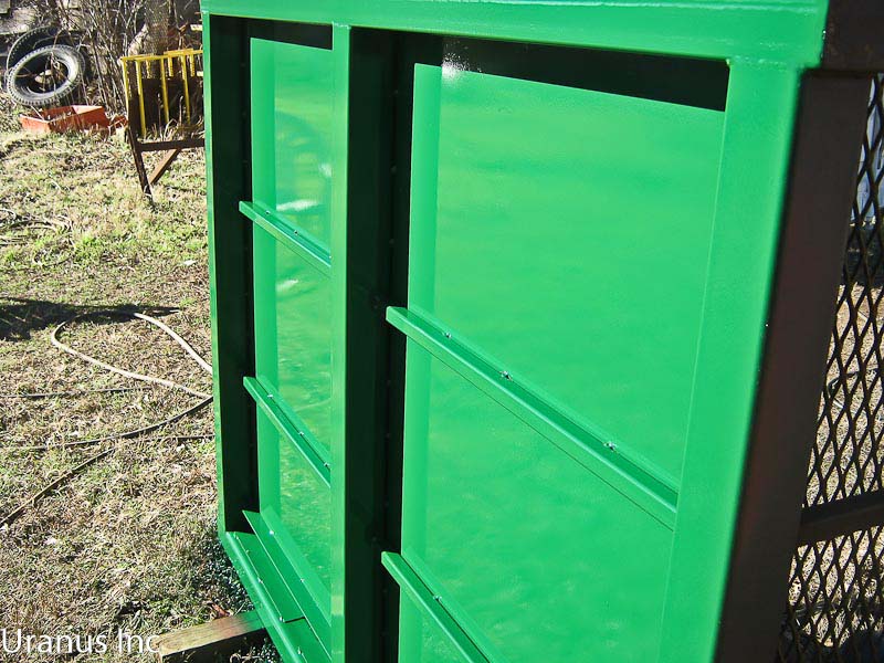

I couldn't wait to shoot the paint on the trailer when I finished building it.........................nice!!!! (Van Sickle properly thinned for spraying)
Then, like me.............many years later it started to fade..........................
The important thing, and the reason I swear by Van Sickle...............NO RUST.
I use their red oxide primer, followed by a mist coat, and at least 4 properly thinned coats of color.
Thin your primer........reasonably.......not water thin.
Your paint needs to be thinned to the consistency of milk. VERY THIN. I use mineral spirits because I paint outside, and I need a "slow" thinner to increase my flash time, and make for nice spray pattern consistency with no overspray (banding). I allow it to flash to a tacky surface, then do another coat. Gun set at 40psi, all patterns overlapped by half. This stuff will give you close to an automotive finish............which can be preserved if you care to spend the time, and money, to add hardener, and clearcoat it.
My carryall turned out nicely too. I love this stuff. But, it will fade if you don't clear coat it.

Edit: All of the above pics of the rebuild were taken with a 35mm film camera, later scanned to digital format. Some were damaged by being in a photo album, which caused some of the smearing odd rendition in the pics.

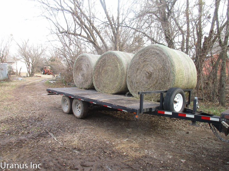

To this........................
The trailer is probably 10-12yrs out from the rebuild at the time of this pic, maybe longer.
We always powerwash it when we get home from the sale barn.
You might note that the floor is 3/4" thick wood. The strength comes from the expanded metal underlay.
