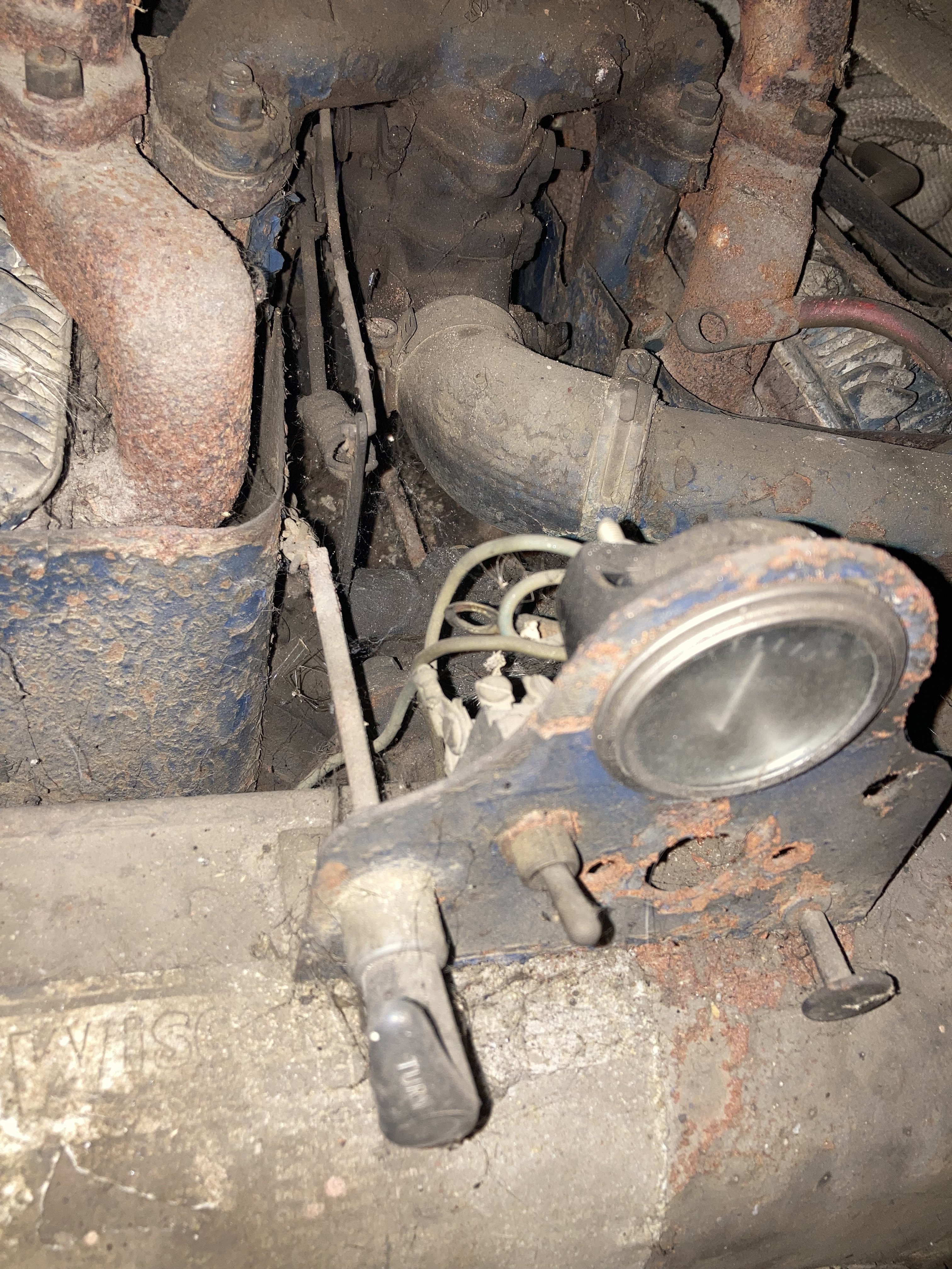

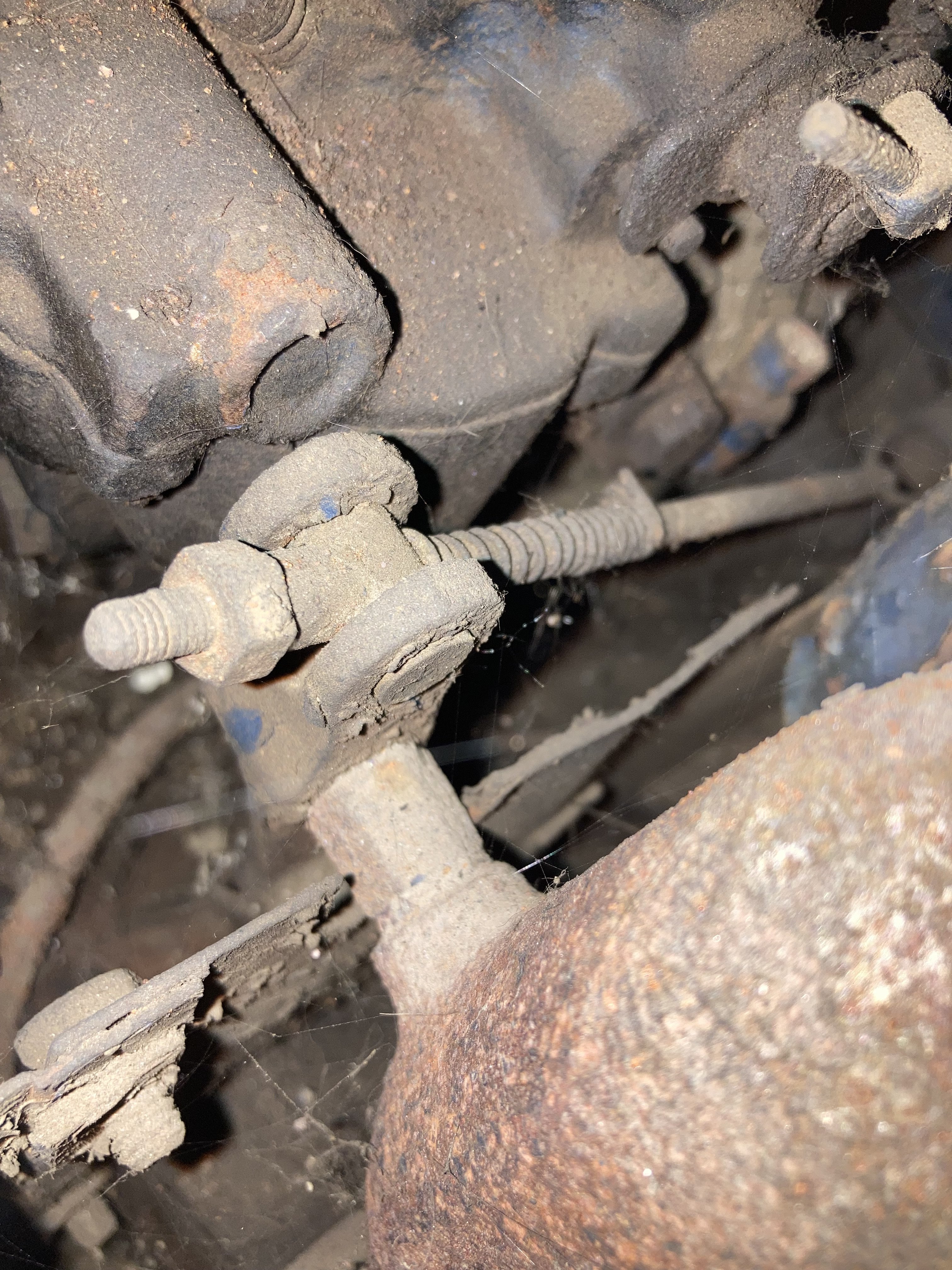

Anybody got a pic of the throttle,carb,govenor linkage how it should be? My motor runs but has no linkage and I cant find anything online. Thanks guys!
If it is like the other models, the hand throttle linkage goes to the spring which is on the lever coming out of the governor& has the link to the throttle on the carb.
The T-handle throttle control pulls a chain leading to a bellcrank that is past the carburetor. The rod, spring and nut seen at the top of the bellcrank goes forward past the carburetor again, hooked to the governor spring which is in turn hooked in one of the many holes in the governor arm. Lastly, at the top of the governor arm attaches the link between the governor and the carburetor.
Engine shown is not VG4D so the bellcrank may not be mounted on the exhaust manifold, but the basic layout is the same.
Here is what is in the Wisconsin VG4D Instruction Book. 259 goes to the Carb. 183 rod and 187 controls Gover. speed
The Linkage to the Carb and the Carb. maybe what ever the company that the engine was installed is in wanted to use
