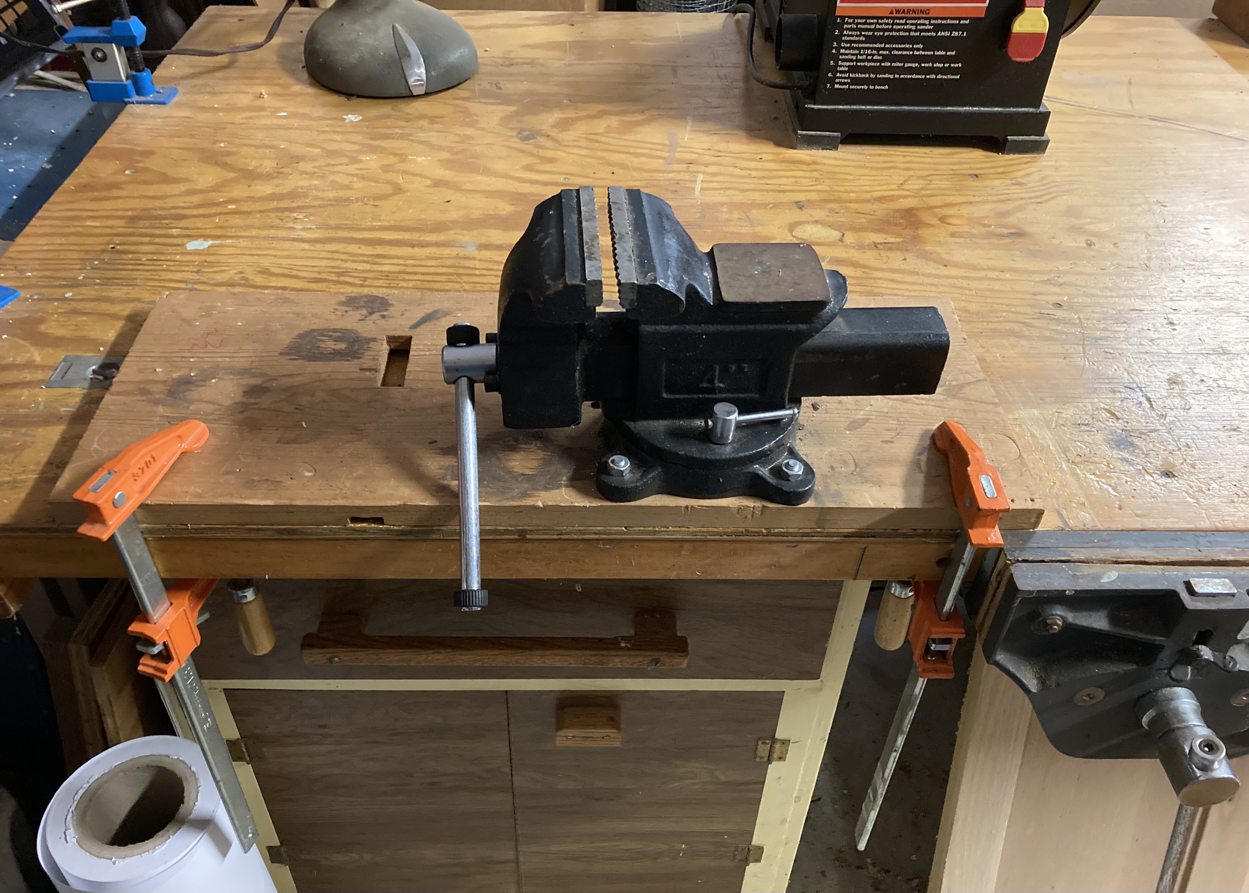

I bolted mine to a short board, recessed the nuts so it sits flat on the bench and use a couple of short bar clamps to hold it to the bench. Works well for me, and you can take it with you for remote work. I did my bench grinder the same way.

My setup. Nice to be able to clear the bench for big stuff.
