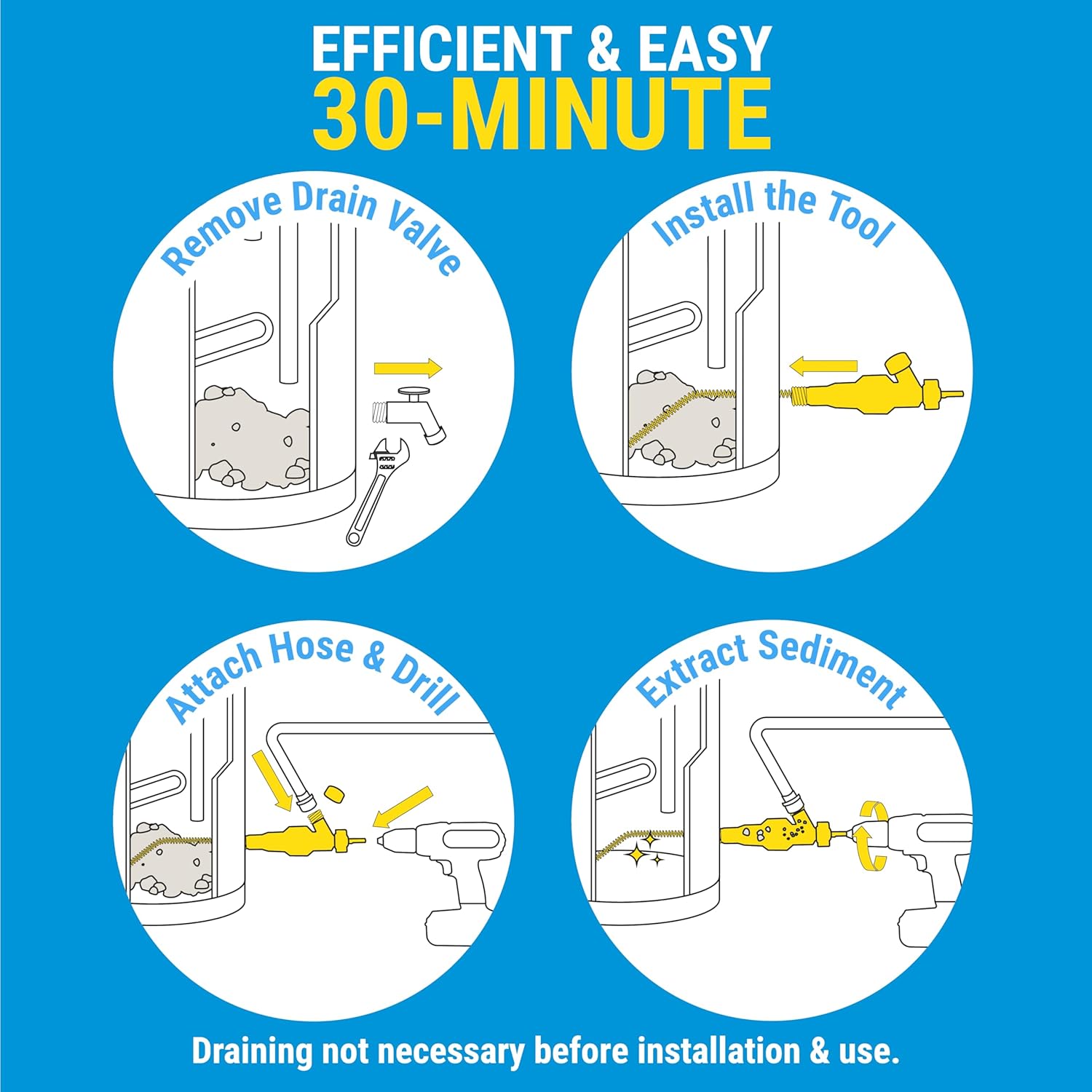

This tool does works well, however next time I will take the tank outside to clean it.
I will connect a
garden hose to the cold water in, cap off the hot water out and leave the mess outside.
Down side you have to remove the drain valve so taking the tank outside is the best option.

This tool works better than I expected.
The lime in my water heater won't come out by flushing the water. This tool turns the lime into power and out it goes.

YEA, how does it work? I've never heard of it.
It screws into the drain opening after the drain valve is removed. An electric drill is attached to the short end, the rod on the long end beats the solid sediment off the bottom of the tank.. That's the explanation on:

Link to video.
Does it permanently replace the drain valve?
I removed a plastic drain valve, used the tool and replaced it with a brass valve.
