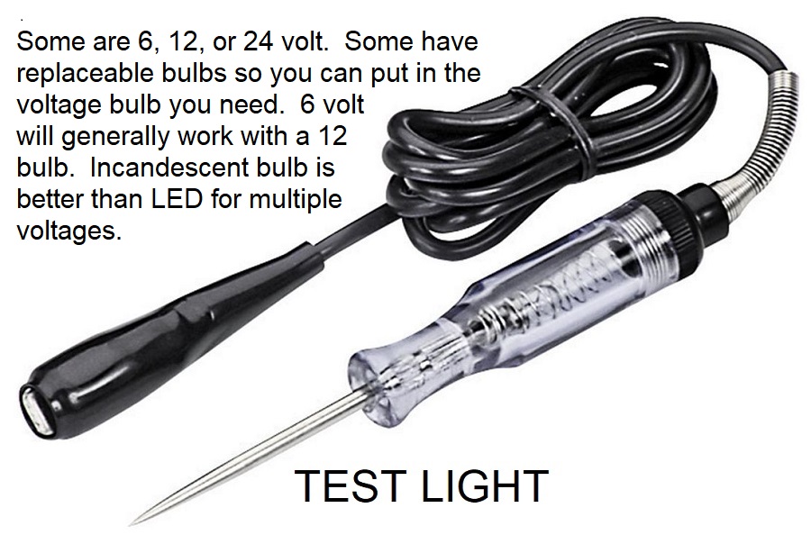

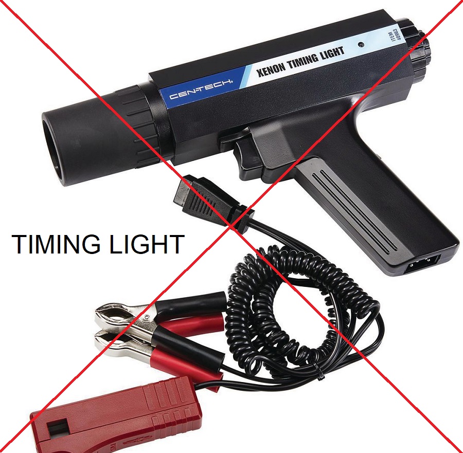

You originally posted you were using a timing light to test for spark. That is testing on the high side of the coil, to do that you need to connect it to the coil wire or a plug wire. I suggested using a test light on the primary side of the coil, the small terminal the wire that goes into the distributor body, then the points, hooks to. No where until you posted this did you say you were testing as I described. They are two different methods, which did you actually do?

TEST LIGHT, NOT TIMING LIGHT!!

Did you ever try reading the “ignition on” voltage on the coil terminal with the lead from the distributor with both the points closed and open? This would have probably told you a lot and possibly given a clue to your problem. The test light on that circuit while cranking would be the down and dirty version of this test. Inconsistent spark from the secondary requires verifying the function of the primary system first, in a trust worthy Kettering troubleshooting tree.

I apologize for not understanding you were using a test light, not a timing light, from the way I read your posts.
