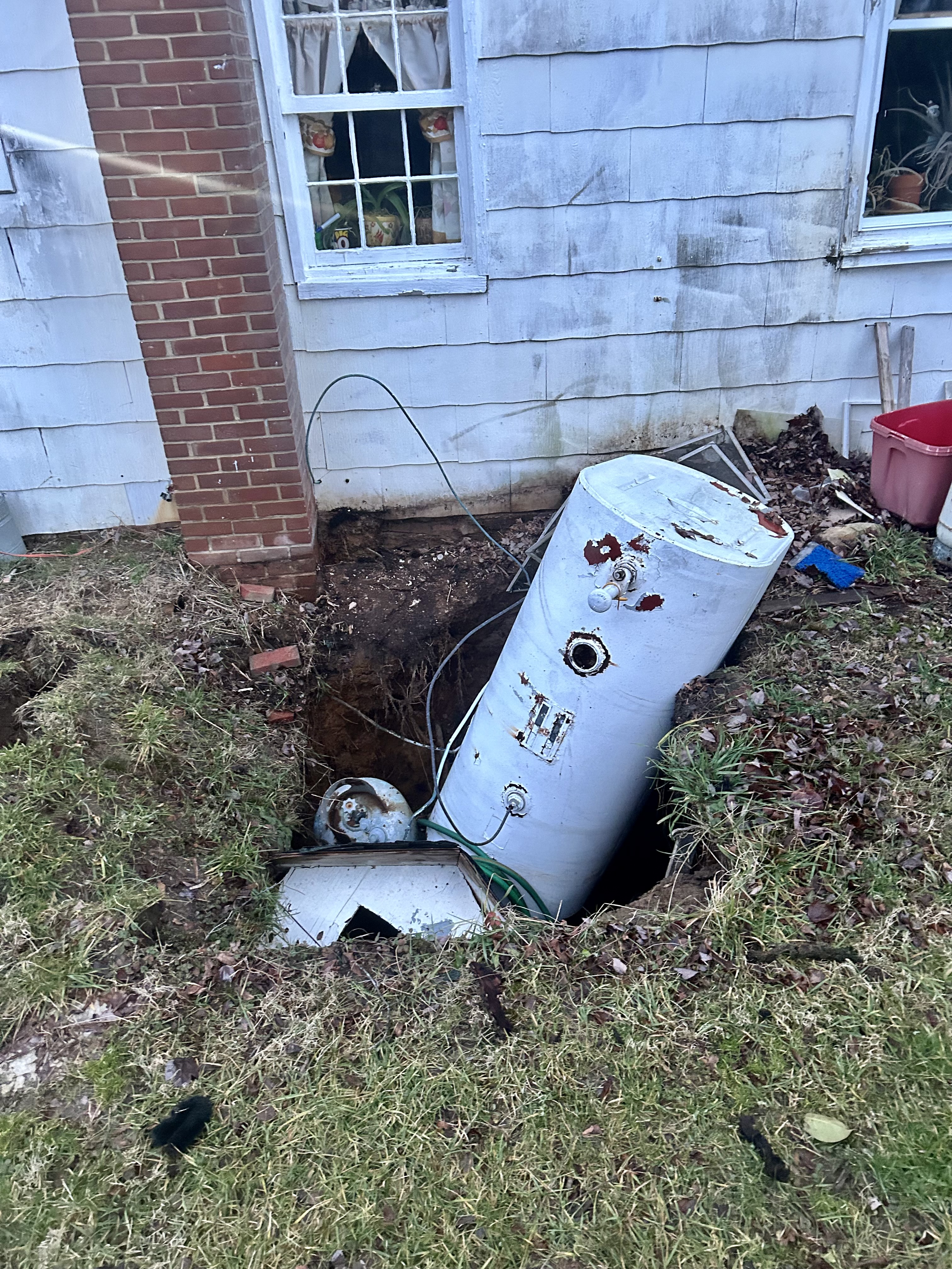

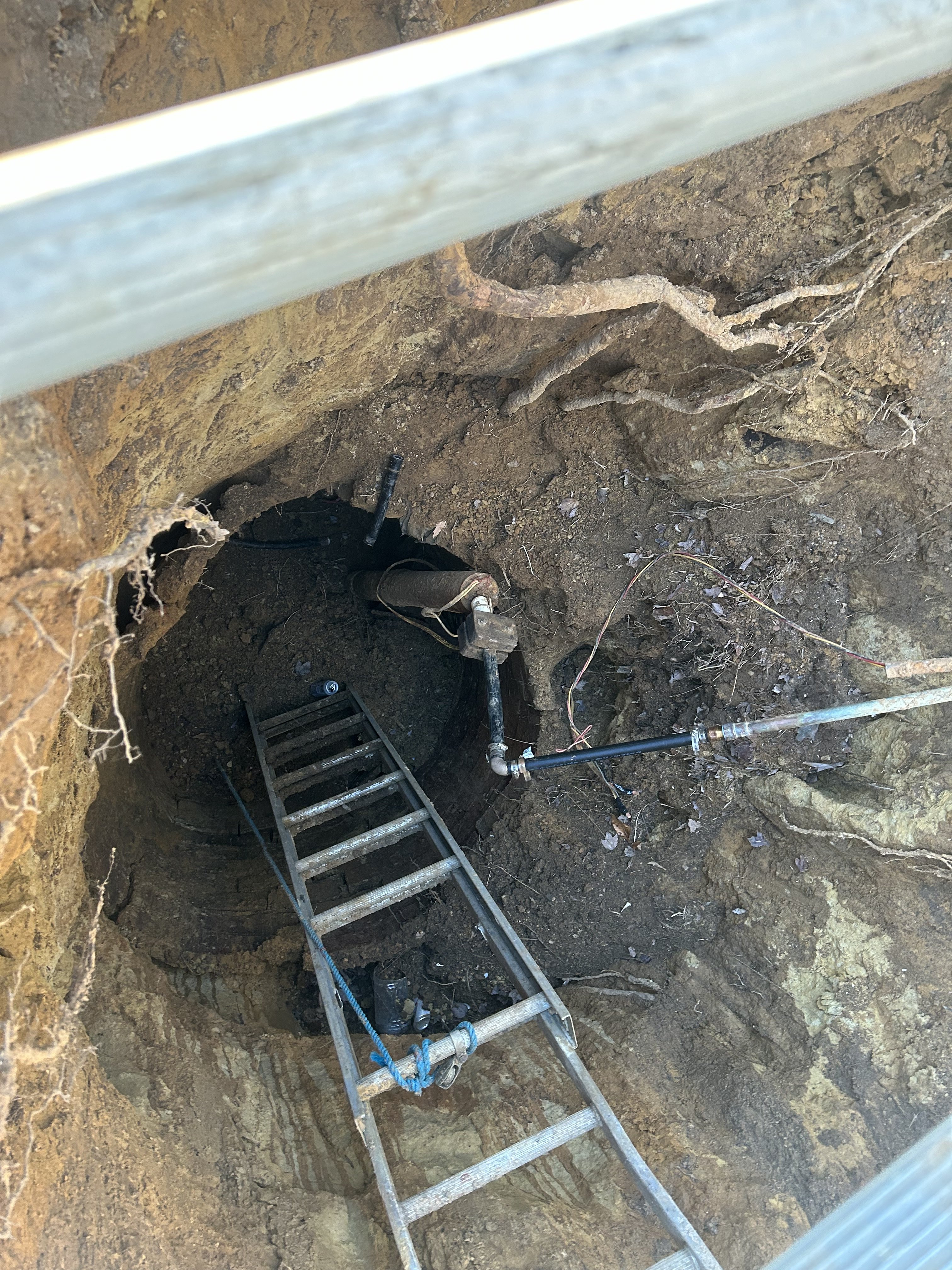

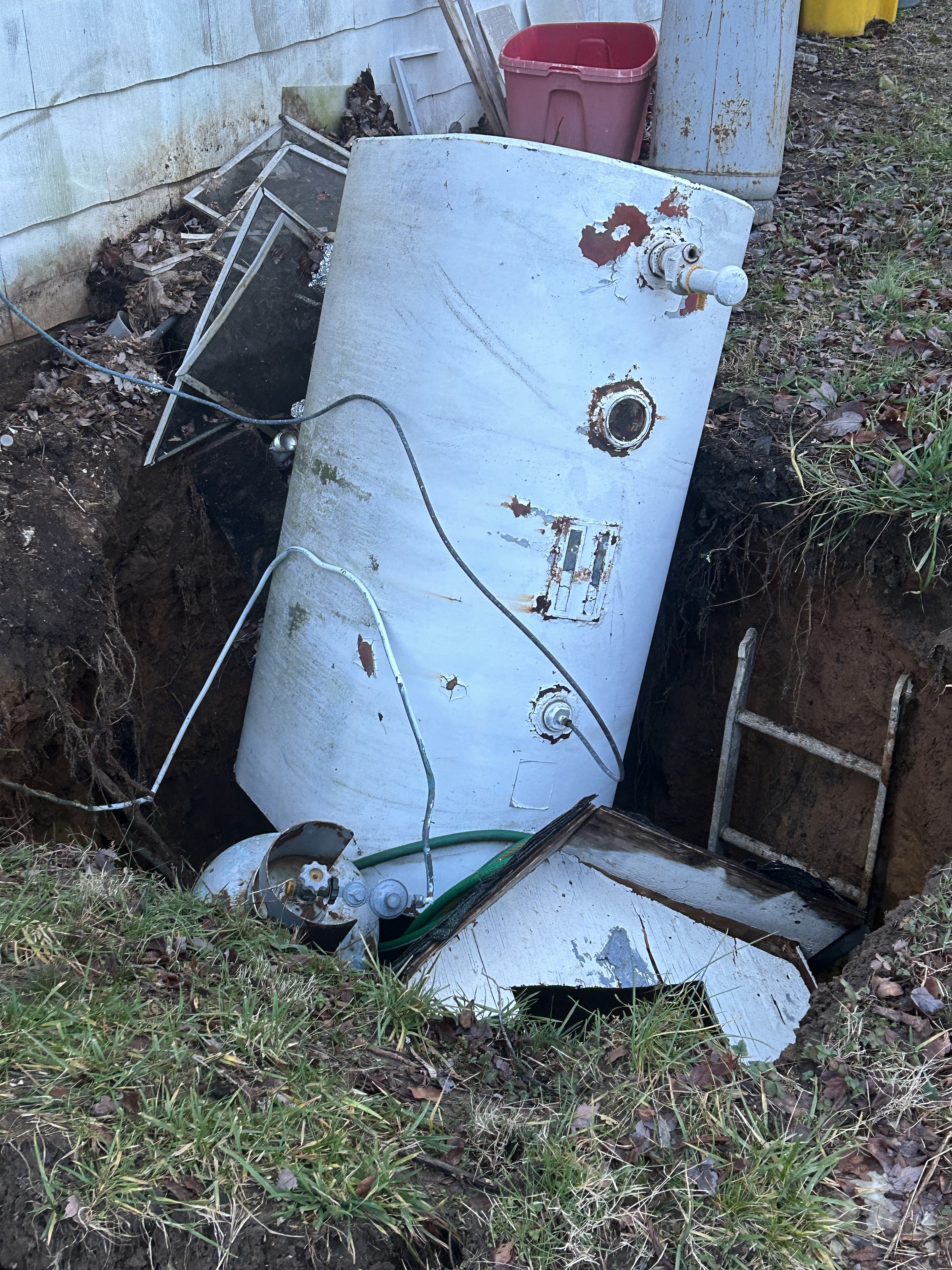

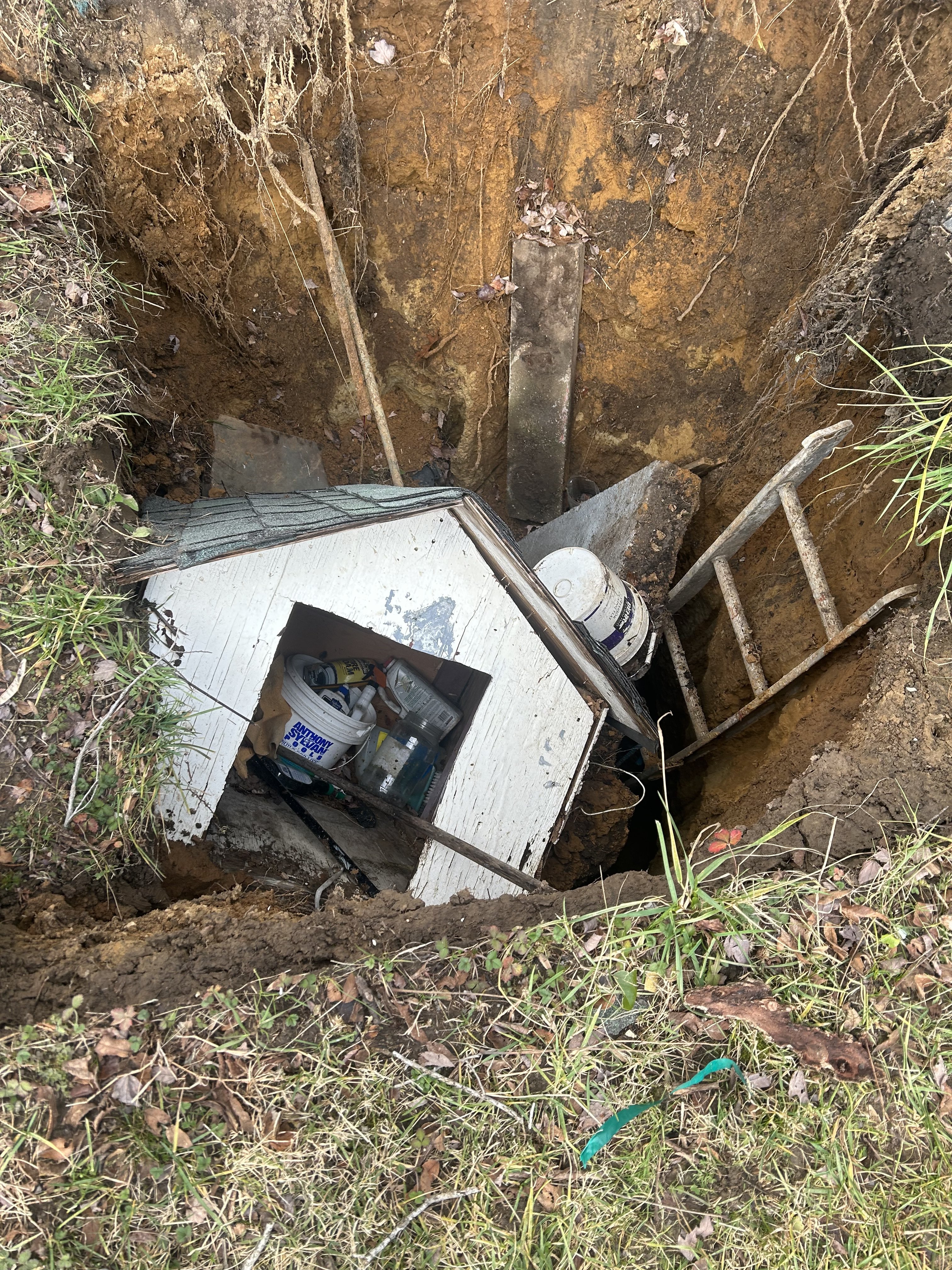

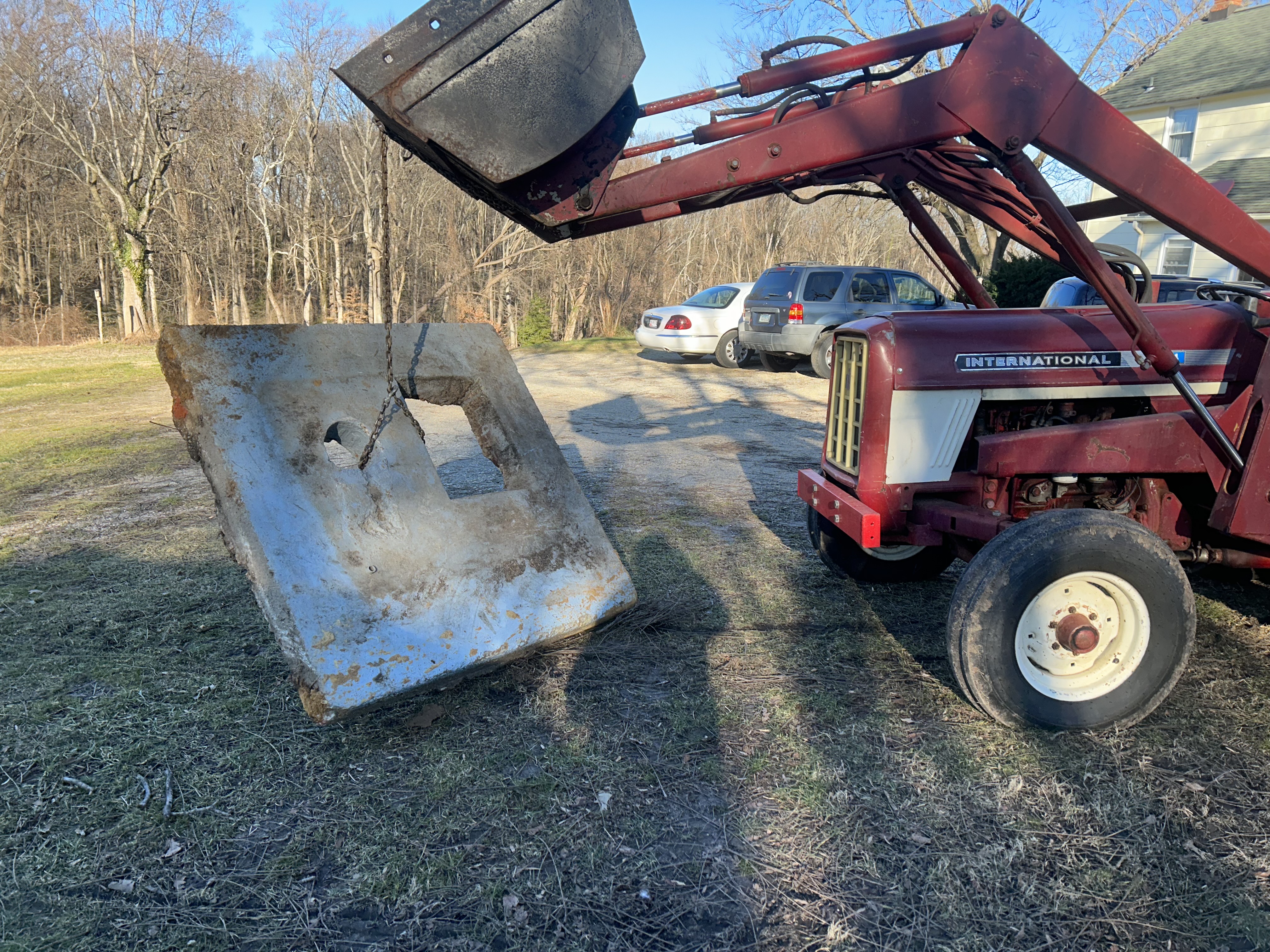

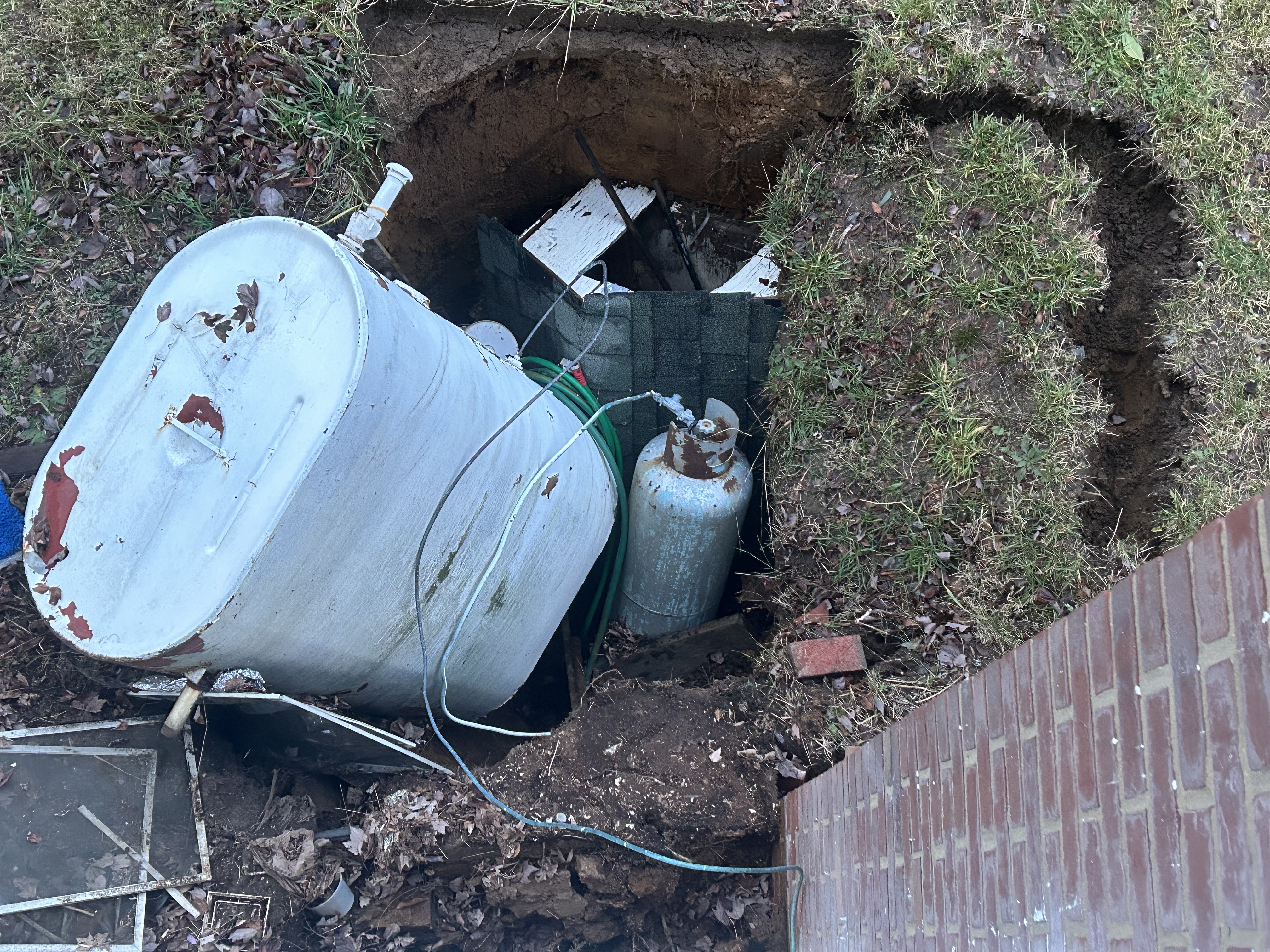

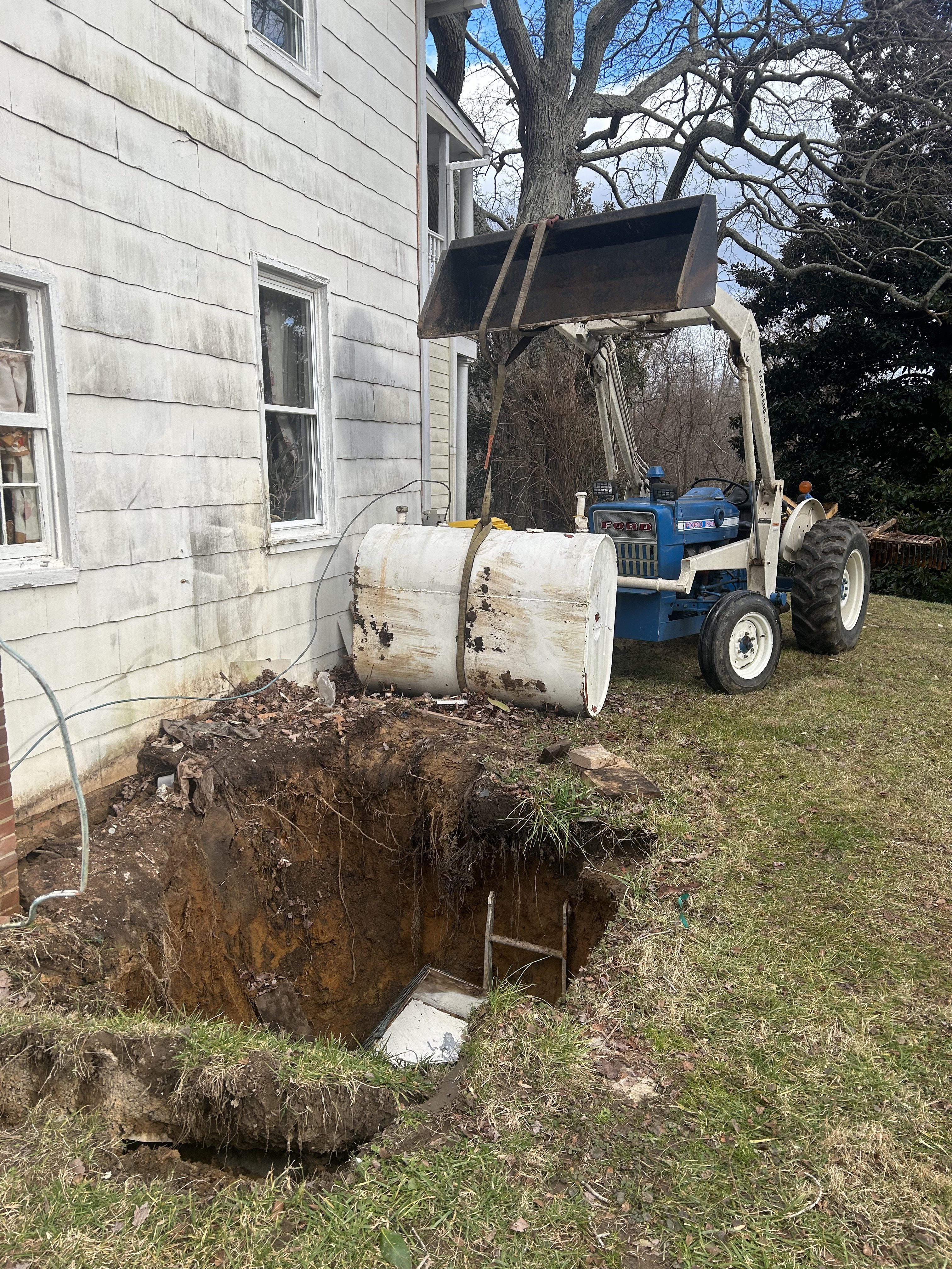

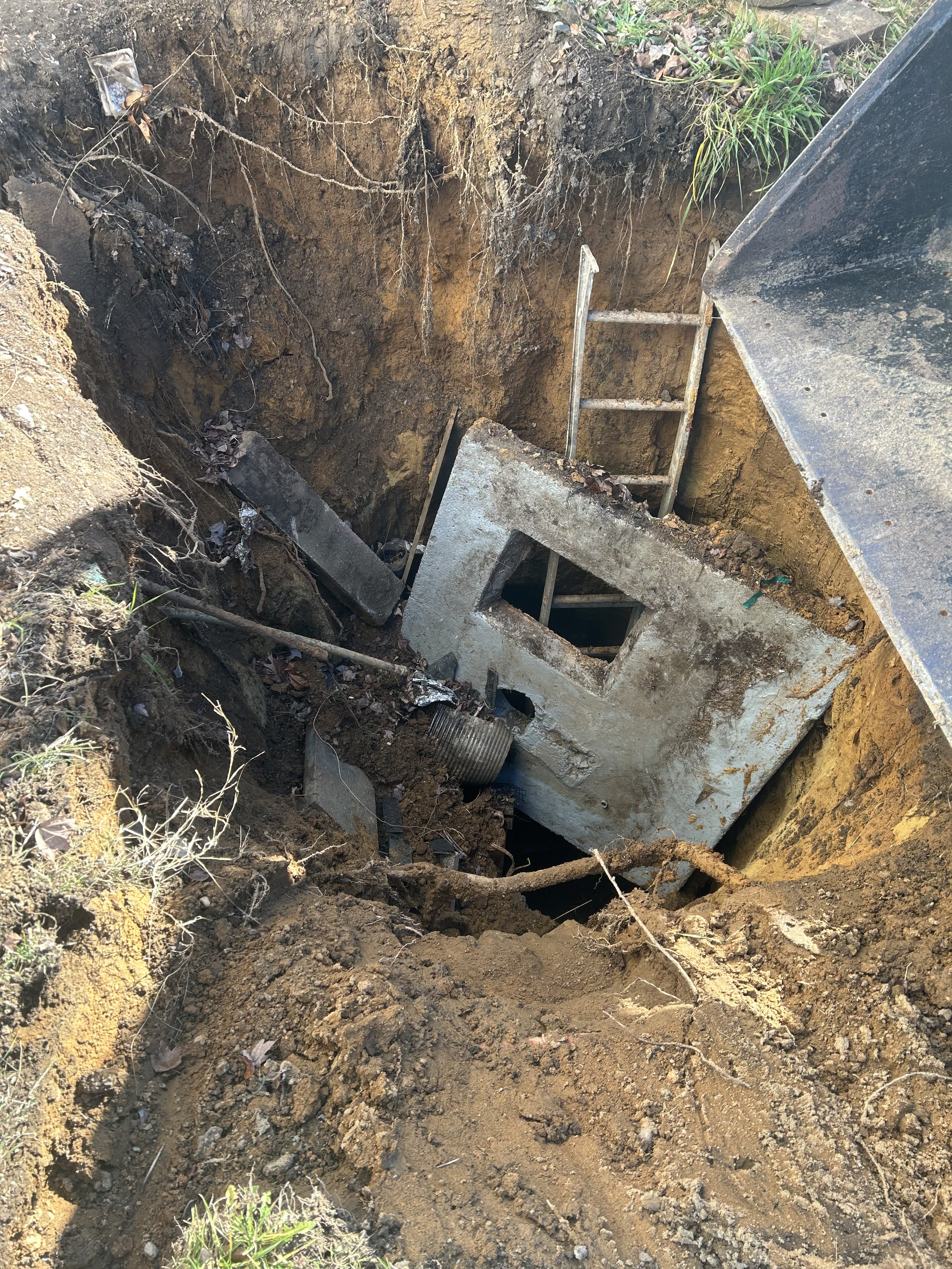

We have a dugwell that ran dry before I was born. A deeper well was drilled in the bottom and the whole thing was capped with a concrete slab. With constant rain lately the slab fell in taking an oil tank and a doghouse down with it. We fished all the stuff out and reset the tank and got the heat on yesterday. Today we got the slab out and reconnected the water. The 574 was a life saver Now i have to figure out how to fix the huge hole in the yard. It may be time for a new well.

If the well has good water in it all you really need to do is extend the casing up to ground level. Then back fill the hole with gravel/dirt while compacting it as you fill it. If the pressure tank and other stuff where in the old well pit then you will need to move them inside if you have abasement. If not just build a well house on top of the well at ground level. Insulate it and install an electric heater for winter. I have several wells with above ground well houses. They are about six foot square and four foot tall. That is all the bigger they need to be.

Sorry, not in an area where fuel oil is used for heat or I assume that is what the “oil tank” was for. Was there fuel oil in it? Did that leak and contaminate the well? To do what Ex Deere is saying if that is a working well you want to use you will need a submersible pump.
The tank is for the oil furnace. It fell with the vent up and was only about a quarter full so very little spilled. That was lucky;

The main problem is they only bricked the well up to about ten feet below grade. The cap for the drilled well is also that deep. i will still have to provide access to the well cap for service. The drilled well is one hundred feet below the bottom of the dug well and has a submersible pump
Extend the casing to the surface, install pitless adapter and cap and backfill the hole compacting every couple inches of fill. Look as "h2o mechanic" on youtube for a lot of goo well info. No reason to drill a new well if the existing one is otherwise fine.

You can get a fernco rubber connector to fit the well casing to extend it. Clean the casing as best you can and maybe use a sealer to prevent ground water intrusion.

Around my place I am trying to eliminate/reduce any possible headaches in the future while I am still in good health. You need to do as ExDeere Farmer suggested as add pipe to bring it to the surface, and as wp6529 suggested install a pitless adapter so that there is no longer any need for a hole, because you will perform any maintenance needed from the top.
You said very little oil spilled. My first priority would be to get every last bit of spill-contaminated soil out of the hole, then have a well company come out and extend the casing and lines to the surface like wp6529 suggests. Then backfill with compaction, and bentonite to seal out any other surface water. Where the heck is the chimney footing? Must be down near the bottom of the well hole or it would have added itself to the pile. Basement under the house? steve
There is a crude basement containing the furnace and water equipment. The chimney is a huge concern. The well guy said that he could extent the casement, but at over 70 years of service it was a gamble .Getting the pump up was very tight last time due to the rust. I would like to move it farther from the house too. So... I built a deck and tarped it over and ordered a new well.

What an event! I bet that slab was heavy.

Extend casing, do not remove pump from well, only lift it enough to redo the top end of pipe for the pitless adapter. Keep existing well working and save up to eventually drill a new one in a better location

The question is. Where did the dirt go in order for it to collapse? There is a underlying problem that needs to be addressed.
