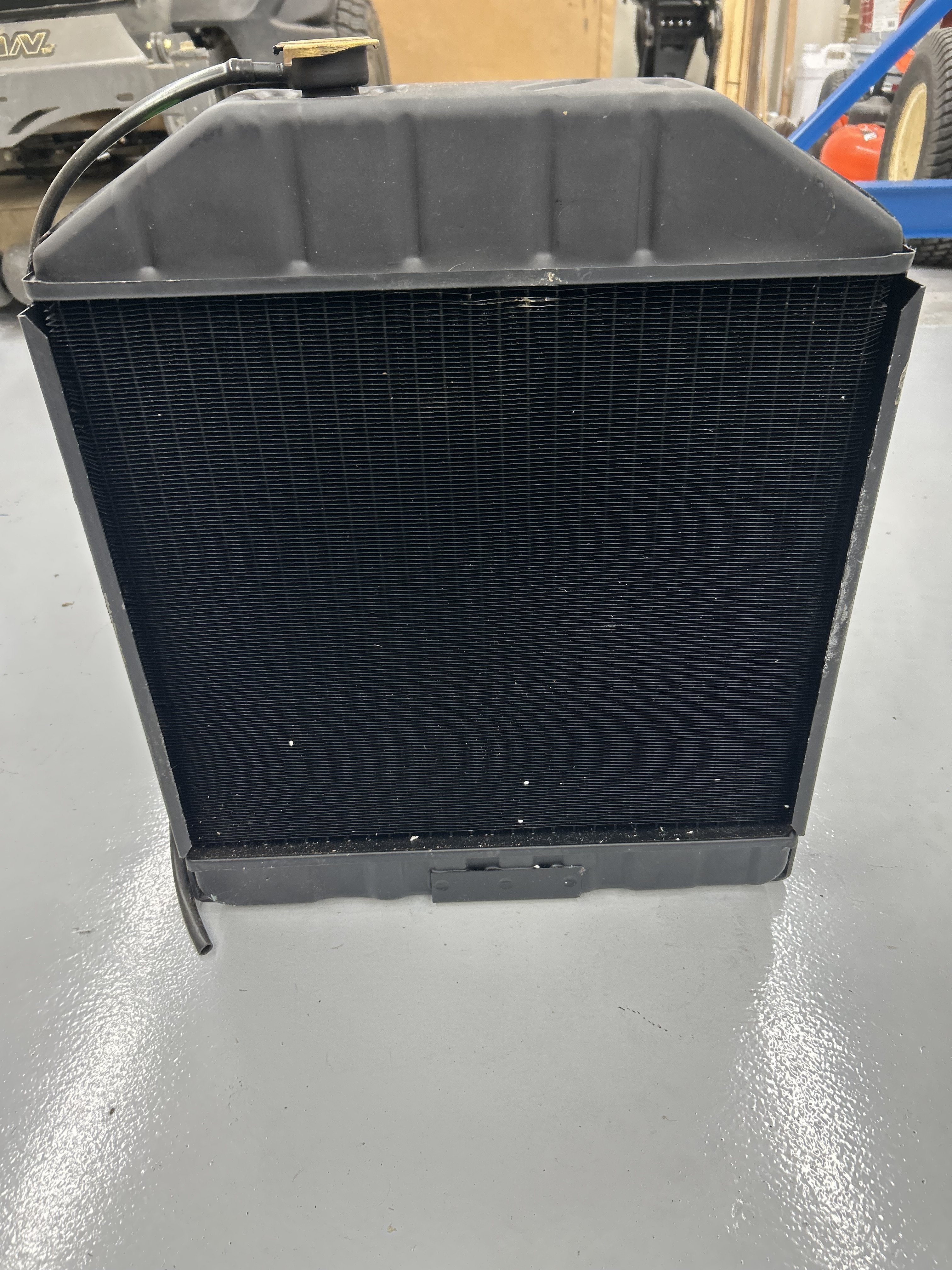

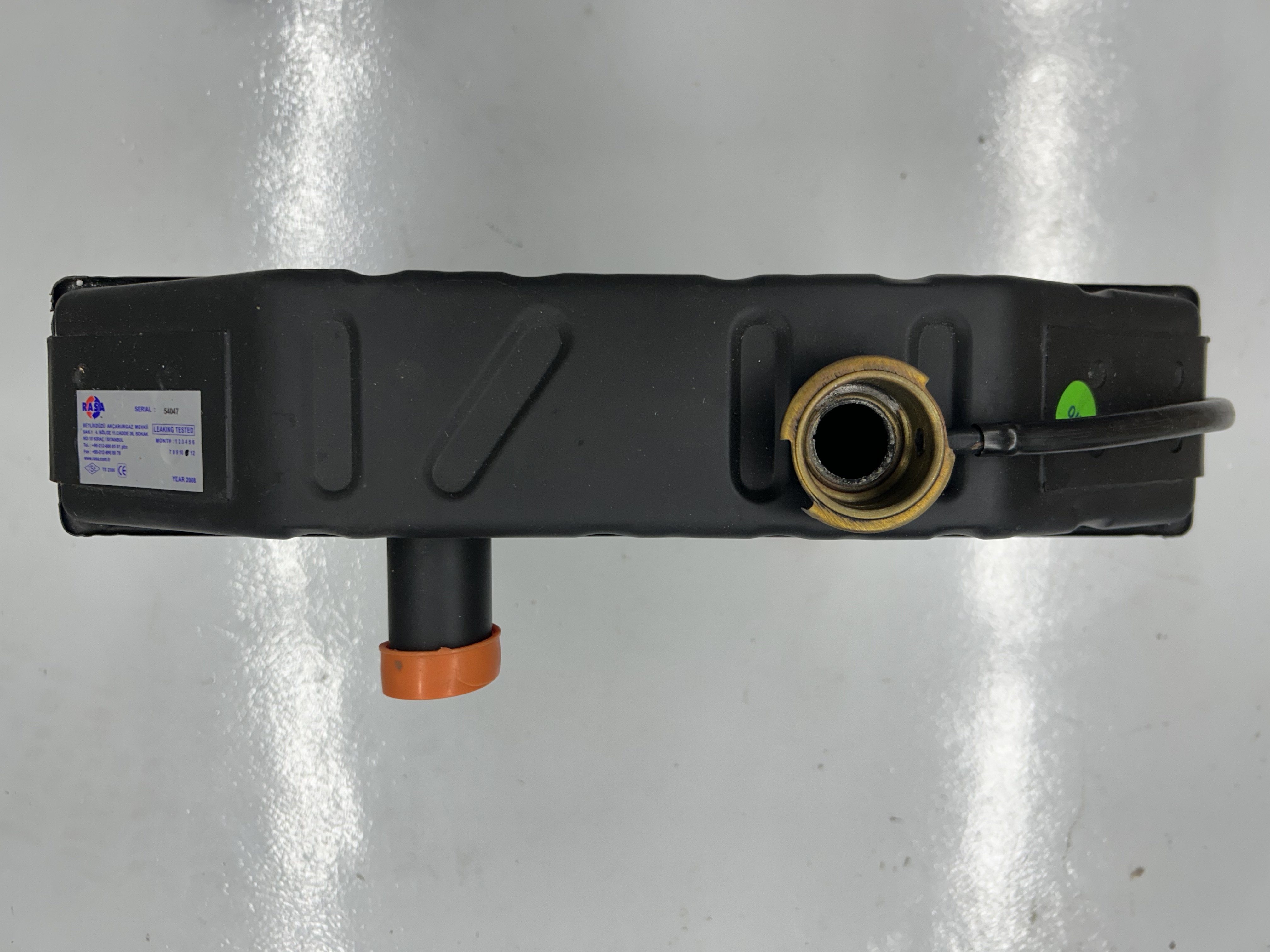

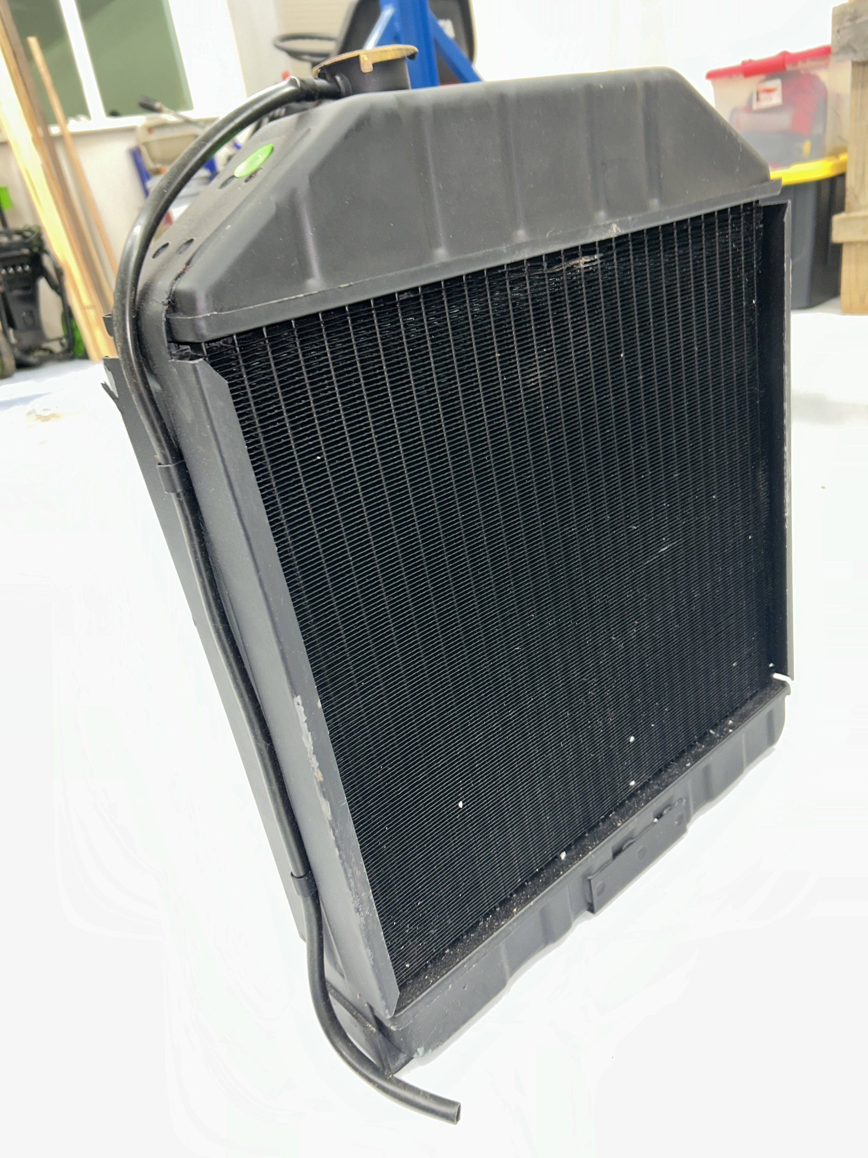

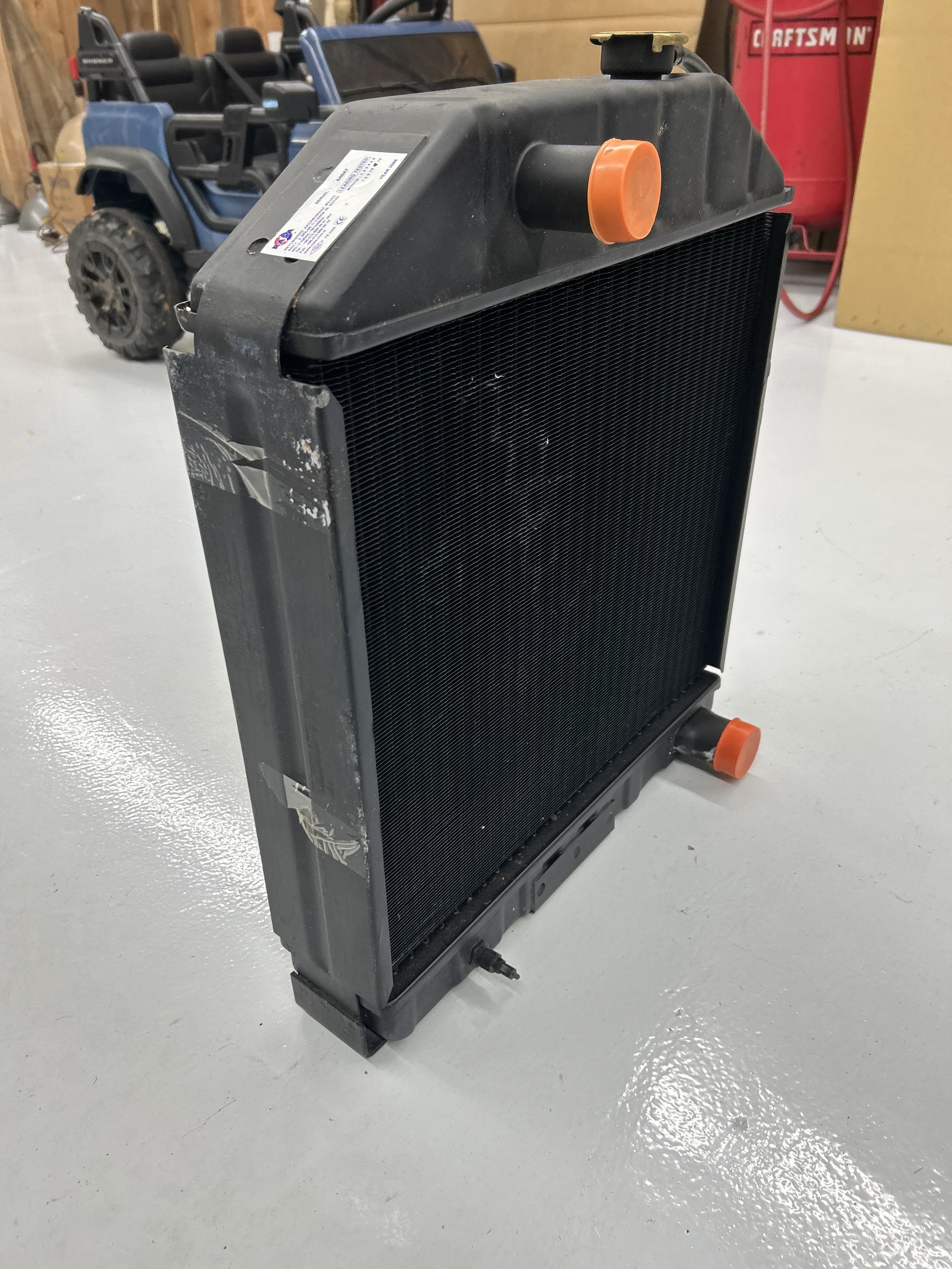

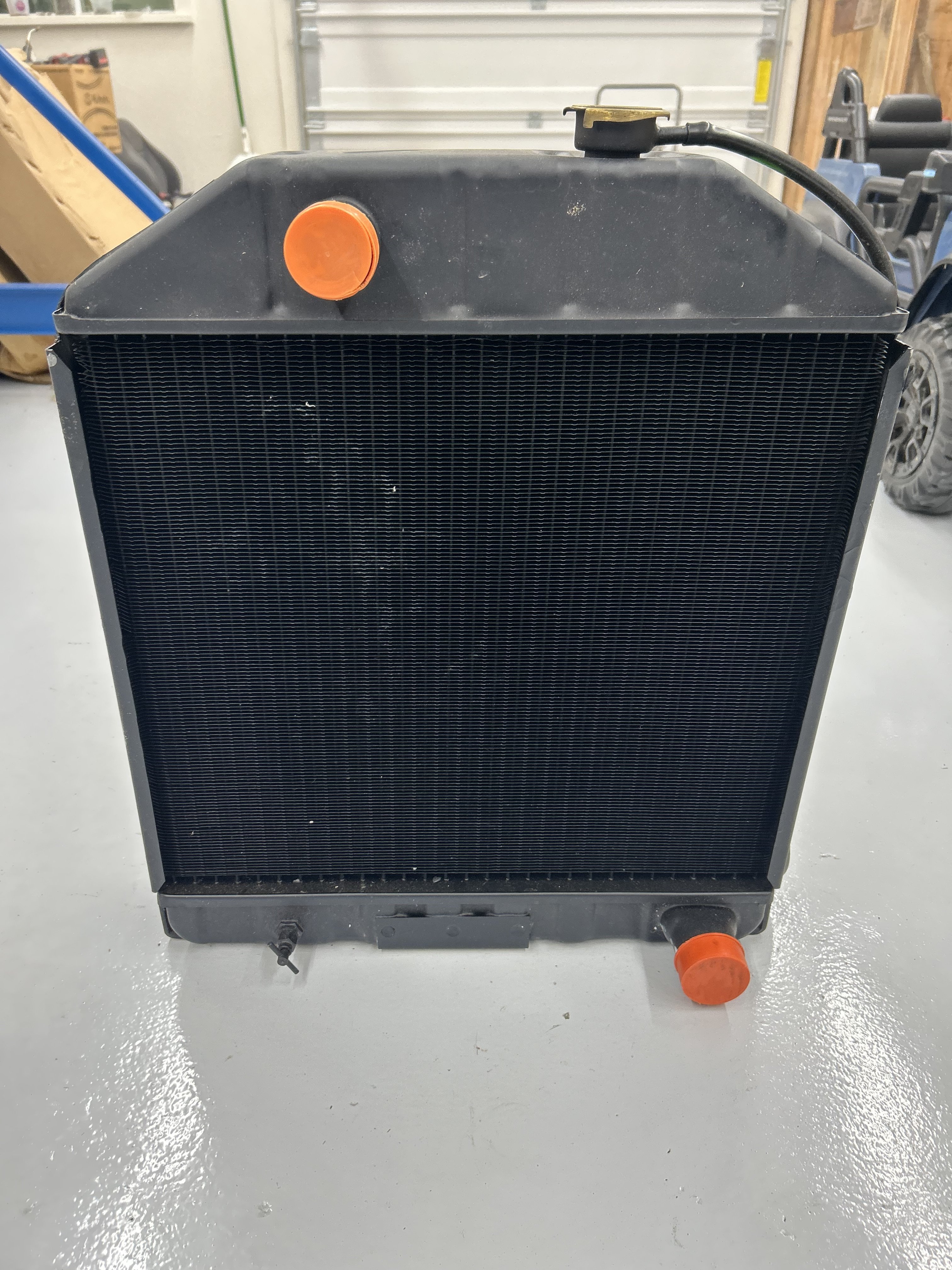

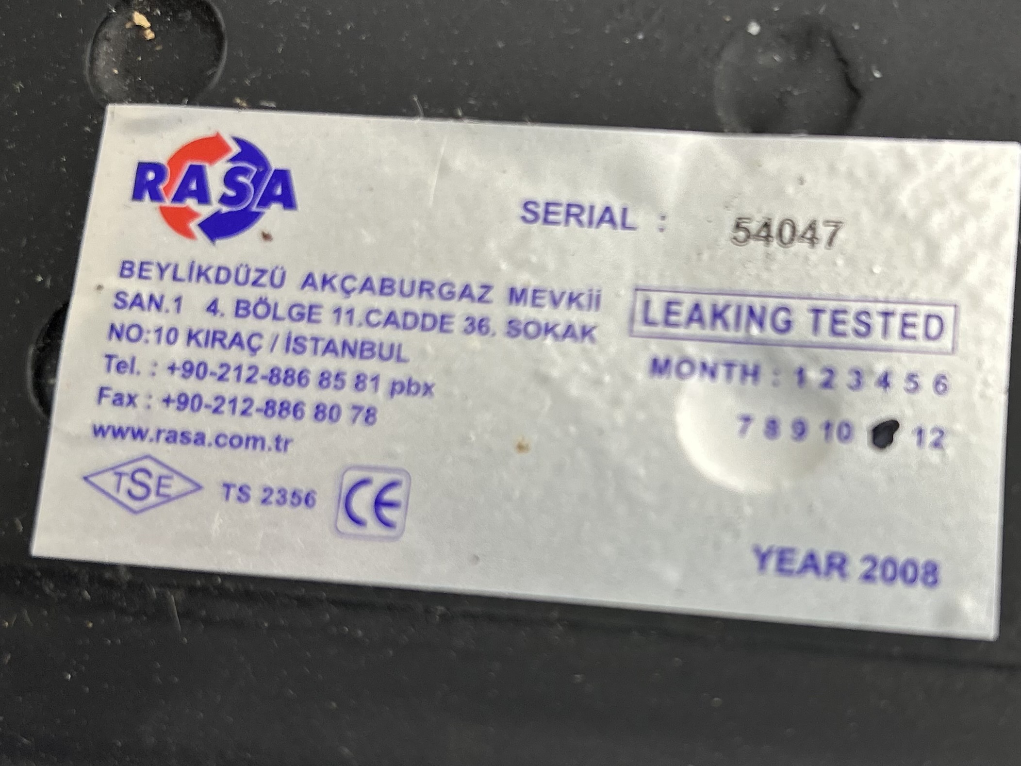

Does this radiator fit a Ford Tractor? I have found some similar but not exact. bought this NOS from a closed tractor shop and The box had gotten wet and part number was smudged off. Any ideas?
I measured the CORE and it is 18-1/8” wide , 16” tall and 3” thick
Contacted the company on the tag shown and they didn’t have a way to cross the number on the tag.
It looks a lot like one for an NAA or hundred series, but without measuring them, I couldn't say for sure.
Inlet and outlet locations are just as important as core dimensions.
Look up one for an NAA or other model on this site..they might give dimensions in the description.
The radiator for the NAA and hundred series is different. It has a center mounted neck and a rounded top tank with a long outlet pipe. I had (2) of those and just sold those. This one I haven't figured out. I'm thinking thousand series Ford but trying to figure out which models exactly
Yep, definitely not for a pre-'65 model, after looking at one I have in the garage.
