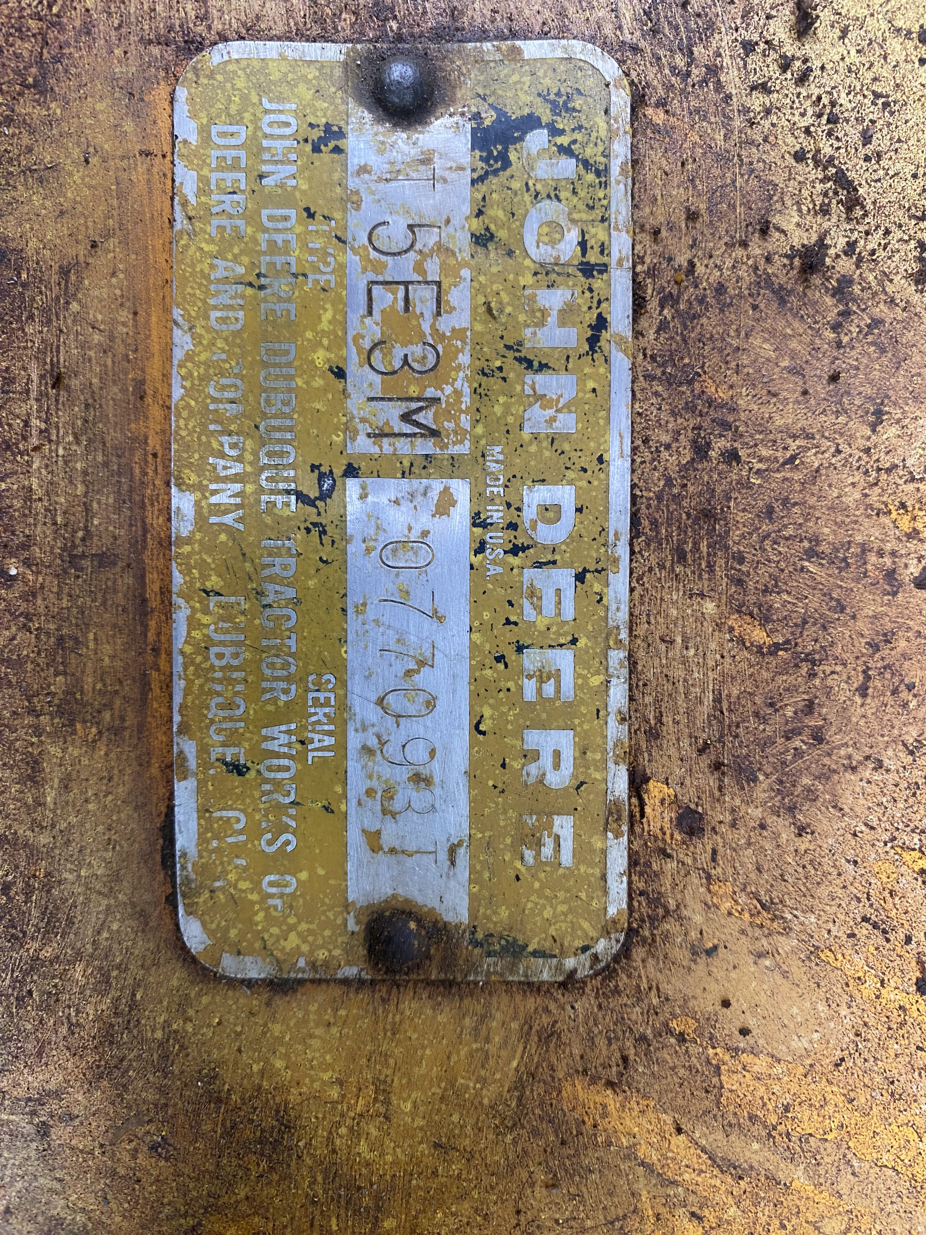

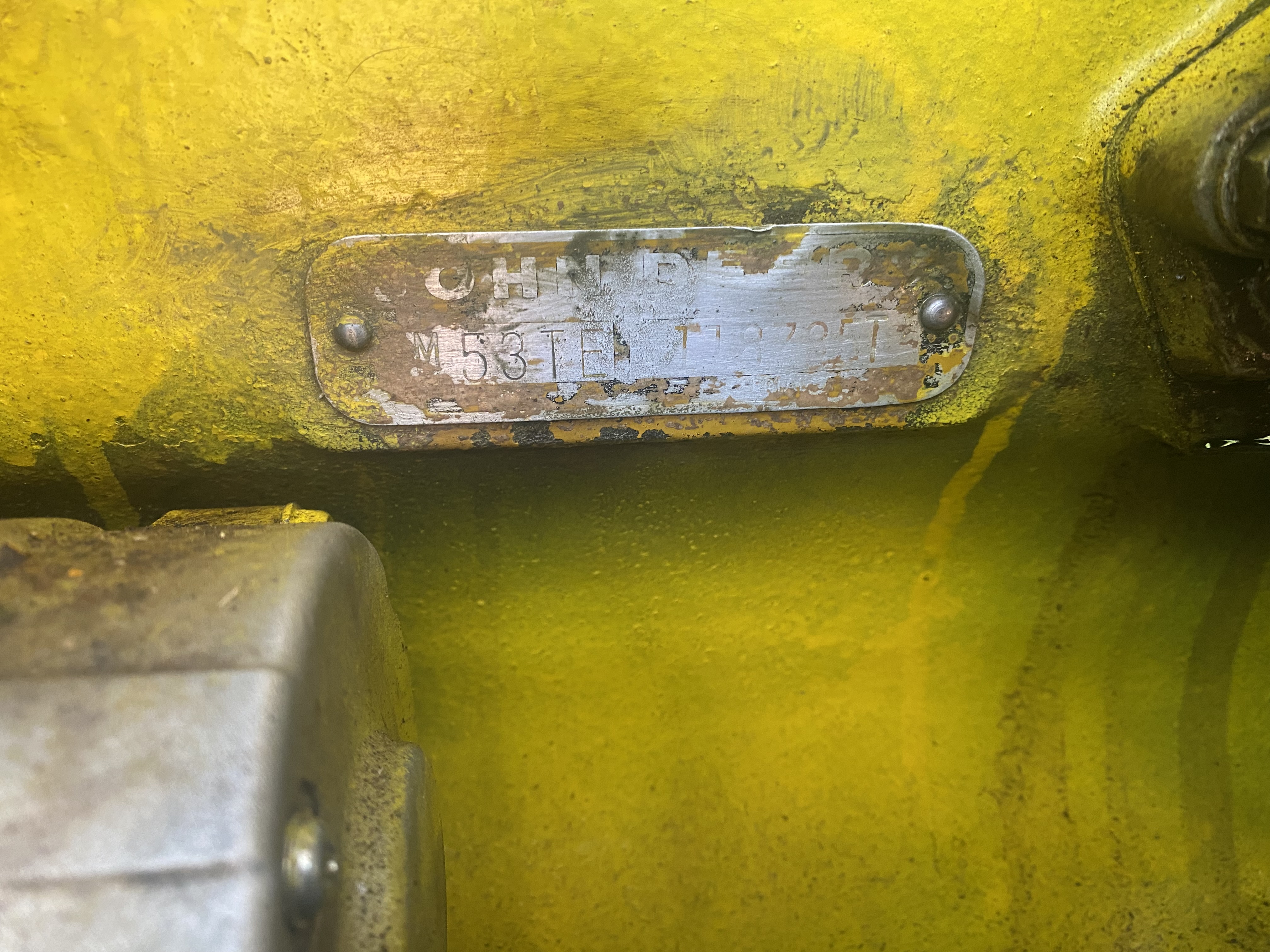

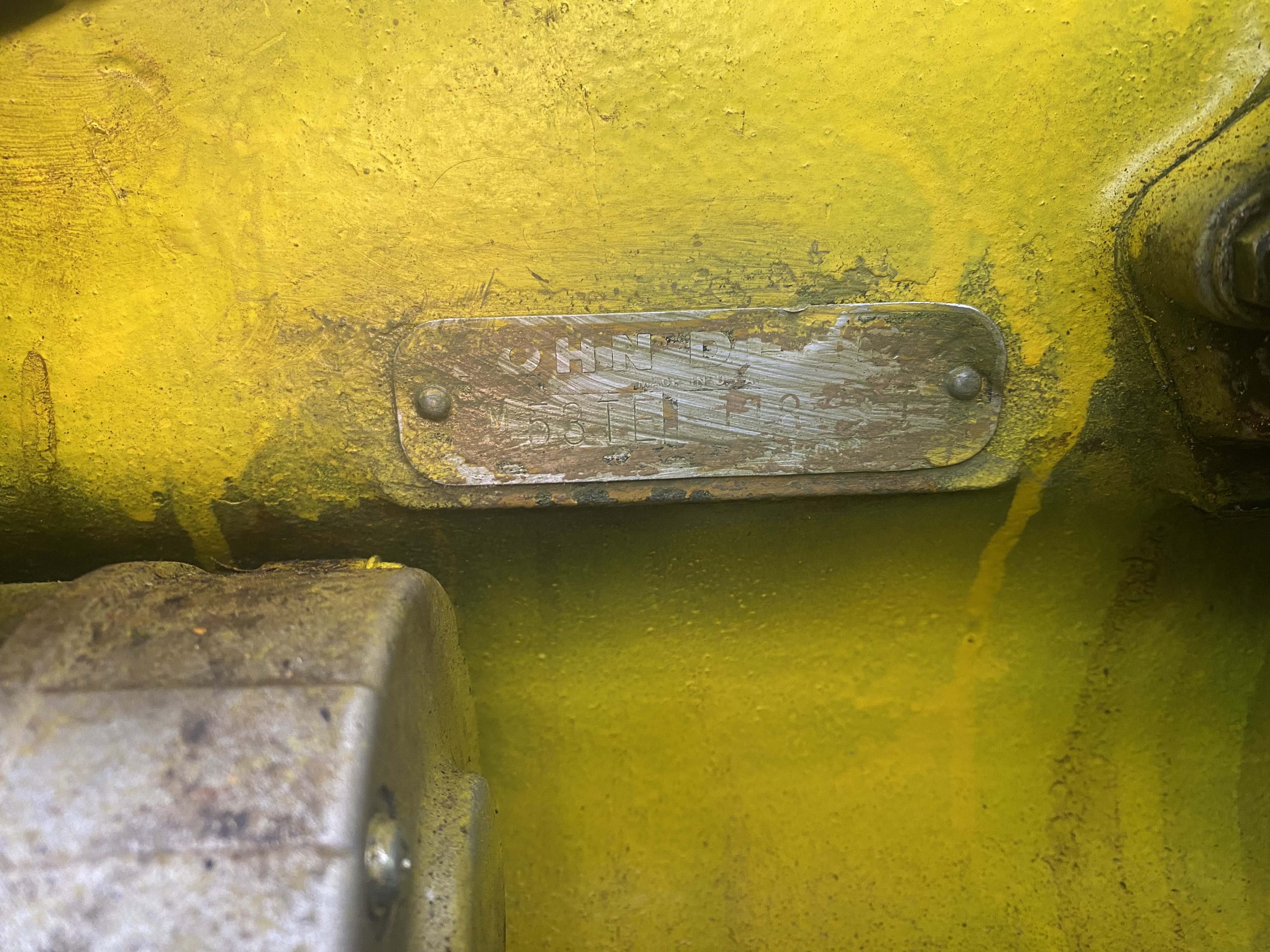

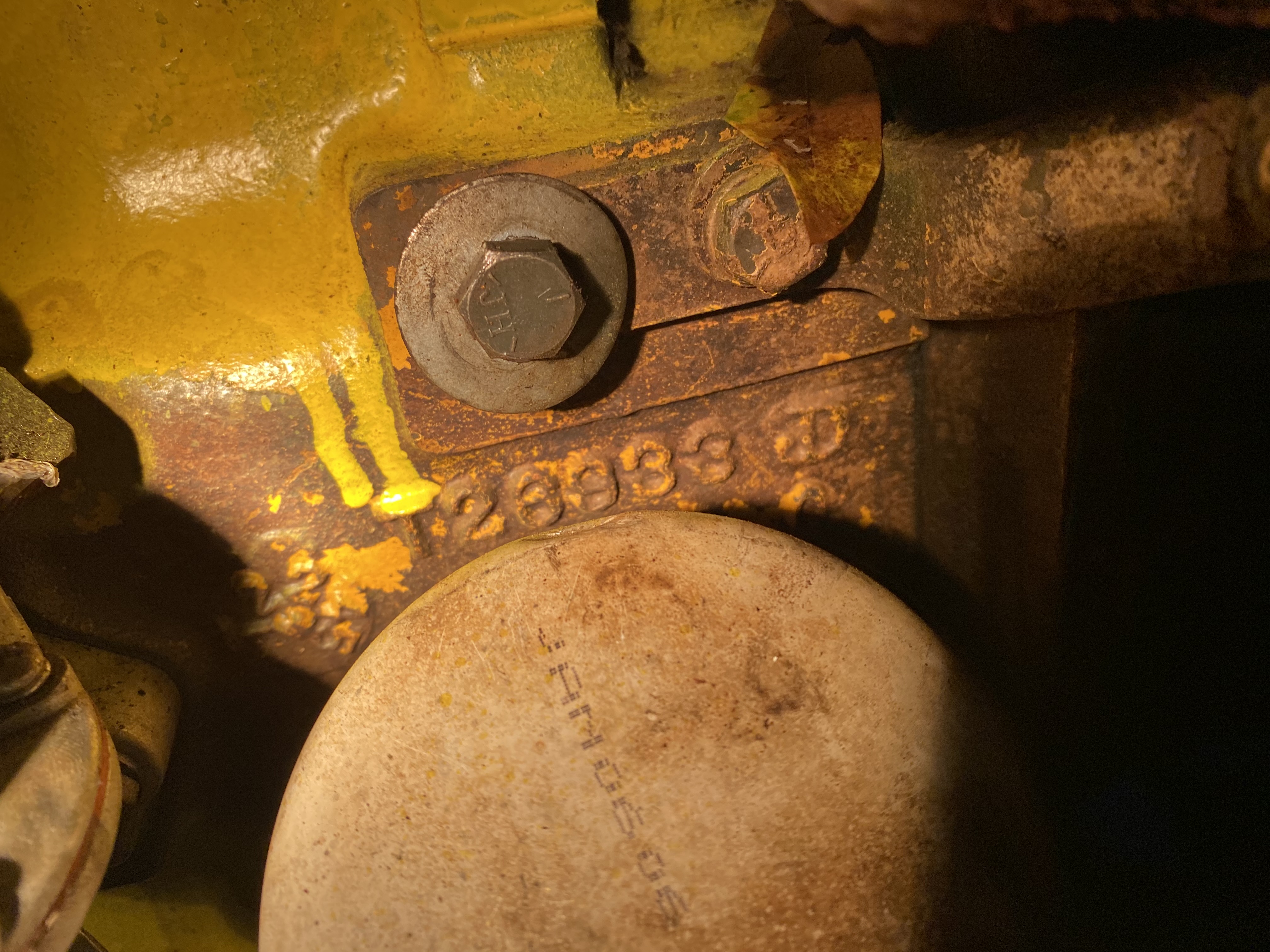

I had a ton of help a few weeks ago with my 450 loader and determined from my serial number it is a 1968 450 straight. Now I am trying to determine which engine I have. I will post pictures of the serial and the casting on the block and a tag beside the castings.
I have read it has the 4.202 but want to verify. I need to purchase some rod cap bearings and want to get the correct ones. Are the 4.219 and 4.202 rod cap bearings interchangeable?
Thanks for any help!

On the engine tag:
5 = 4 cylinder
3 = diesel
T = Dubuque (using factory))
The "E" likely indicates it was used in a crawler loader.
The six digits are the actual serial number of that engine (There is no publicly available list that relates engine number to year, to my knowledge).
The T at the end means it was built in the Dubuque Factory
This is the format of a 4 cylinder 202 cid diesel engine serial number, I will say you have a 202. The correct printing of the service manual (SM2064) for your 450 should have this info in it. Unfortunately, the later printings may have the engine serial number formats for the next generation engines (219 cid).

Based on the engine serial number you posted you have a 4.202 diesel engine.
