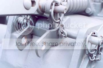

Among other things as you can see attached to this posting, you use this Hinged pin for the Draw-bar stays and 11 hole draw-bar that come with the tractor when new. But it is used for many things that need a firm attachment to the tractor, the Top Link attachment should not be used, that is only for anything that uses Draft Control or a standard 3 point linkage connection....John(UK)[email protected]
