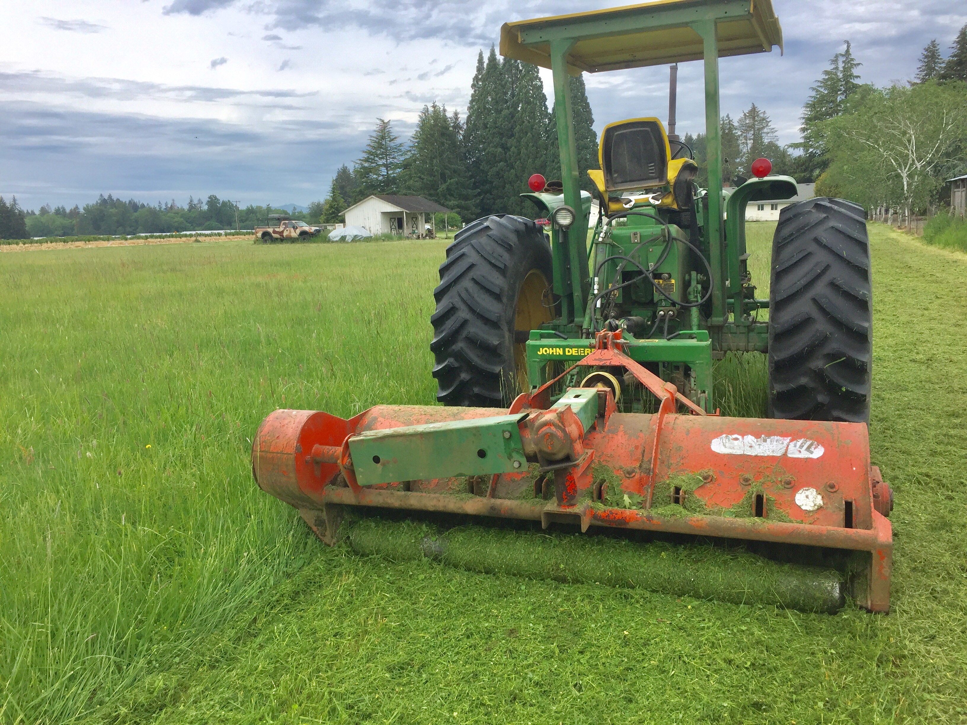

For longer grass, a flail will give the nicest cut with no grass winrows of dead grass. But, they are more expensive than a Bush Hog type mower and more easily damaged if they hit something like a rock (depending on the quality of the flail - light or heavy duty). All the road crews that mow ditches here use a flail. A finish mower is the same as a lawn mower only good if the lot is level - no scalping - and the gras is kept short.
