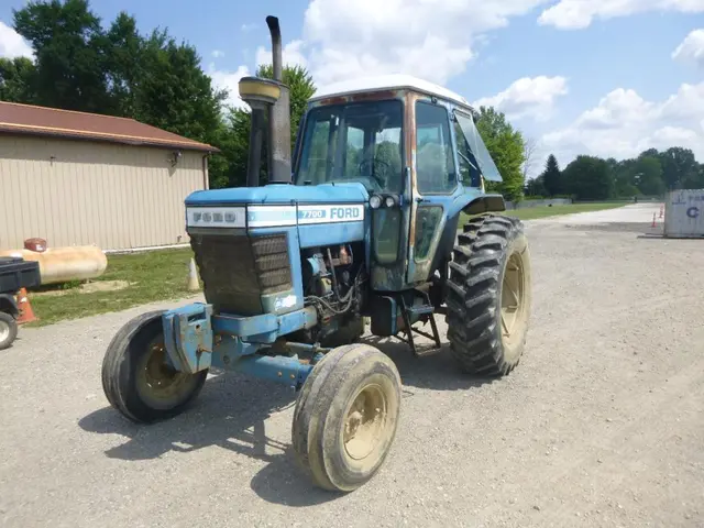

Jenn, did you mean to say ford tractor? Does it look like this:
Maybe without the cab? steve
Assuming the 0 in F0215M is really a C (FC215M) then Ford 7600 or 7700 flat deck diesel with independent 540/1000 PTO and 16X4 transmission (8X2 dual power), Sep 20 1979 day shift, 96.7 HP
