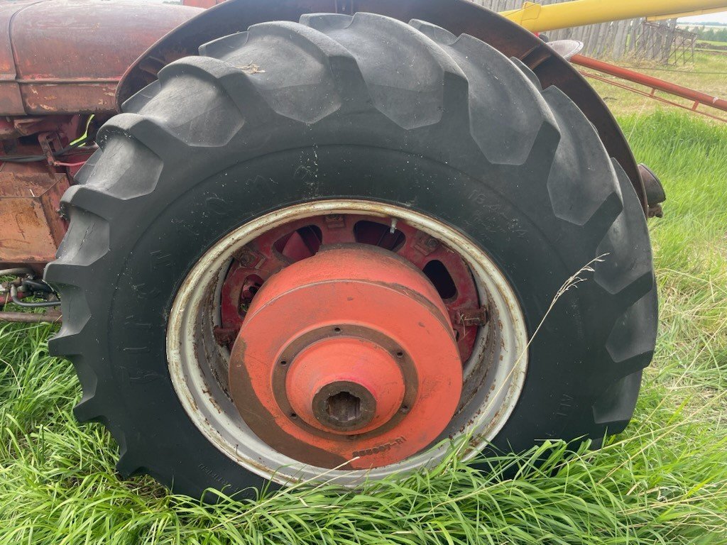

This was the “heavy option” that heavy cast center with 23.1-26 rim and tire. Not sure how that’s bolted together. And yes those are heavy. I have that setup o. A swd9 and I have another set I plan on Putting on a swdr9.
Big tires are cool😂

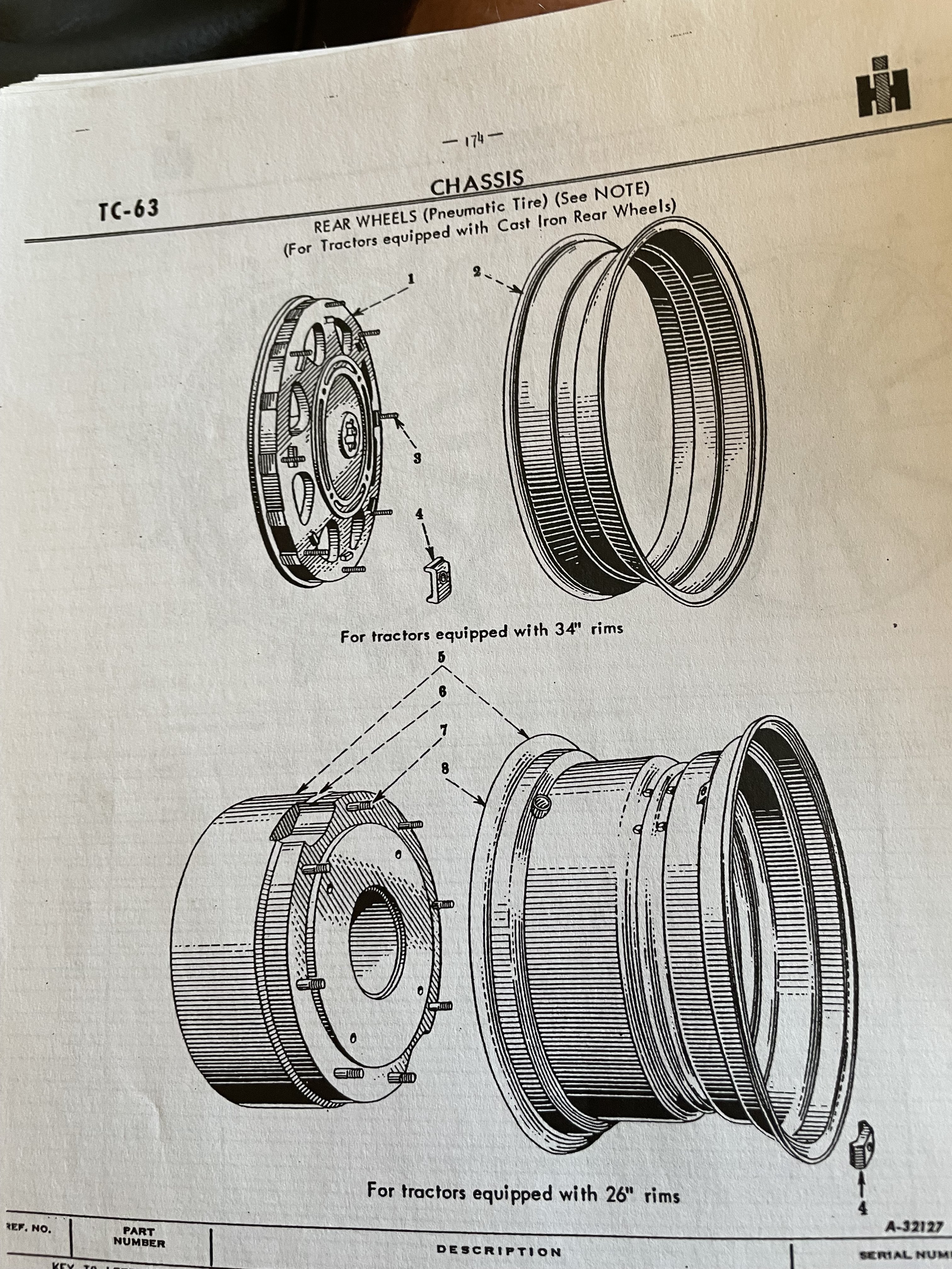

600-650 parts book
So the 4 bolt holes in bottom picture that face rim will match the top wheel weight holes if reversed and mounting bolts go through top wheel and thread into holes in weights? Makes sense but can't find the part number that he shows.
