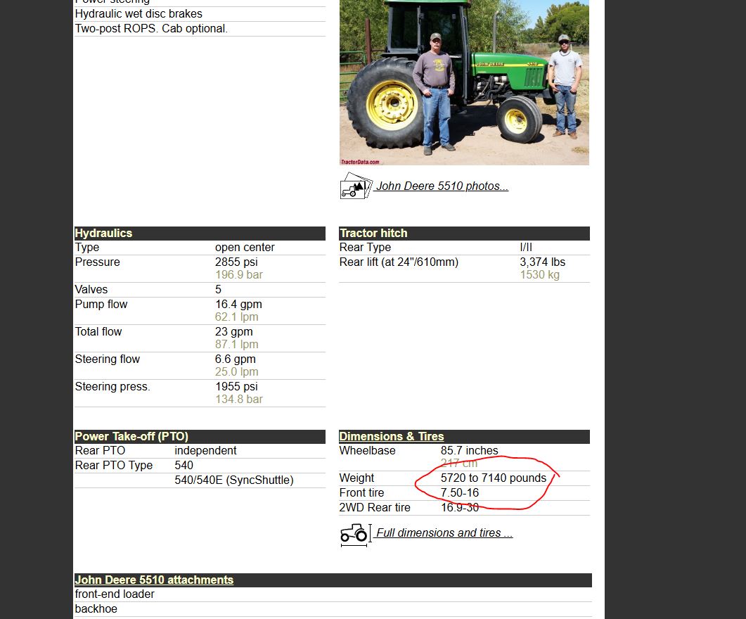

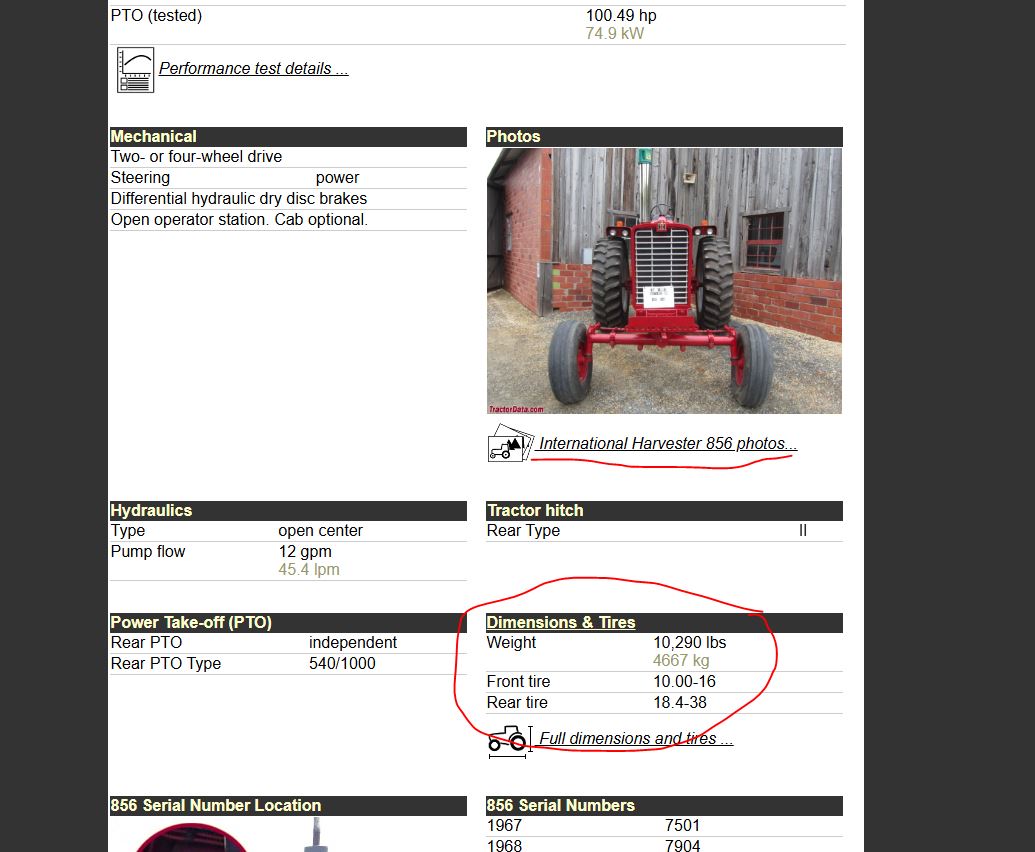

I have little experience pulling discs with anything smaller than an IH856 or IH1066; but I see a potential for cross purposes here.
According to TractorData, a JD5510 has a respectable 82PTO HP. It's a nice, strong little tractor.
But it might weigh as little as 6000 lbs.
I speculate (the operative word being speculate) that... If you get a set of 12' discs... and then try to weigh them down and set them to cut/level your ground in one pass...
A. You'll be back at 1mph again... and really won't cut very well.
B. You'll be pulling the guts out of that nice little engine.
C. You'll end up having to unload the discs or change their setting to pull them efficiently... and they will just kinda scratch the surface and not level, regardless of how many passes you do.

My advice would be to measure the width of your 5510 and get a set of cutting discs that will cover the width of the tractor, no wider... and then set those suckers deep... get your ground level.
You can always unload them and change the setting later to do your finishing passes.
Just like with woodworking... you need to gouge, cut and level, before you go wide and smooth...
Weight and size specs below.
JD makes good tractors. I'm just saying that, the last time I pulled a set of 12' discs with an 856... if you had the discs set to really cut, it made the 856 grunt, and they pulled hard...
For a 100HP, 10,000 lb tractor.
I think that 5510 will be overmatched at 12', unless the discs are just scratching the surface.
