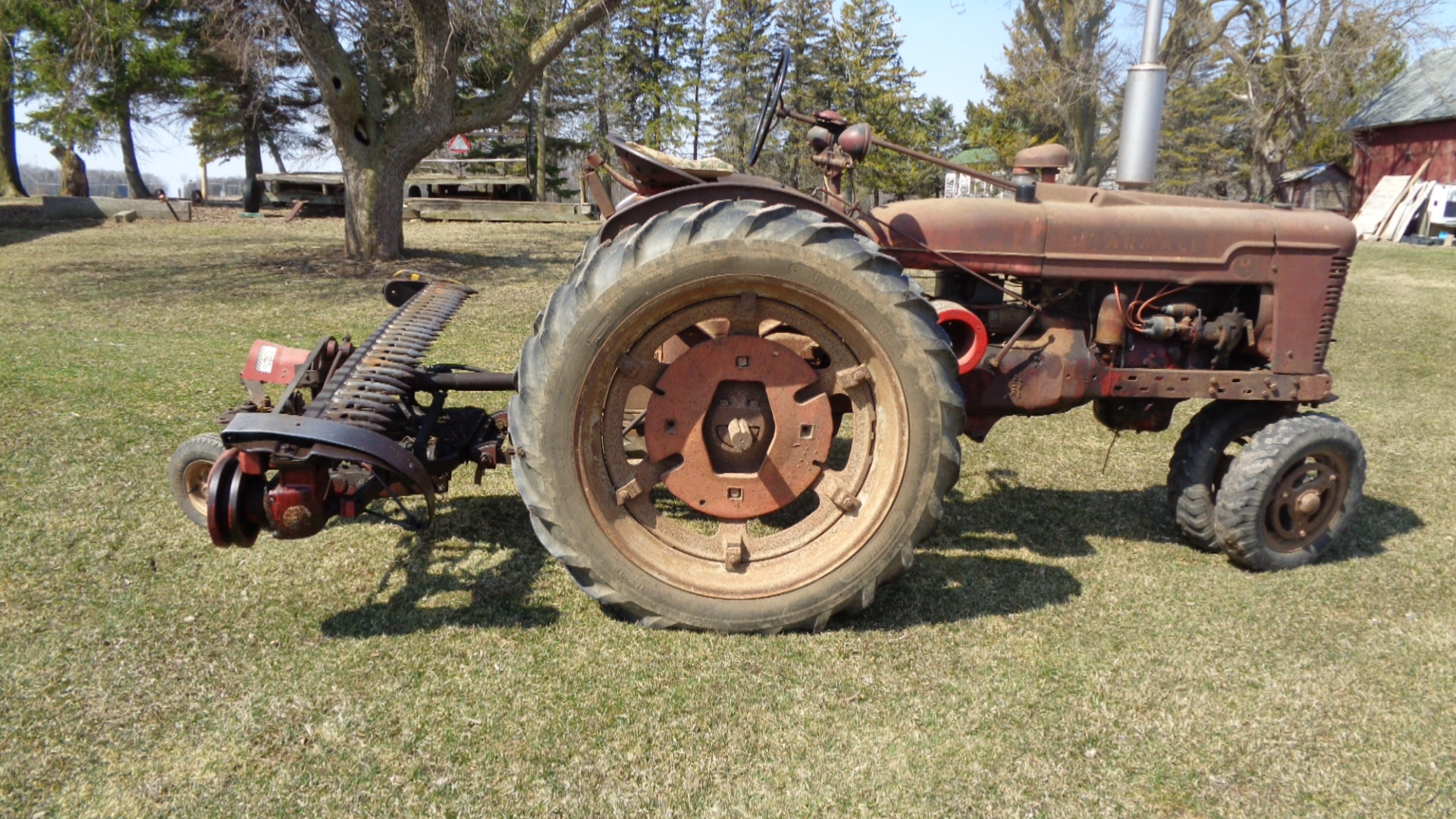

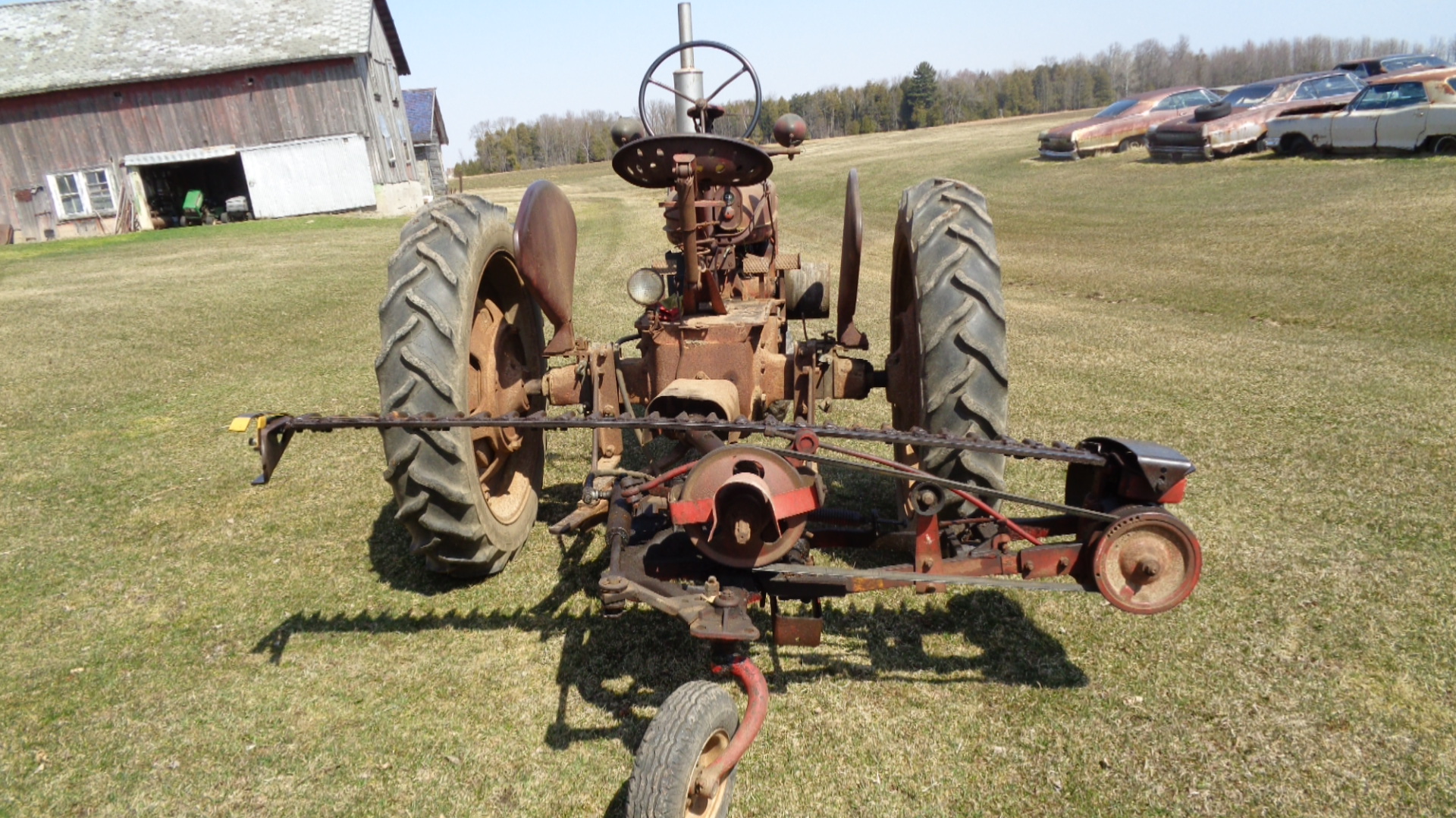

What I got for our Farmall C !

I only know the single point hitch like the new idea 30a .We had a an axle hitch on the bill of sale for this tractor .what happen to it I don’t know.
Plan on having all the hardware set up on the sickle bar correctly set up on a single point . You will on and off the seat of the C to unplug jams due to poor cutting , also more Tylenol is required. Getting on and off your C .Ah , do it ,practice getting on and off your C 20 times in ten minutes. As you can see my C is not operational friendly for mounting and dis mounting.Check out what the cost mower sections you will buy cost. Ledger’s also.
Check the wear at the cutter bar pivot. Check out Pittman drive for wear,
Cost of the mower will be cheap compared to the repairs .
I would highly recommend from experience using my set up , the mid mounted power set up 1100 ihc , ( balanced head , model ? ) that way your not looking backwards all the time adding your fatigue and Tylenol consumption.
