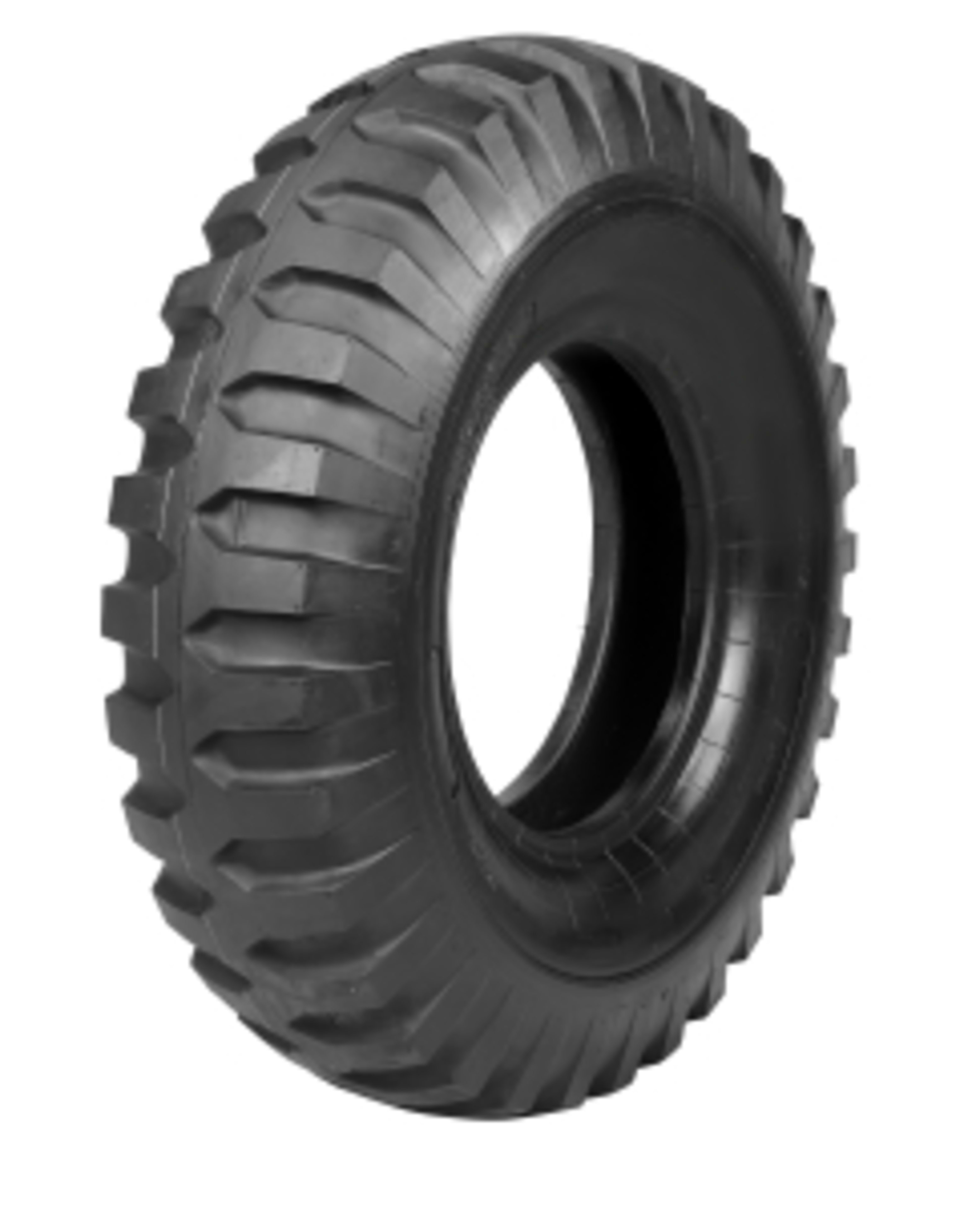

I don't have a Bobcat but In the 1940's to name a period, military vehicles had straight bar mudgrips and the rationale was that they could provide traction in both directions. The movies I have seen, since I was born in '41, show a lot of getting stuck.

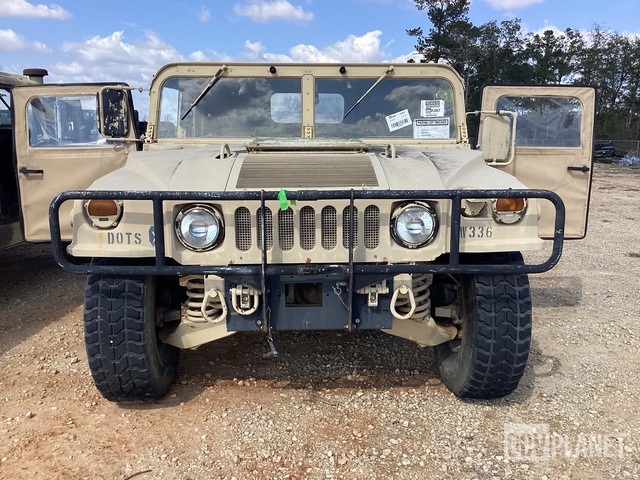

There was the right way, the wrong way, and the Army way. The Army way in action. The new humvee tread and the old army tread.

Years ago I wanted some mud-grips for the rear of my truck. Shopped radials and none had a v lug, all had these posts like is in the center of the tires on the Hum-Vee pictured. So I said heck with the radial and found some bias ply and got the pattern I wanted. Apparently there is something about the radial that prevents it from having the V lug design. Surely tire companies have the resources to see what works in mud and what doesn't. Open to comments as to the functionality, reasoning behind their choices.
By V lug do you mean these? Michelin cross climate 2. Put these on the Subaru last month.
I always heard the old military tire tread was so they enemy would not know which way you went by the tracks versus a different pattern that was directional like a tractor tread.

But it is a skid loader so he will be pushing and pulling in both directions
Dad was in the 4th Armored during WW2 driving a truck hauling prisoners back and supplies forward, he told me preventing the enemy from knowing which direction you where going the was the Armies reason for the non directional tires

It would make double sense that you are both right. There were two reasons to use that style tread. My Dad as a dozer operator in the Leyte Gulf and Okinawa invasions did a lot of pulling vehicles through the mud when he wasn't clearing airfields and building roads.
In reality they all new where the enemy lines were and most driving was done behind, at the lines, or when advancing.
