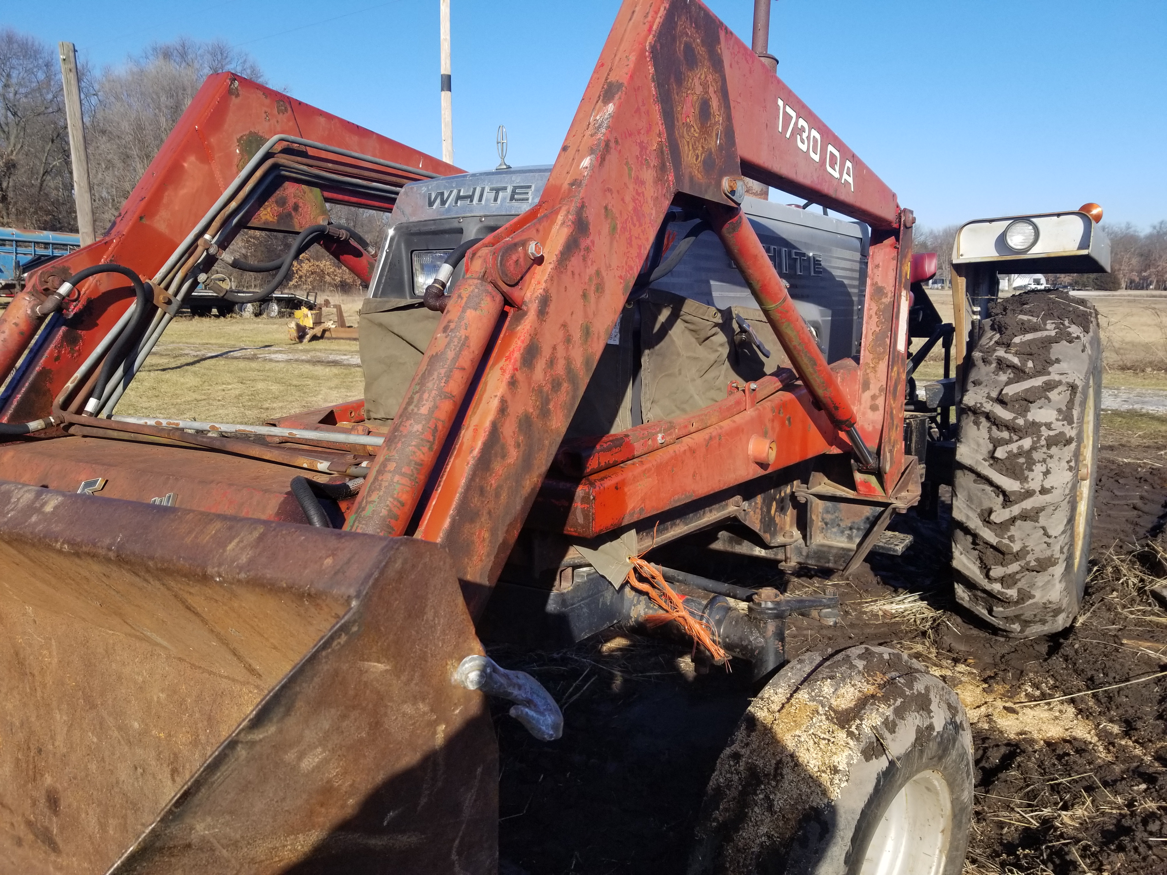

My White (I bought this last September so this is the first winter) 2-70 carb is icing up. Yesterday it was 39 degrees F. Iced up to the point it caused me to have to pull the choke all the way open to keep it running. Was moving feed auger carts around, moved a couple round bales to feeders and then took garbage can to the road. Shut it down and the block heat thawed the carb, but then coming back from putting out a bale it froze up and barely got it backed under the lean to roof. Looking for some tips to prevent this. At this point this tractor couldn't even plow my driveway.

Do the old farmer fix. Feed sacks essentially blocking all of the air from getting through the radiator. Then sacks covering the side of the engine the carb is on from the fan to the past the carb. The blocked air flow through radiator will help it warm up the lesser amount of air that the fan pulls the through the radiator and blow it over the carb to warm it up. Just watch the temp gauge on warmer days the radiator sacks may need to be opened a bit on those days.

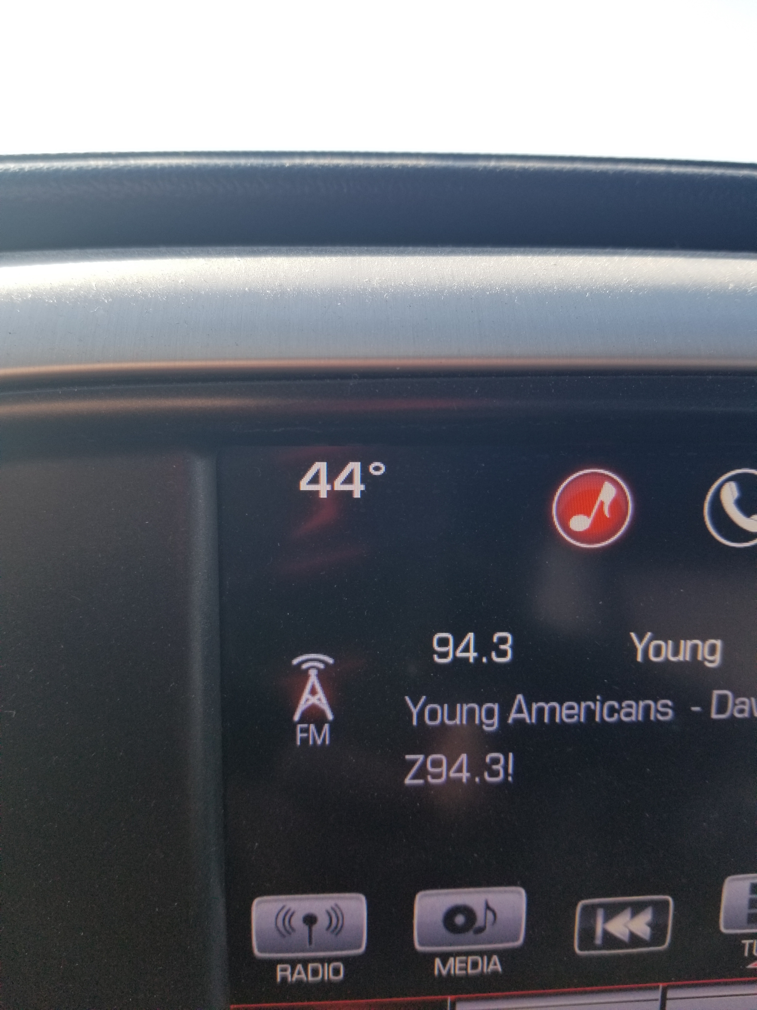

Today's current temp per the pickup temp gauge.

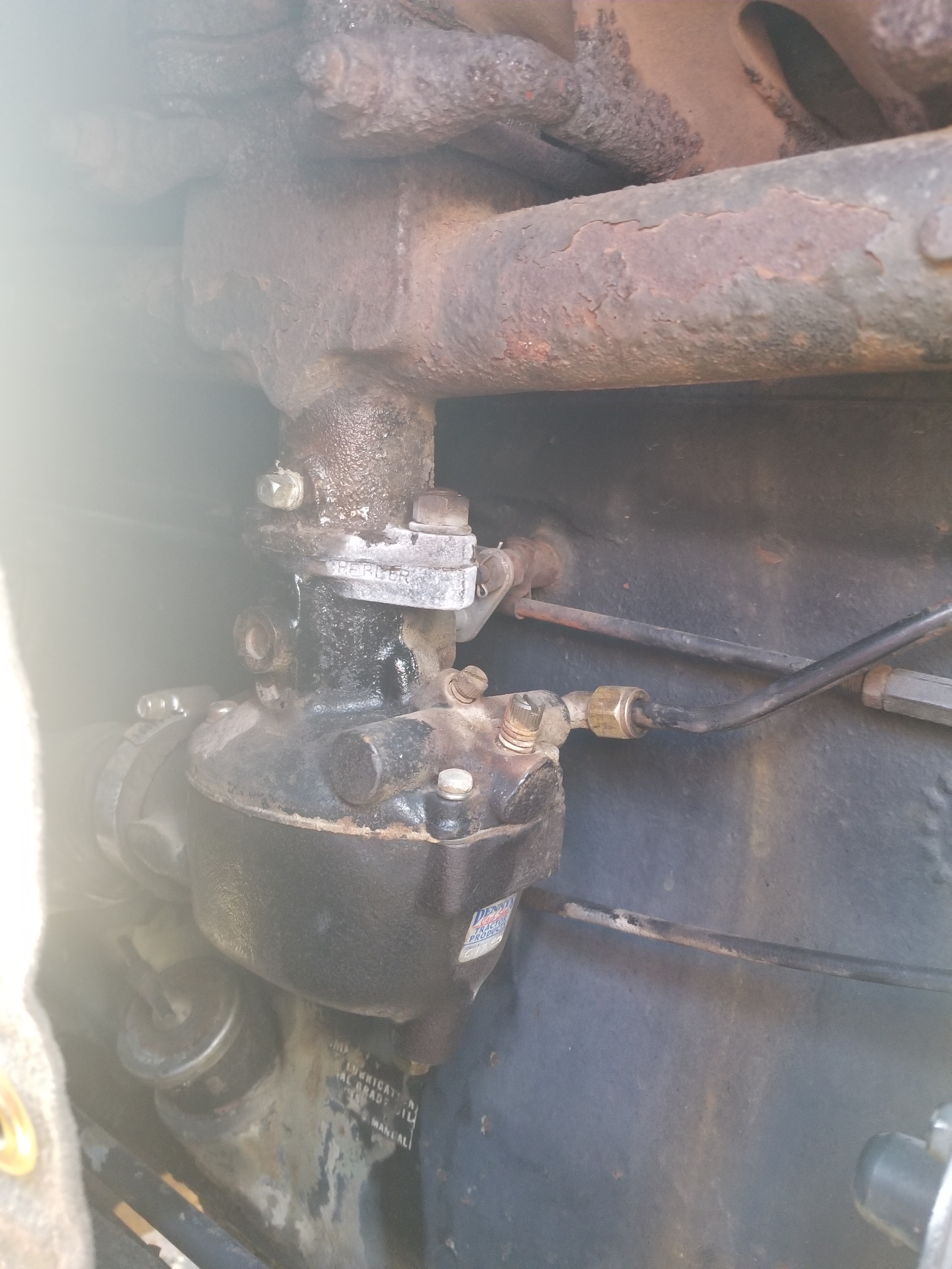

I shut off the tractor and moved a pile of firewood by hand and remembered I had my phone so took a picture of the carb after probably 15 minutes. It did thaw and allowed me to back it in under the lean to roof. At this rate I won't be able to unload a load of feed with out shutting it off and letting the carb thaw.

The "curtains" I made cover the entire front of the radiator and around the corner and the entire side opening til past the carb.

Dinged by Denny’s Lol! Interesting, maybe you’re going to have to resort to fabricating and air stove like Dan is showing. I doubt the “juice” in the tank will cure anything, hope you prove me wrong. The humidity in the air is what is freezing and accumulating in the carb venturi or probably right above it. Last resort buy a diesel :) then you won’t have to worry she won’t start at all. Actually, engine heaters make them fairly dependable until the power goes out.
Holy bananas! That's really freezing up. Some sort of steel shroud around the exhaust manifold and carb is the typical fix you'd see on tractors like the Allis WD and others that were prone to carb icing.
The carb in your pic seems to have a tag on the back from a tractor parts supplier. I wonder if it's a different M/S carb than the one it had originally. There are/were many different sizes of those TSX carbs with the same mounting pattern. Many of them had a slightly smaller throat, and many of those smaller ones were very common. Maybe someone's swapped carbs at some point with one that has a slightly smaller throat, creating more pressure drop across the venturi and thus more icing concerns. You could try putting the carb from your 1650 in the shop on there and see what happens. I think the 1650 and 2-70 had different stock carbs on them, but same engine, so it shouldn't be too out to lunch.

There's two things that make the carb so darned cold, the venturi effect of the air stream speeding up to pass through the venturi, then slowing down in the larger cross-sectional area after the venturi has a cooling effect.
Also, when the fuel vaporizes at the transition from atmospheric pressure in the carb's air horn ahead of the venturi to depressed manifold pressure after it manifold it takes HEAT (latent heat of vaporization) to effect the phase change, further CHILLING the throat of the carb.
Using ethanol gasoline or adding gas line antifreeze will help, at least SOME with the freezing INSIDE the carb's throat that causes the problems the O.P. is having.
And, bundle up the engine to keep the carb as warm and comfy as possible.

So in bundling up the engine, I should extend the canvas curtain I made to cover the entire side as well as the other side of the engine.
