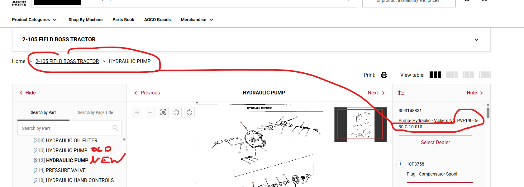

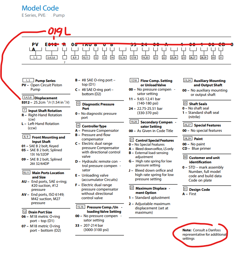

My biggest bone of contention with these tractors is the hydraulic pumps. These tractors used a Vickers PVB or PVE (depending on serial #) closed-centre/variable-displacement pump, which really should have only been used on industrial, stationary HPU's with completely closed circuits and excellent filtration systems. In my opinion, they did not belong on tractors operating in Ag environments and subject to occasional dirt, dust, and cross-contamination when implements were swapped between tractors. There are loads of these pumps still operating just fine - especially when owned by folks who've had them for decades and have thus been able to maintain their hydraulic system properly. Unfortunately if (like me) you buy it used, you have no idea what kind of goofballery has been done before, and if the fluid/filters have ever been changed or whether the PO has taken care to keep all dust/dirt out of the system. The pumps can wear out, bypass, and essentially render the tractor useless as so much depends on good and consistent hydraulic pressure. Thankfully a lot of the time the problem isn't the pump, but a tiny bit of dirt in the compensator or priority valve, which can be cleaned up and put back into service. But the pumps do wear out unless the system is meticulously maintained. Search these (and other) forums for 2-85 and 2-105 hydraulic pump issues and you'll find oodles of threads where people have had them go, and the cost of a new pump (if you can find one) is often more than it's worth to repair the tractor. If the one you buy has a good, working hydraulic system and you take exceptional care with it you'll probably be good. And if you can turn down the compensator a little to have the pump de-stroke at a lower pressure, you'll also add some longevity. I have ours set to about 1300 PSI, which is about as low as I can have it to operate my JD 435 baler. Just be sure to check this before bidding: Let it run for at least 10 minutes and listen to the pump and feel for excess heat. Ours had hydraulic issues, but thankfully most were perished o-rings in the compensator & priority valves and hammered-out shims in the relief valve (which was making the relief pressure lower than the de-stroke pressure when we first got it). Cleaning and re-setting the relief pressures has got ours working, but the pump is still worn and bypassing far more than it should. It gets hotter than I'd like (180-190ish while baling), but it's still working ok for us. Especially since we only use it for baling, and seldom bale more than a couple hours at a time.
