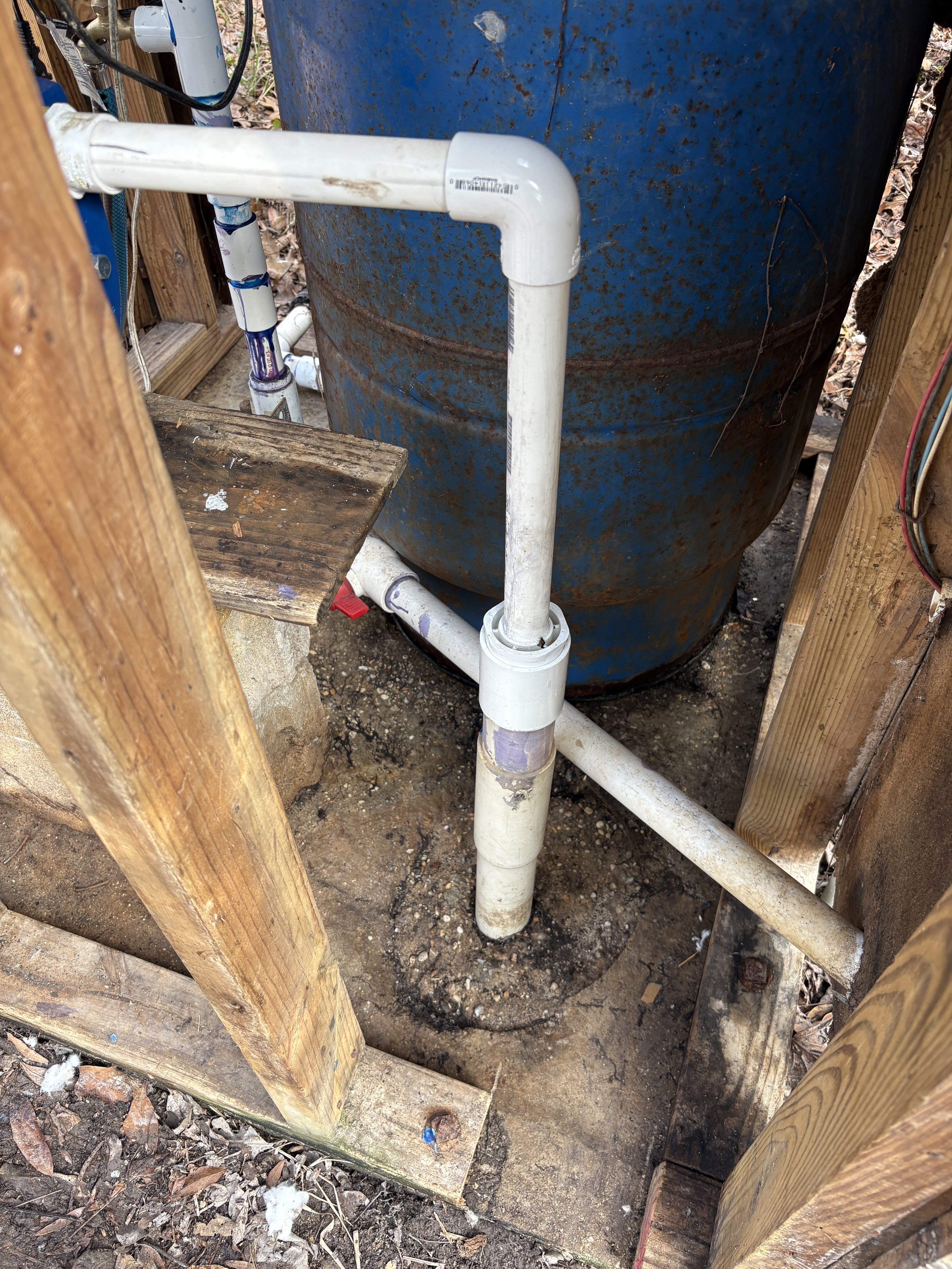

"Completely sealed" is a fantasy. No such thing. Don't let pride cause you to make bad decisions.
Please educate me on how it is not completely sealed.
A 2 inch pipe is drilled into the ground like an oil well. On top of this 2 inch pipe a fitting is glued with a 1 inch hole in it. In this one inch hole is a 1 inch pipe glued into it with a foot valve on the end of the pipe.
When the well was drilled in the 70’s bleach was poured down the well by the well drilling guy to disinfect anything that could have been introduced into the well during the drilling process. On the top of the pipe is a check valve that seals the top of the pipe.
While this check valve has been replaced nothing below it has been touched since the well was drilled 50 years ago.
Like I have said my well is completely sealed and has been sealed since it was drilled in the late 70’s. The only reason I would have to open the well is to replace the foot valve on the end of the suction pipe.
There is no way for me to get chlorine or anything else down the well unless I go to cutting pipes.
Between the pump and the top of the well is a check valve so once the water comes out the well it can not get back into the well to contaminate anything.
I looked online about shocking a well and everything I see is for wells that have a removable cover with a 4+ inch pipe and the pump down in the well. I couldn’t find one setup like mine anywhere.
Like I have also said for bacteria to enter my well it would have to come from 200 feet in the ground and while rust may be present I find it hard to believe E. coli bacteria could get down that far.
And since my well pump pressure tank and pipe are all sealed from the check valve to my kitchen sink faucet I find it hard to believe that any surface bacteria could get in my system unless it got in while I was working on the system.
While none of us has ever been sick from drinking our water you guys got me scared so I am going to call my local health department next week and ask them about a water test.

No idea if these apply to your well but there are a few ways the integrity can be compromised
Poor cement job when they set the casing or even just over time its degrading like all things.
Tree roots can cause issues.
Ground movement can compromise the seal around the casing.
Its also possible its not your well causing the issue but a neighbors well is an its making its way to your water supply.
Its not a bad idea to have a water sample checked every few years

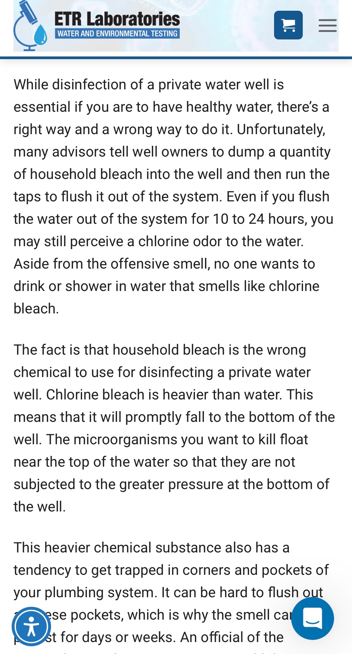

One of our wells is sealed also, because it is a high pressure artesian. Last summer my wife complained about the water smelling, so I changed the filter and added 2 ounces of Clorox to the filter canister, and the smell went away.
Huummmm

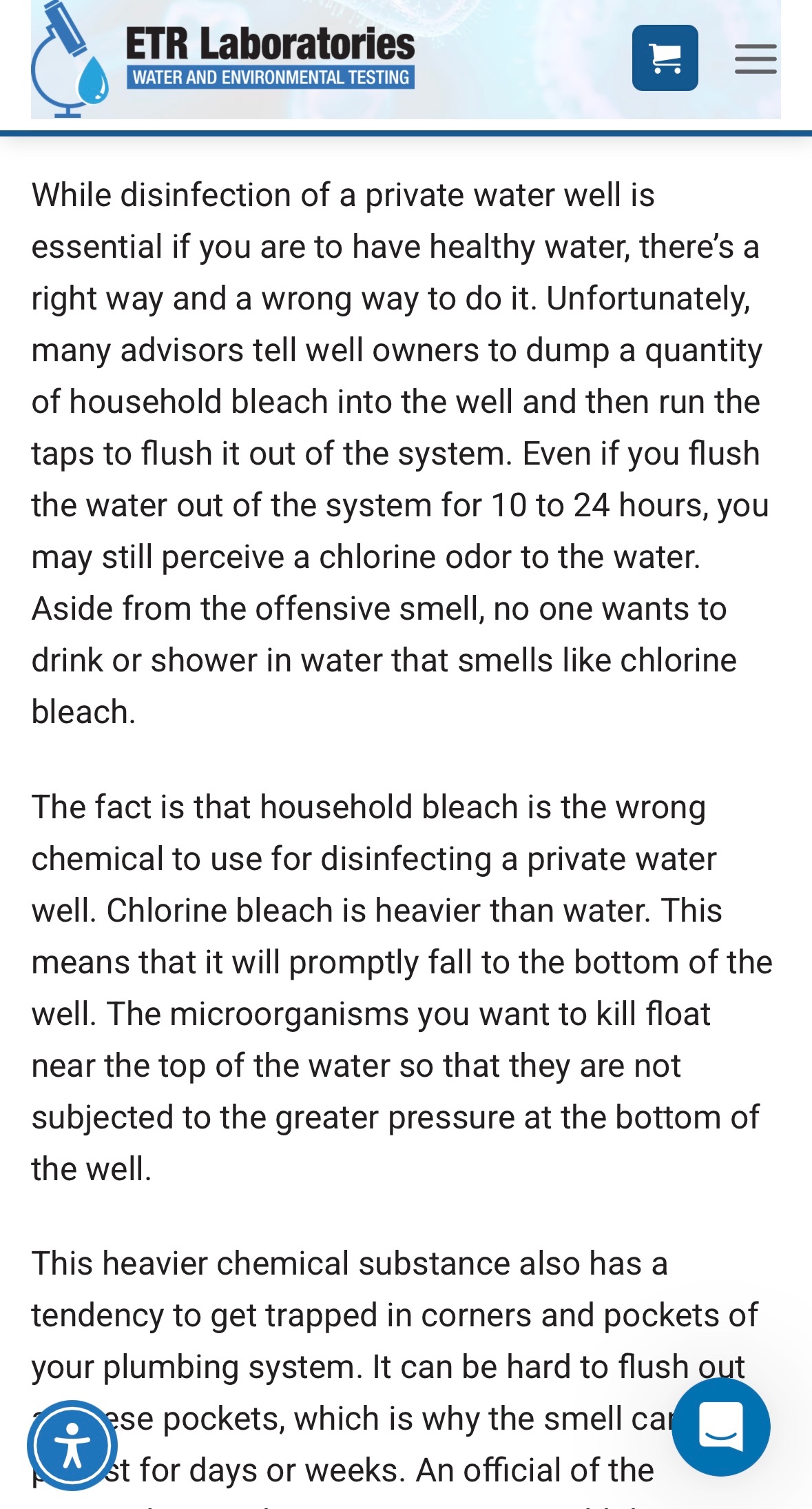

I question the integrity of this outfit. They say that treating a private well is essential. I've been drinking out of my private well for 54 years now with no problems and it is never been treated. It was checked once and passed with no problems. It is a 4 inch steel cased well that is only 60 feet to water. I have no idea of how deep it actually is. It was drilled in 1965.
I trust it and have no desire to treat it with anything.

I was out yesterday replacing the siding on my pump house and decided to take a picture of my well. You can see it is completely sealed and would take cutting pipe to shock it with chemicals.
I talk to a local well guy and he told me I would need a machine that puts chlorine in the pipe all the time to treat rust as I am always pumping up new water. My rust problem is not that bad. My pipes have a small rust film but my sink doesn’t have rust stains.
As far as harmful bacteria goes he told me my well is so deep harmful bacteria can not live where my water comes from. 100 psi pressure down that deep from the water depth and the water is to cold. And since my water pipes are completely sealed above ground there is no way for bacteria to get in.

Several videos I watched showed them circulating the bleach with a hose from the pump back into the open top well.
I couldn’t do this because my well is sealed. I can not pump water and pour anything down the well at the same time.
Another thing is if I cut the pipe.
Poured the bleach down the well.
Reinstalled the pipe so the pump will work.
By this time all the bleach would no longer be in the well pipe.
Bleach is heavier than water.
Bleach will quickly sink down the well pipe contaminating the water pool the end of the pipe is stuck in.
I would be pumping bleach for weeks trying to get all the bleach out the bottom of the well pipe over 200 feet in the ground.
