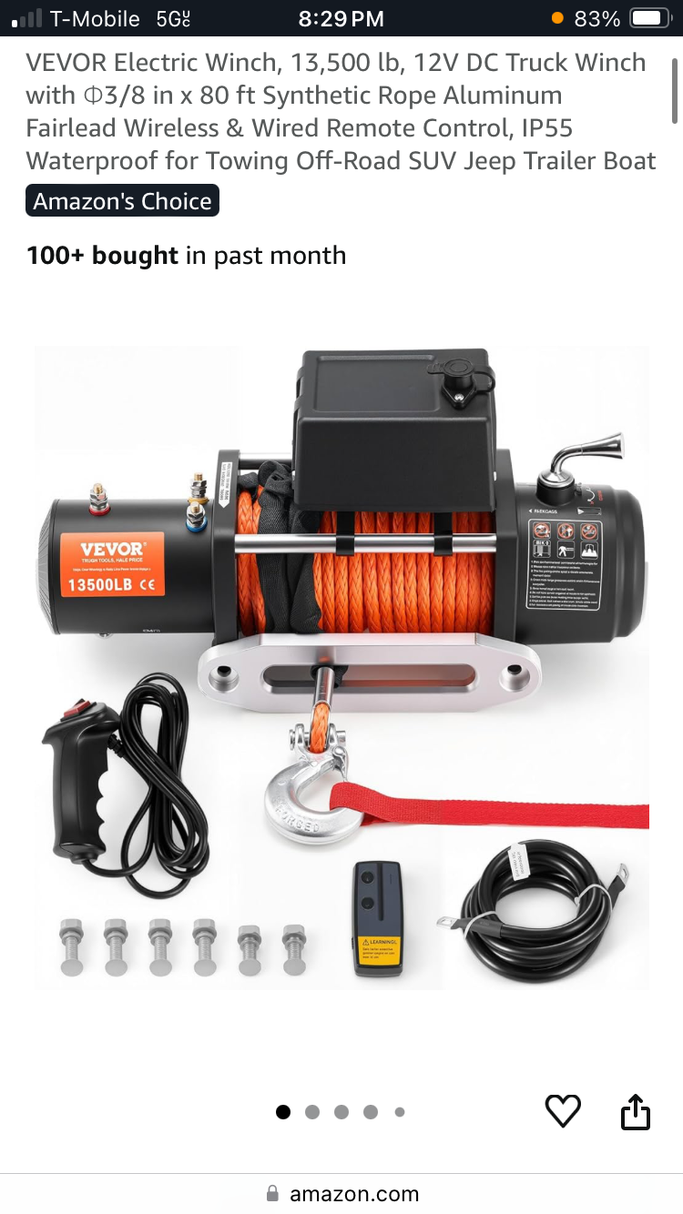

I’m looking at this winch as an upgrade from my current one that uses wire rope that I’ve always referred to as “steel cable.”
Anyway, I like the idea of going with synthetic rope but wanted to know if there are any drawbacks. Seems like it would wind on the drum easier, not sure about that. This winch gets pretty good reviews, should be ok for very occasional use on my trailer. Thanks for any thoughts.

I can't really tell you pros and cons but I know most jeep people go with the synthetic rope instead of wire rope if they can. I think it does wind better on winch and if it snaps not as apt to take out a windshield or person.
The cons to synthetic rope are it degrades in the sun, and if it rubs up against something while pulling it can be damaged/frayed.
A good steel wire rope can last a really really long time if taken care of. I have a winch that is 30+ years old and still has the original steel rope in it with no signs of damage.
The real danger with any winch use is the attachment hardware on the end breaking and the rope recoiling back at you. I have broken a fair number of cables between logging and working dozers. Never had a cable fly. They always just fell to the ground, but the dead end was still well attached to its anchor. If your hardware fails, a synthetic rope will still recoil.

Not true. Synthetic rope does not degrade in sunlight. It does not fray when rubbed on something. Why do you think Non Roller Fairleads are recommended for them?
Synthetic rope is far better than wire. It doesn't rust, will not snag your hands when frayed, easier to pull out when free spooling and much less lethal should it break.
The biggest thing you need to watch when buying a winch with the rope included is the rope itself. A lot of cheaper companies will put 5 to 6000 lb rope on 10000+ lb winches as a way to cut cost. Best to contact the manufacturer and check if the rope matches the winch lb.

Thanks for the replies. I’ll go with the winch that I posted a picture of, it’ll be a step up from what I have now. If I use it once a month, that would be a lot.

GerritView attachment 127576
Vevor is certainly Chineese, that being said, I have had good luck with their products. Jim
