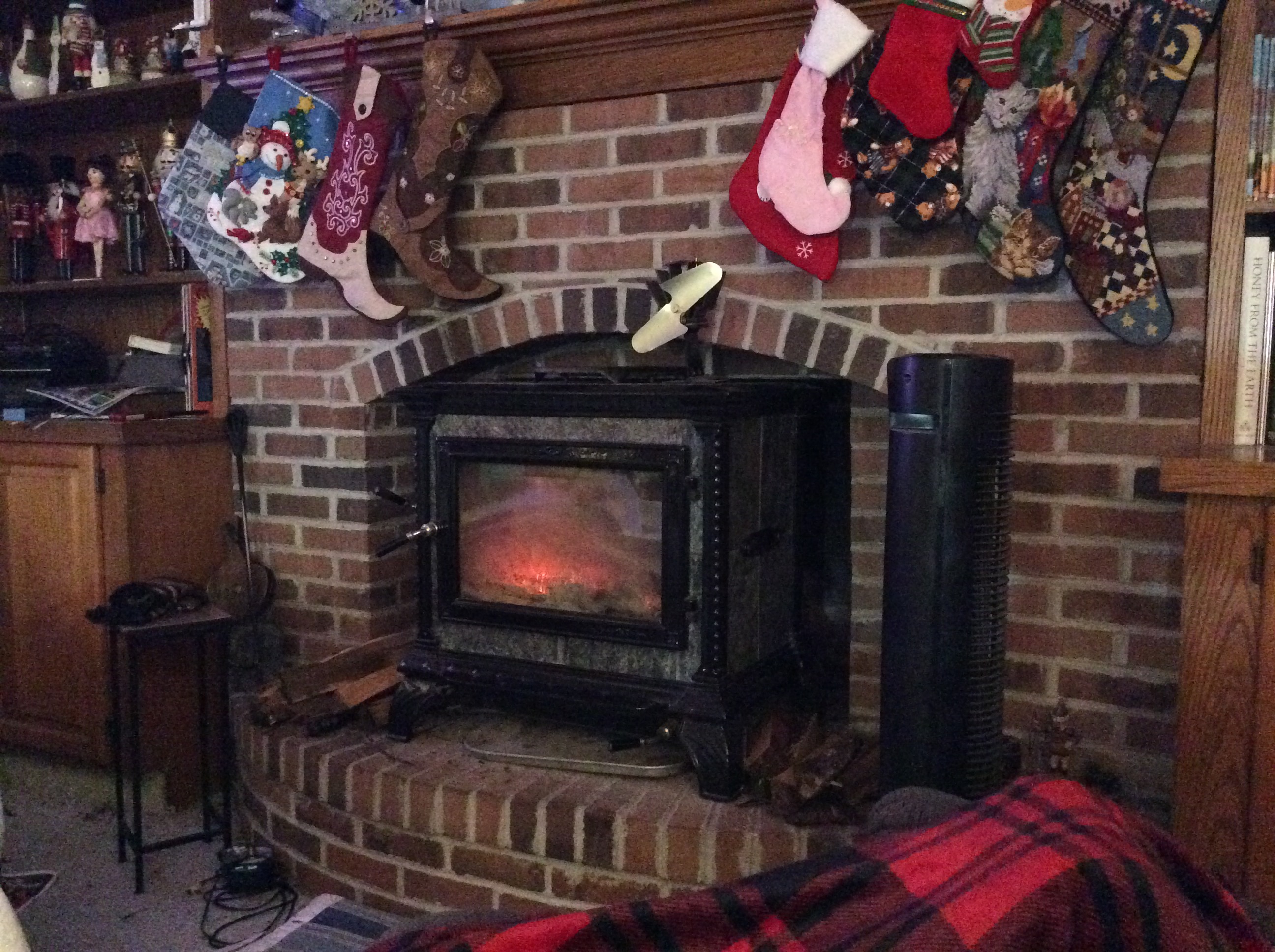

I have a "Hearthstone" soapstone stove which I purchased in 2006 for $2,441.00 which was relatively expensive at the time.
This replaced a Vermont Castings stove I had bought used.
I burn a full 3 cords of wood annually and have an LP gas hot water furnace as a backup.
I burn nothing but absolutely dry fully seasoned hardwood; Ironwood, hickory,red and white oak, sugar maple, red maple and ash.
During the entire time I've owned this stove I have never had to clean the chimney which is outside and made of masonry and field stone.
The only repair parts I have bought are: a grate ($134) in 2020 and a refractory baffle ($82) in 2021.
I have not priced them lately but I can imagine they are still relatively expensive.
However, at about $175 per year you can say that my stove has paid for itself.

Love our Hearthstone - poked a hole in the baffle about 8 years ago. I bent up a replacement out of stainless...
