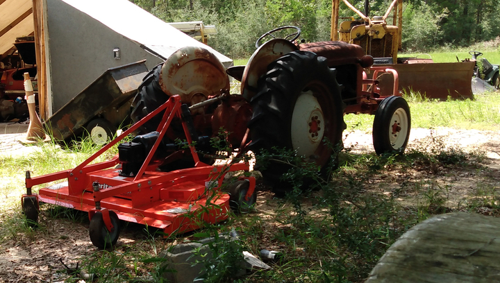

I have a woods 72 inch belly mower on my 1950 Farmall C, The Boss loves it. She mows her yard with it.
I have a rear mount woods on the back of my old Ford. 5 years ago the mower got put behind the Kubota.
I like the old woods mowers because they discharge the grass on one side, not in the back like newer models.
The second pic, 1955, is my dad using a JD A pulling a woods corn stalk chopper and a disk.
The Woods brothers made pull behind corn stalk choppers and made aftermarket mowers for other tractors.
