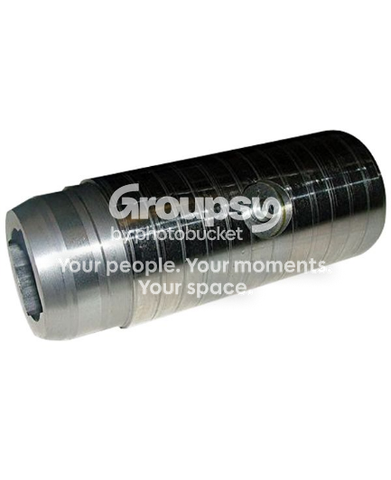

I don't know about the Woods finish mowers but, I have a Woods M5 brush mower. This mower has a square shaft coming from the gear box. It has an outer shaft with a square female end that slides over that square shaft so the outer shaft can slide on the square shaft if it needs to.
The problem with cutting that outer shaft is that the female end of it only has that square opening on about 5 inches of it. The part in the pic below is what is welded into that outer shaft. If you cut too much off the mower end you will be left with no square end on that outer shaft.
