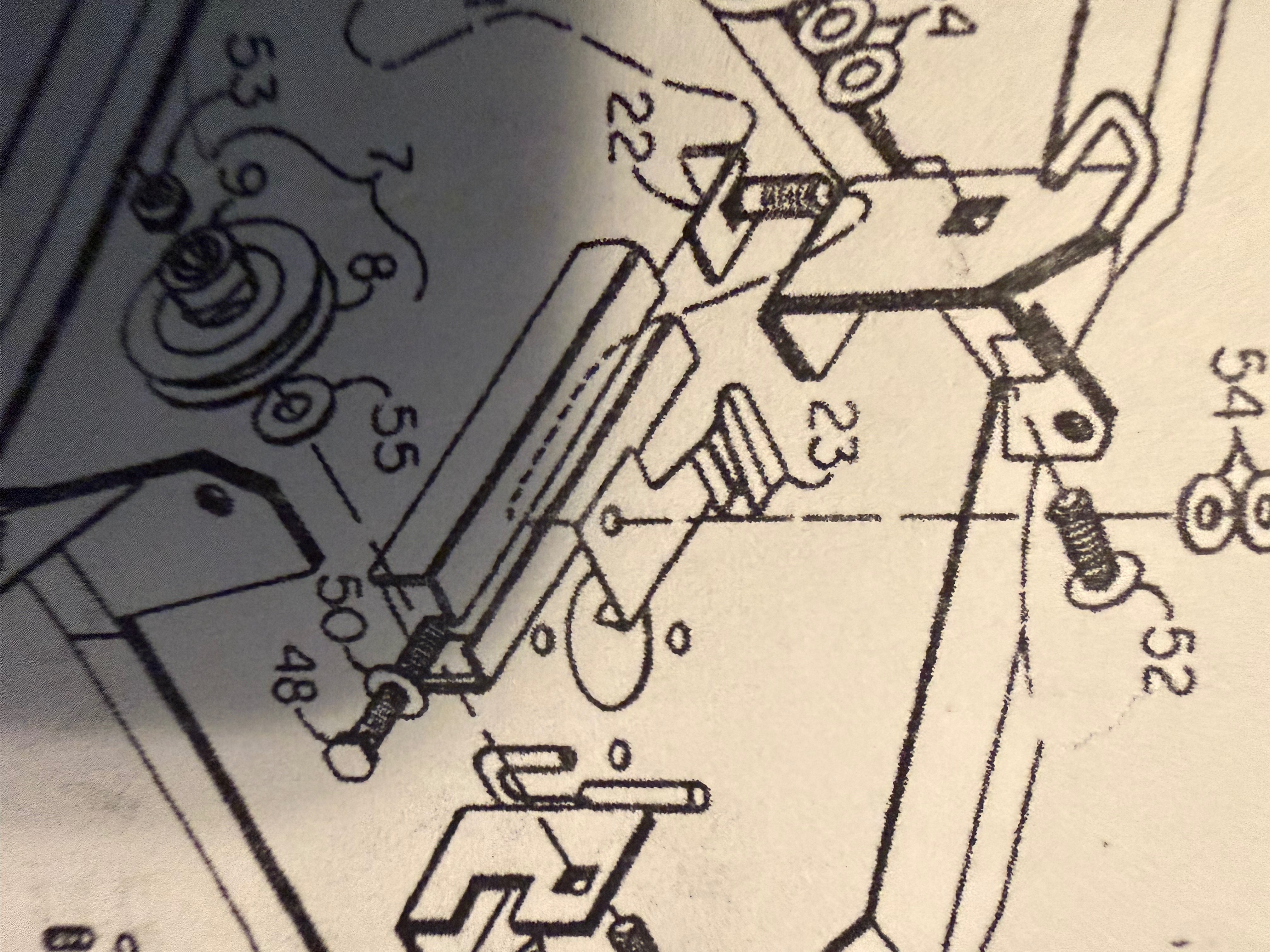

I am in need of some help! As I have said before. I am rehabbing a Woods RM59-1 finish mower Serial number 3670. Doing research, the unit I have was the original RM-59 model and it came off the assembly line as the 2670 unit made! So it is very old! What I need is if possible, someone to provide me with some pictures and measurements of the part # 23818, RM-59 Takeup Idler Belt guide. It’s not available, as far as I can determine, so I’m going to have my son in law make it for me. Thanks

Have you called Messick's? The parts info on their site does not show it as discontinued. They may have a way to source one.

I have been trying to find a part for the Woods RM59-1 mower that I am rehabbing. Did not come with it when I purchased it used! I have checked with several online retailers and some local suppliers. Seems like it’s not available anymore!
It’s the Idler Belt Guide part#23818, diagram #23 which from the website diagrams looks to be about 4 to 6 inches long and sits above the channel that the long bolt is located in and is under the belt pulley that is on top of the guide and the channel. Hopefully you can follow that description! If possible would you please take a couple of pictures of it so I can see if my son in law will try to make one for me at his fabrication shop. I would greatly appreciate it. I figure since you have 2 of them you would have great access to taking pictures. I attached a photo of the diagram, item #23. Thanks
