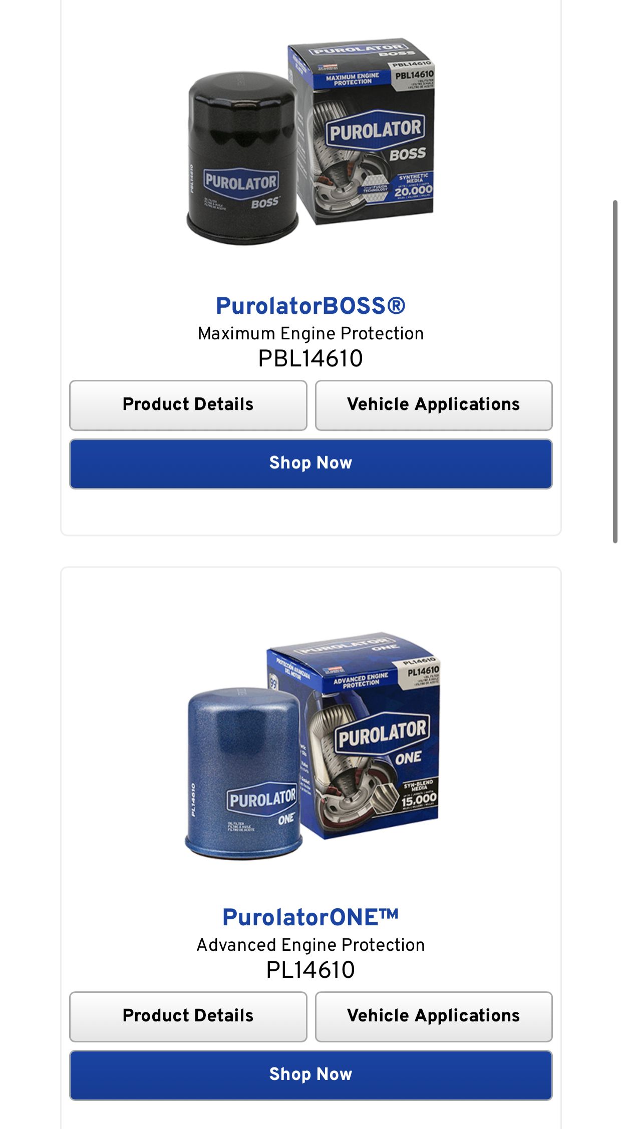

huh okay then i had the WIX 57356XP if that makes a difference for the height requirements but okay then ill see what the compatible purolator filter is then...

okay looks like one of these purtyy purolators should fit as long as its a PL14610 variant
If you wanted, you could use Rockauto and do a WIX and Purolator filter height comparison. Finding the taller filter is a great benefit. Long as it will not stick out to make contact with the loader arms or the sub-frame or whatever.
Some people complain their loader moves slow after a fluid change. I ask them, what new filter did they add. And it's a WIX or some small micro slow flowing filter. You do not want to dead-head the pump. It's asking for huge troubles.
ordered the purolator boss 14610... im
hoping the microns are what they need to be... the local tractor places only had the regular (red) ...and not the boss ver- but now that im down this rabbit hole im hoping the boss isnt more restrictive than say the red version 🤔 --either way its got to be better than the wix thats probably been used on this thing for years before it became mine

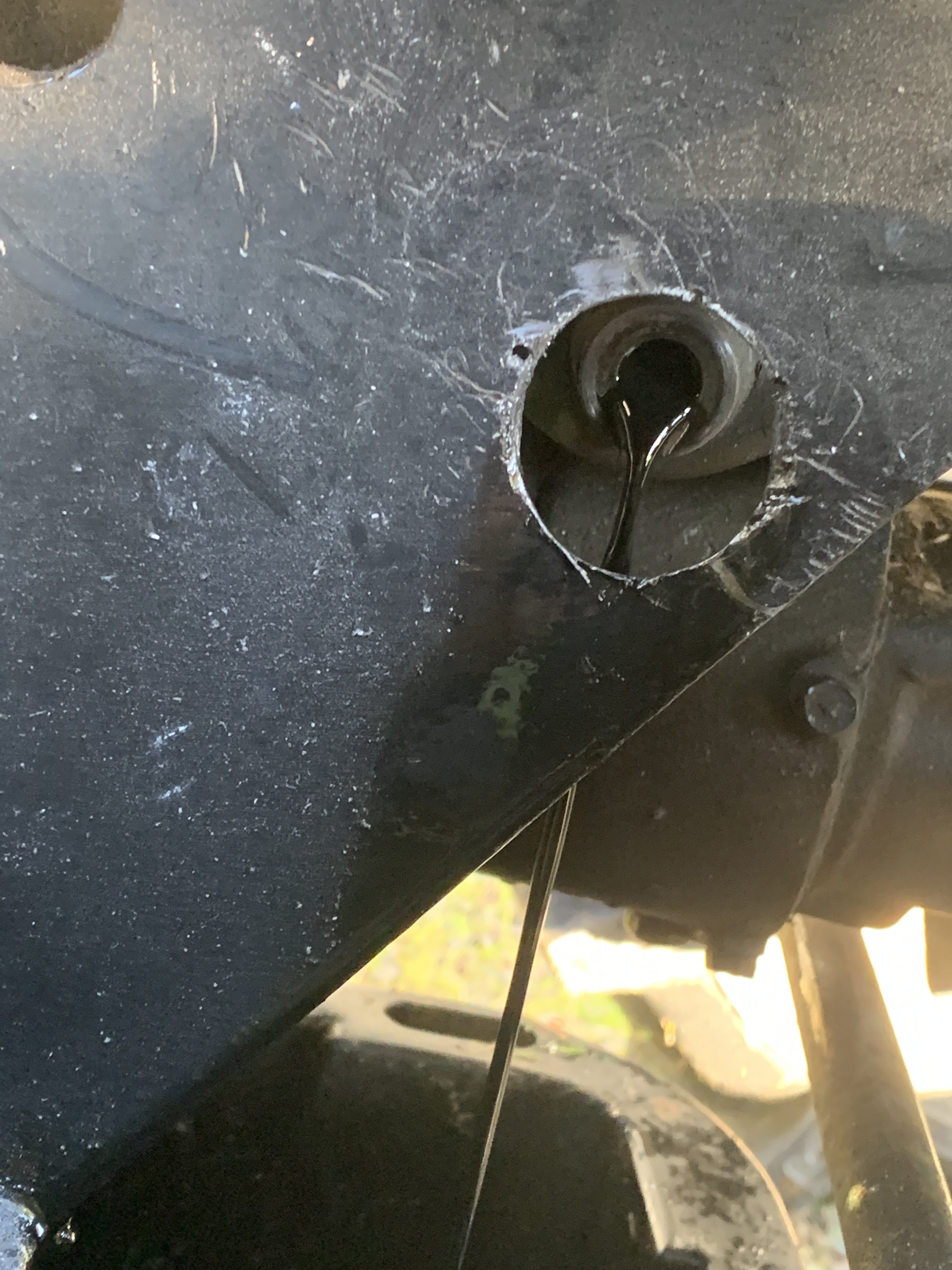

felt like a genius finding the oil drain plug
on this thing i tell you, what!
pretty much under the dip stick above

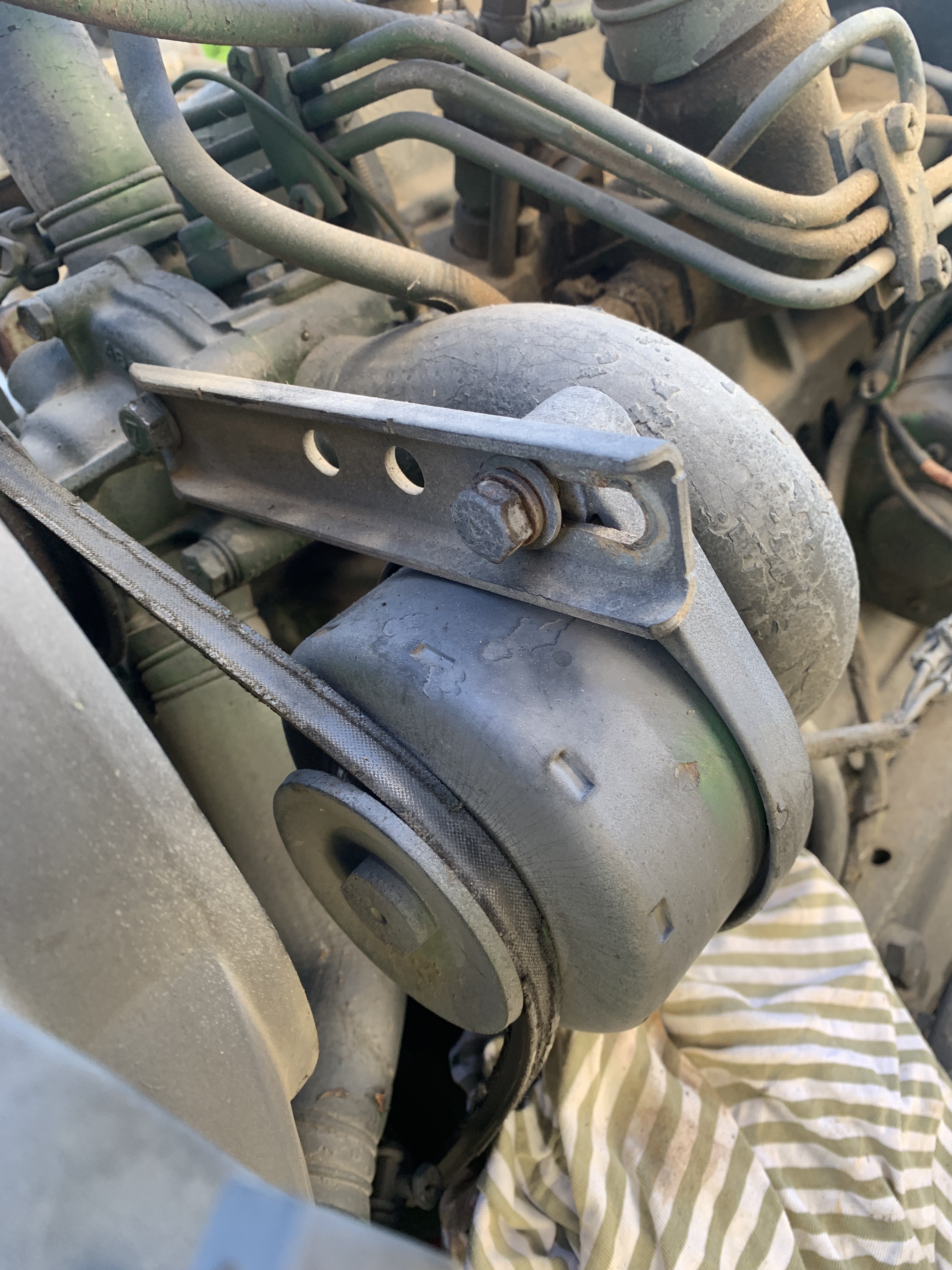

finally had a moment to tackle this after a few weeks ---
had to loosen these two bolts on this thing and tilt it away to be able to spin off the oil filter-- not sure if thats because the belt is super old or what but it got figured and done
then i had to use a 1-1/4" lennox hole saw (had tried other methods heh... shoulda just got the $15 thing from the get go--- then i wouldnt of had to 'hole saw within a blind hole at obscene angles on the edges hoooh...howdy... angled it good to get it to bite through... :LOL:
but i finally got to actually remove my oil drain bolt because it was just not happening other wise trying to snake something between the loader bracket etc!! :oops:
(hole is actually more centered than this angle it just looks off in this pic)
but its done... thankfully 3 qt came out... 3 qt of SAE 30 went in with that new purolator 14610 filter!!! future oil changes with a long socket are to be 95% more accessible now
