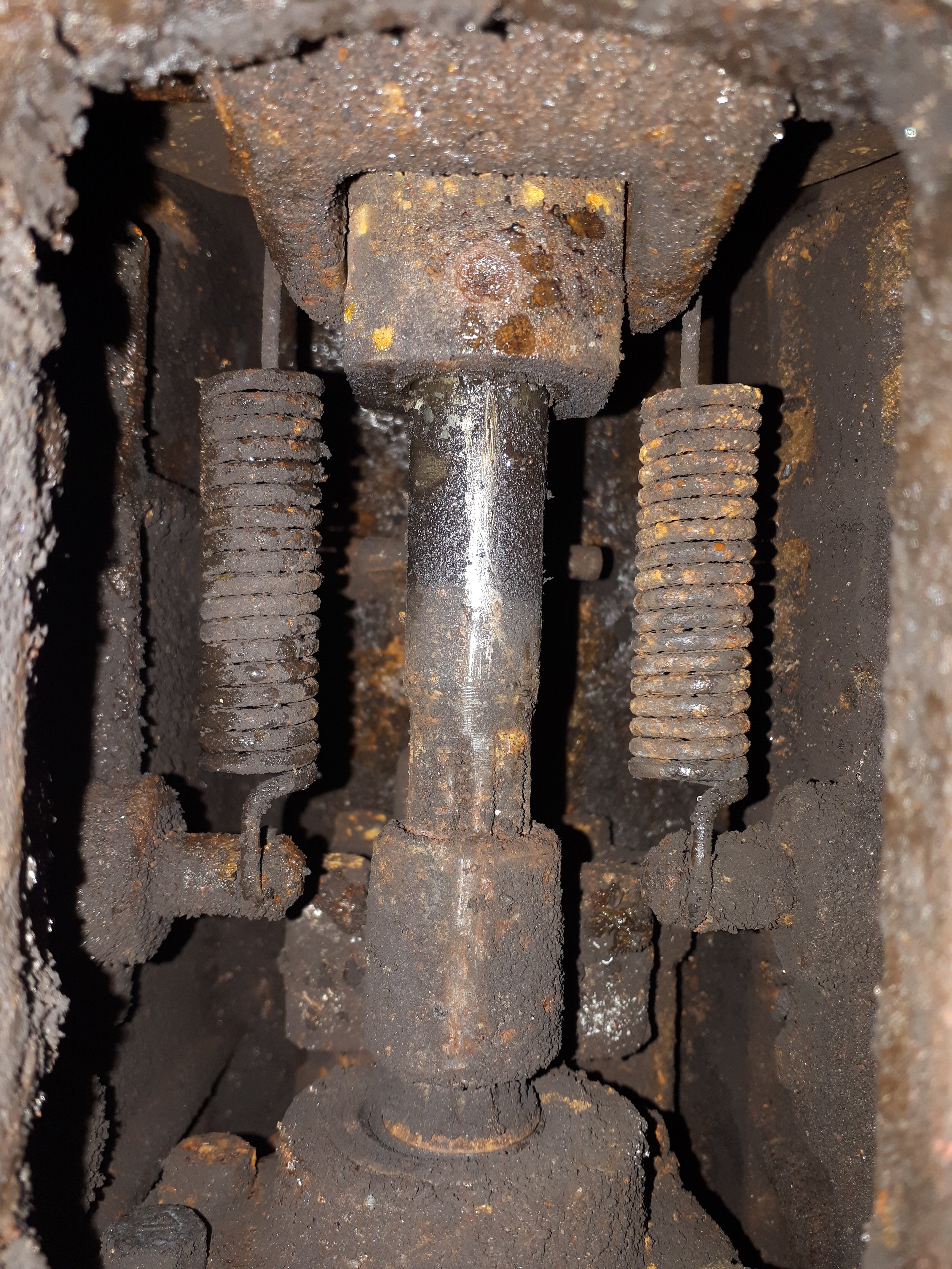

Sorry for the late reply . been really busy . Thanks for your reply and diagram .sorry i should have looked at it properly . i have taken the tractor apart and looked in at the linkage the diagram extactly right thanks .here a photo of it without the cover on
What do you guys think ? There are some broken bits of metal at the bottom and they don't look like they are from the linkage. it looks like it's pressing on the clutch alright . how would i know withoput spliting it ?

Yikes. That is a LOT of rust. You can get a better view up in there using a "dentist's mirror." It's a mirror on a stick, like the small round ones dentists use to look at the back of your teeth.
If and when you go to split it, I recommend rolling the rear back. This is only a ~2000lb tractor by the data I'm finding online so you should be able to do it with a simple floor jack, presuming you're working on concrete. You do not need fancy splitting stands unless you want to make them.

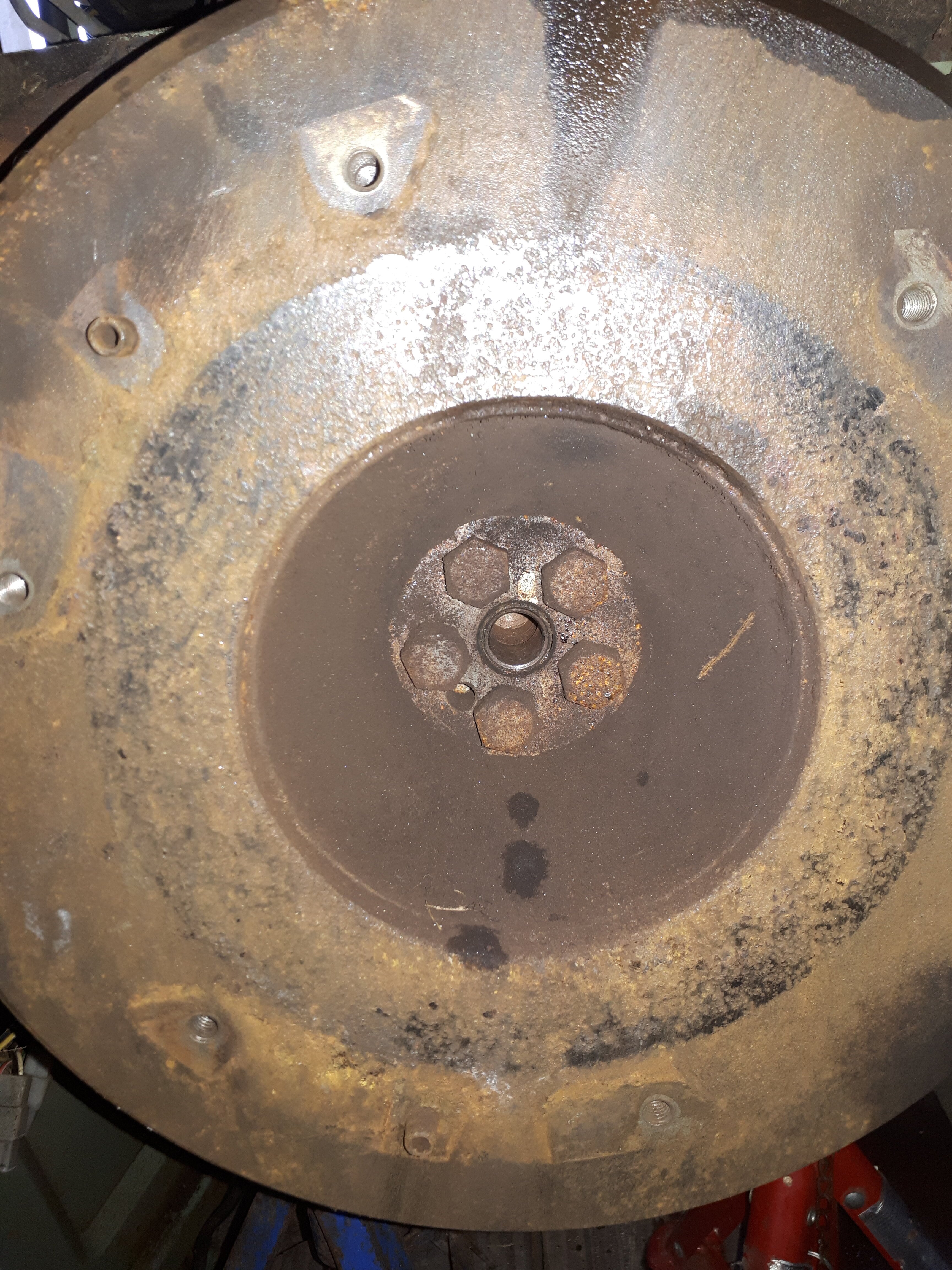

One more thing . after cleaning the bits off the flywheel from the disc there are little rust holes where the disc went , can i still use it ? here a photo to

Your flywheel has seen a bit of moisture in its lifetime. Getting info from tractordata, it seems your tractor is over 40 years old, so getting a new flywheel is also (probably) out of the question.
Ordinarily, the flywheel should be resurfaced by a machine shop when replacing a pressure plate and the disc. That is to minimize the chance of clutch chatter. In your case, I’d talk to the machine shop to see if the machinist is comfortable doing that. It looks like a fair amount of metal will have to come off to get it perfect and that tractor may not have a surplus of material when new.
How hard do you use this tractor and how hard was it to split ? It’s possible a new pressure plate and disc will fix it without resurfacing the flywheel, but it’s not how they fix it “by the book”. Then again, in my area, any machinist is over an hour away and is backed up for six months…
we use it to cut hay and topping every year so quit hard . but it was easy to split. ok i'll just wire brush it so all the rust is off and put it back together and hope for the best .
