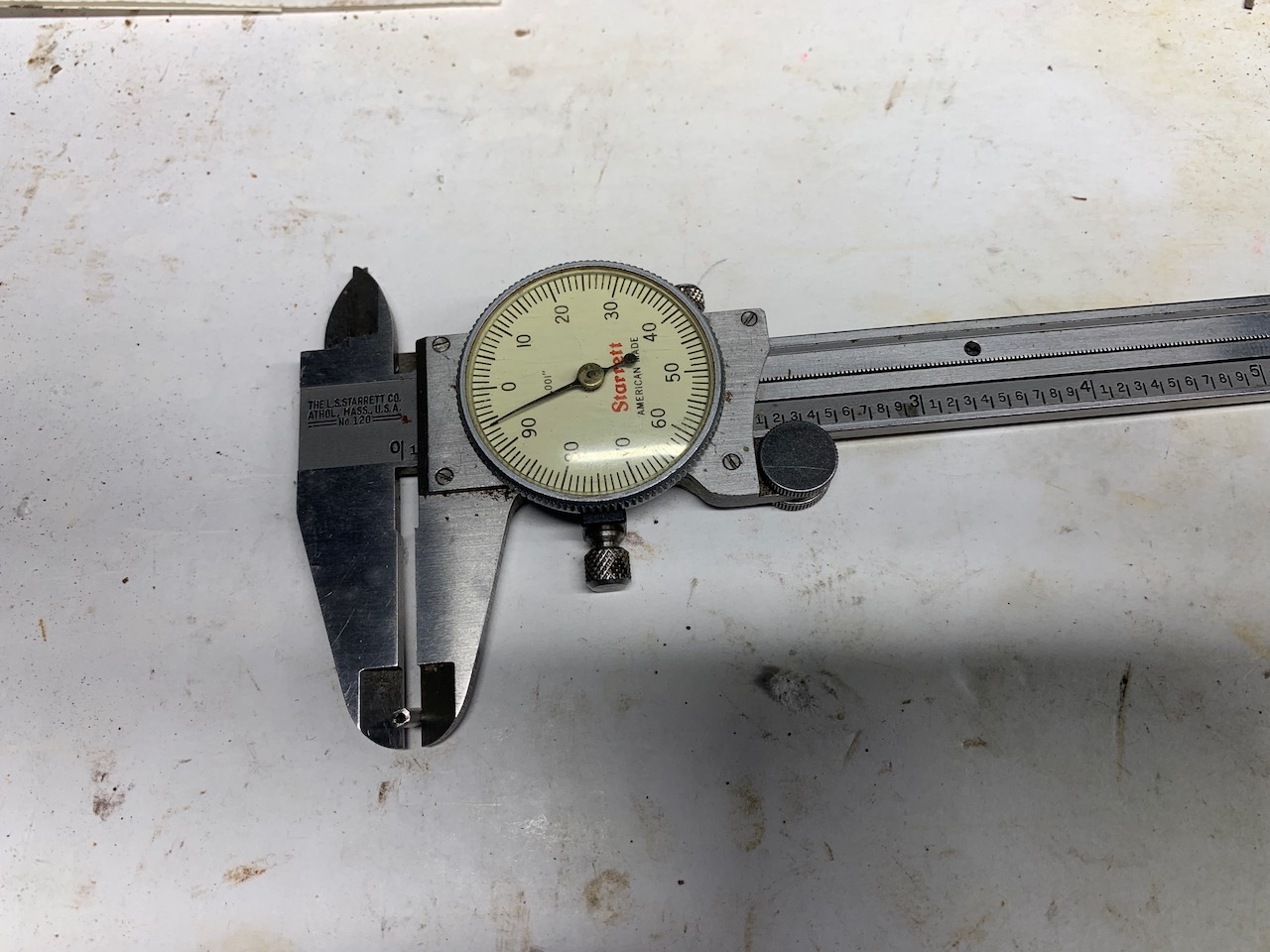

I just downloaded a TO-35 IPL, shows different part # for shafts, but towers/supports the same, as is the pin listed as 3/32.
Did you measure the pin or match it up? Might be good to know for correct reference.
BTW, nice looking tractor. Look forward to seeing a write up on the work.

Concerning the locating pin. Did you measure the pin, have an actual 3/32" or just match one up? One of the Ferguson IPLs must have a typo.
Thanks. Details you can't know about without having the parts in hand. I guess that passage is another thing to clean on a rebuild.
3/32" - mistakes do exist in the various publications. One of the most notorious is the instruction to torque the governor attaching nut to 85ft/pounds, which usually breaks the camshaft. (35ft/pounds is the appropriate figure).
