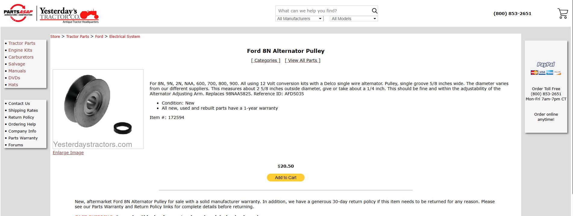

12 chane over 8n
You need to get a pulley for a 5/8" belt.
He needs a small diameter pulley for a 5/8" wide vee belt.
I would use an A cross section belt. There is no such thing as a 5/8 wide belt, a B cross section belt is 21/32 wide, that is 1/32 more than 5/8.
If an A cross section belt fits the alternator use it. Old engine pulleys tended to have wider vees than the belts actually need so that the belt fit down well into the groves. Newer pulleys are visually a bit smaller in the vee because it turned out that extra bit of diameter didn't help keep belts on. By trimming down the design they save a bit of steel when they make them.
A cross section belts are often labeled as 4L belts, both are 1/2 inch wide. Use them interchangeably. The difference to pay attention to is that A belts are measured by inside diameter, and the 4L system uses outside diameter, or vise versa. So mind the length. The difference between inside to outside measurement of length amounts to about an inch.
In the A and B system the length in inches is the number which follows the A, or B. For the 4L system the length of the belt are the two center numbers of 4 numbers which follow the 4L.

N tractors use a B belt. What you accurately describe as 21/32nds is standardly referred to as 5/8". I can produce countless citations from both manufacturers and vendors to support that reference. A half inch belt - your A belt - is wrong for an N tractor because it is too narrow for the pulleys on the N crank and water pump. He needs a B belt - the length of which will vary depending on the specific conversion kit he gets, because of the variety of alternator mounts. I ended up replacing the belt that came with my kit due to length issues. The one supplied forced me to remove all alternator bolts, including the pivot bolt, put the belt on and then bolt up the alternator. When that was done, the alternator was in physical contact with the manifold, something I didn't care for. So I got a longer belt. An A belt is wrong, every time. It is too narrow for the N pulleys and will bottom out in them.
It would be best to use the proper automotive belt to fit the crank and water pump pulleys. The OEM part numbers (9N8620B (5/8" x 45-1/2") and 8N8620 (5/8" x 41-5/8") cross to Gates belts that have a top width of 5/8". The angles will be different from letter series belts. Running a narrow belt in wide pulleys lead to wear, the belts bottoming out in the OEM pulleys and slipping. JMHO
I'm running a Gates B42 now. Never slips.
PS: don't want to get into a hair-splitting contest in terms of B belts versus the ones you described. I just know a B belt works fine and an A belt is simply wrong ;)
It doesn't matter if the A belt fits the alternator pulley, it will NOT fit the engine pulleys. That's why you replace the alternator pulley. (Jim, I know you know this already)
