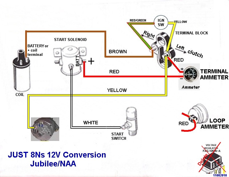

I have several tractors that use a resistor on 12 volt conversions and have seen other converted and every one had the resistor before the coil. I saw one today that had the resistor between the coil and the battery ignition. Is that an acceptable way to wire the tractor? Seems like the extra voltage from the coil through the resistor would make the resistor over heat or cut the voltage needed for the plugs. Tractor has ran that way this summer. This is on a Ford 4000 4 cylinder engine.

You have witnessed the fact that it "works" the way it is but I've never seen an example of the maker of the tractor or vehicle doing that. either the actual machine or a wiring diagram of such.
Introducing resistance between the condenser and coil MAY affect spark a little during the"'ringing phase" of the spark waveform.
Personally, if I owned it or was hired to work on it the resistor would get moved to the conventional/"correct" part of the circuit.

Charlie, normally, a ballast resistor is used between the ignition and the coil to reduce voltage, IF you have converted to a 12V system and retained the 6V coil. This has been covered in-depth over the last few months, so a search will find more information on the resistance to shoot for. Also, people have been known to use a resistor in the "excite" circuit to a 3-wire alternator. I prefer to use a diode in that circuit, so there is no chance of a slow backfeed drain when the tractor sits. So be clear on the terminology you use to describe the situation. I'm still not sure what difference there is in your description of the two methods. Sorry for any overlap, Wore Out got his reply done faster. steve

I agree. The coil is electronically operating with the condenser during spark discharge. I think there should be no resistance between them. In a series circuit it would not make a difference, this is an AC electronic interaction. Jim

Even if it still can "work" in either place I suggest the ballast be wired between the ign switch output and the coils input NOT between the coils output and points/condensor. With the points (in parallel with condensor) opening and closing theres some interaction with the coil and condensor and I prefer there be no added resistance in that circuit. Im talking about an ignition circuit coil and ballast here NOT in the charging system...

On a FORD 12V Conversion, the GEN and VR are removed from the circuit altogether to begin with. Many think you keep the VR but, NO, discard it. If you keep your OEM 6V COIL you will need to add an external 1.5 OHM Resistor or Diode to the circuit -SEE PIX. DIODES are polarity sensitive and have a band markling on end as shown. If you swap out the 6V COIL for a verified 12V COIL you DO NOT ADD THE EXTRA Resistor. ALSO, some confuse the OEM Ballast Resistor that is only used early N's with the front mount distributor as I being used on all circuits. Wrong. The OEM Ballast Resistor is required on both the 6V and the 12V setups with a front mount. After 1950 with advent of the side mount dist this resistor was eliminated. I advise to swap out your 6V Coil for a 12V coil to avoid any extra parts and wires dangling around. The DELCO 10-SI 1-WIRE ALTERNATOR is as proven performer and there is also a 3-WIRE Unit that will work as well. Whichever you use, a GEN or an ALT, be sure it has a fan belt tensioning bracket attached to keep proper belt tension set. Without it you will never charge the battery and also a loose or improper belt will affect the cooling system as well and possibly to the water pump. OEM 6V GEN came with a belt tensioner. ALT kits are not all equal and may or may not include one - check you supplier when buying.
