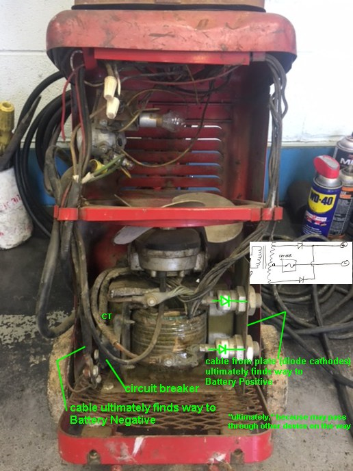

No button diode in this Marquett!Even these manual non microprocessor chargers with the
high amp ratings have a crutch in the fine print.
"Charging on boost---5 seconds on---225 seconds off
for cooling" A lot of these units have the button rectifiers
which are held on a heat sink by clips, so heat disipation
is iffy.
Jim
I have it's twin. They are built like a brick xxxxhouse!No button diode in this Marquett!
Yes they are….. definitely not today’s plastic, built to be replaced next year stuff. Mine, Dad’s, before me, still works fine.I have it's twin. They are built like a brick xxxxhouse!
