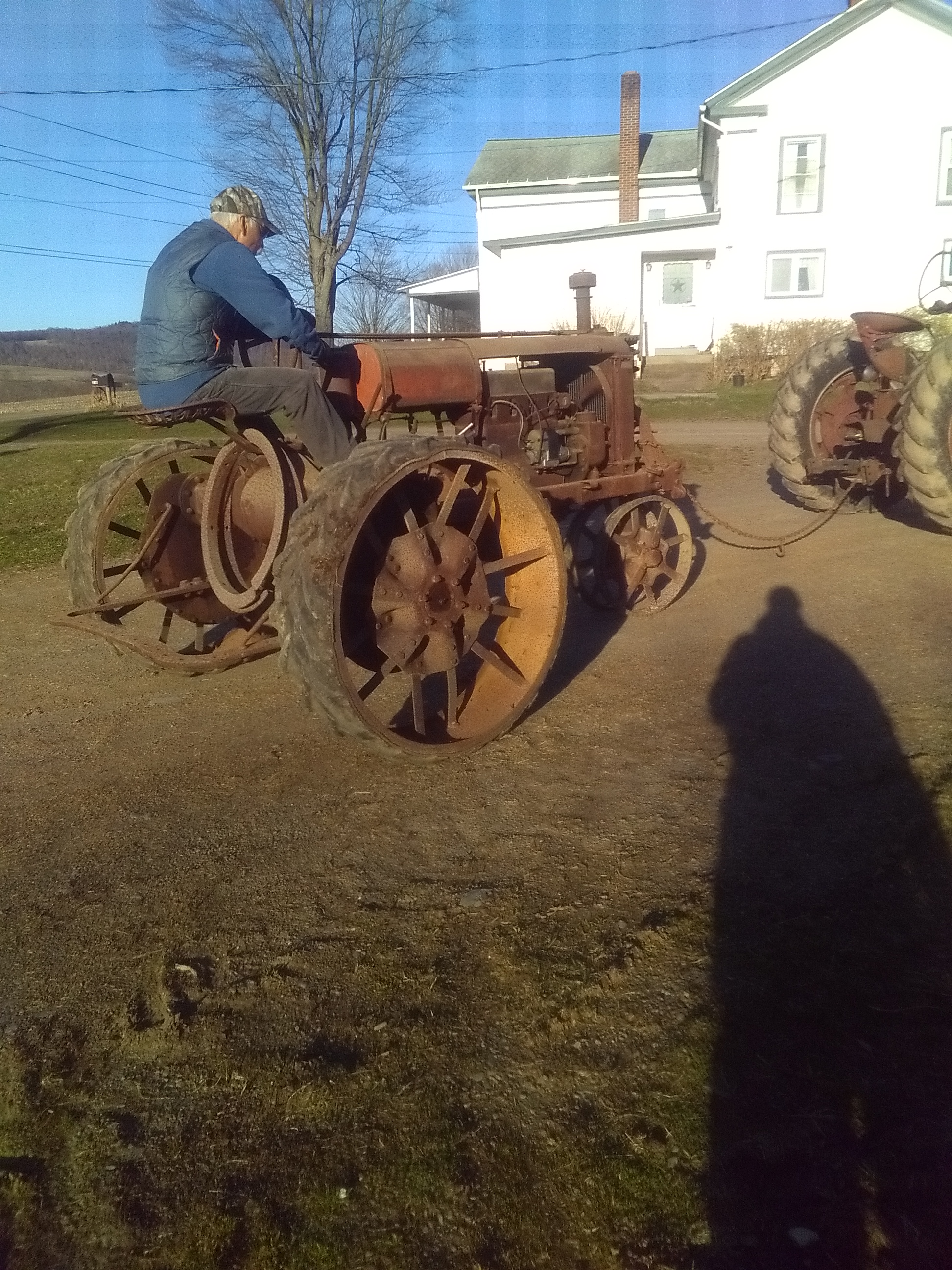

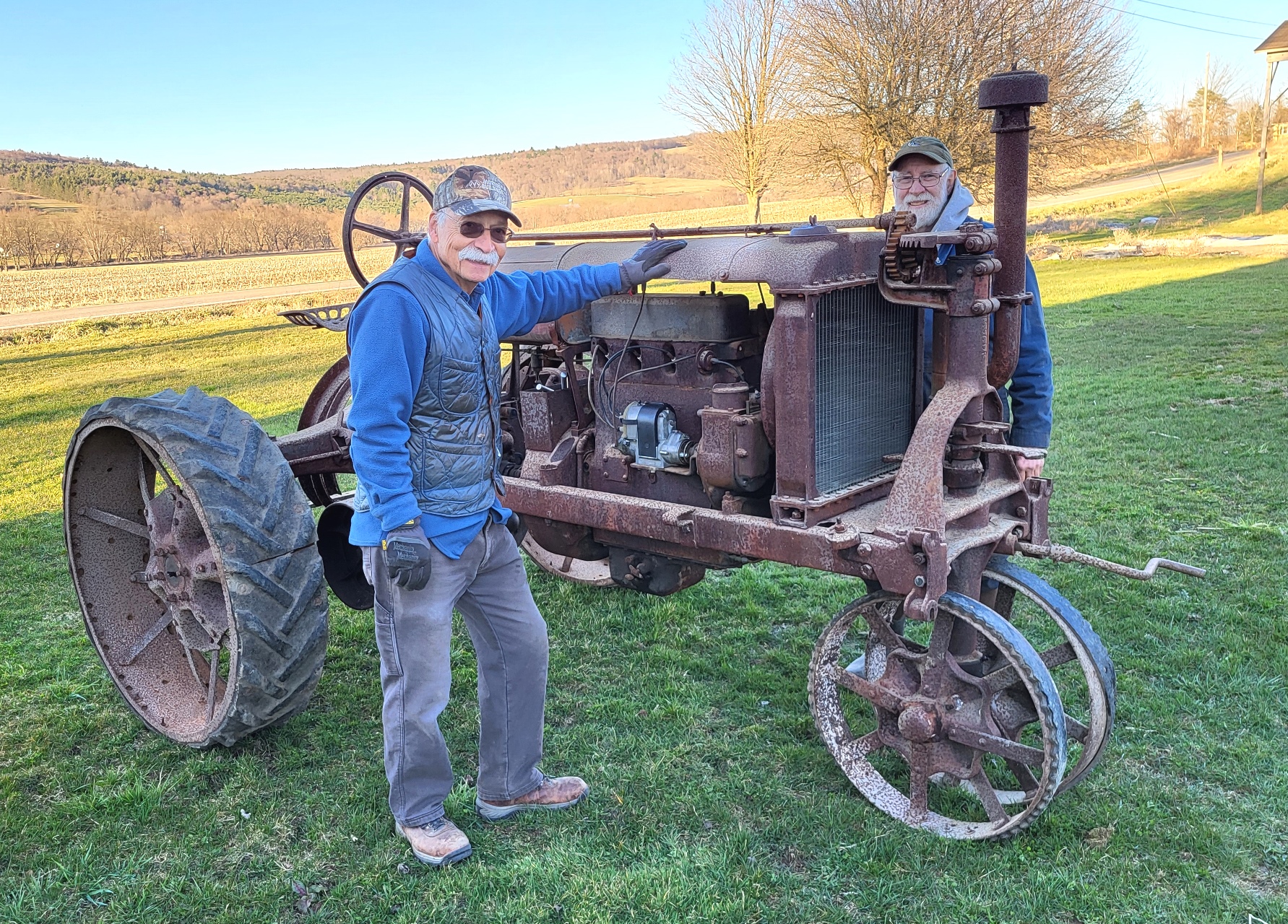

I have owned this 1929 Regular for about 20 years. I bought it with a rebuilt engine, but no magneto. it sat in my toybox all that time. I pulled 2 F4 mags off F12 parts tractors, a college friend resurrected the mags, and today we assembled one mag on the Regular and towed it about 200', when it came to life. Still doesn't want to start off the crank, but it ran very smoothly. We had to change the gas tank and valve cover from another parts Regular to get good usable ones. Also found that a gas tank from an F20 is about an inch higher than one for a Regular. A very satisfying day, and thank heavens for my friend Mike's mechanical abilities in getting the mags working again and timed. Note the steel trim rings hanging for extra weight on the seat spring. Still a few things to tweak but still good.
