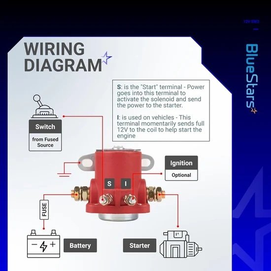

Need some help with wiring. Put in a new key switch and starter solenoid. Its no longer starting. Pin 1 comes from battery 2 and 4 isn't used 3 goes to battery side of solenoid along with coil wire. Pin 5 goes to neutral safety switch then it goes to the starter side of the solenoid. What did I do wrong

From the instructions picture you posted and your description you have a gas engine, not diesel. You mixed up terminals 3 and 4. #3 is for a thermostart or an ether injector on a diesel, not used on a gas engine. #1 should get power from the battery cable post of the solenoid, not #3. The wire going to the coil belongs on terminal #4.

Did you follow the solenoid wiring in the picture below?
You might have a wire going to the + side of the coil on the I terminal of the solenoid, if the tractor had a resistor bypass in the ignition circuit, no wire there if it did not.
Is the solenoid mounted to a good ground? The base is the ground point for the coil inside the solenoid and must be grounded.

Starter and battery is switched

Battery and starter are switched sides the S terminal has the neutral safety switch the I terminal has coil wire and a wire running to the key switch.
I do not have a 3000 wiring diagram at hand but I believe the wire from the switch #4 goes to the coil + terminal. The I terminal would often only have the one wire going to the coil + terminal. If the wire is from the key switch #4 terminal goes to the I terminal of the solenoid than the other wire goes from the I to the Coil + terminal, it should still work.
I also suggest moving the battery and starter connections to the posts shown in the picture.

Should I only have 1 wire coming from the key switch to the solenoid? If so would that be going through the neutral safety switch? This tractor has been a wiring nightmare since we got it. So neutral safety switch to s side of solenoid an to the #5 pin of key switch. Then coil to the I terminal and to the #4 pin of key switch right?

Normally there will be one wire from the Battery cable post of the solenoid to the ignition switch to supply battery power to the ignition key switch (#1 terminal). That wire may be connected to the ammeter, if equipped with one, before it goes to the key switch. Then there will be the wire from the neutral safety switch to the S terminal of the solenoid, to engage the starter and crank the engine to start.
I would run the wire from the #4 key switch terminal direct to the coil + terminal, not the solenoid I terminal.
You should get the correct Ford service manual for your 3000. It will have the factory wiring diagrams in it.
