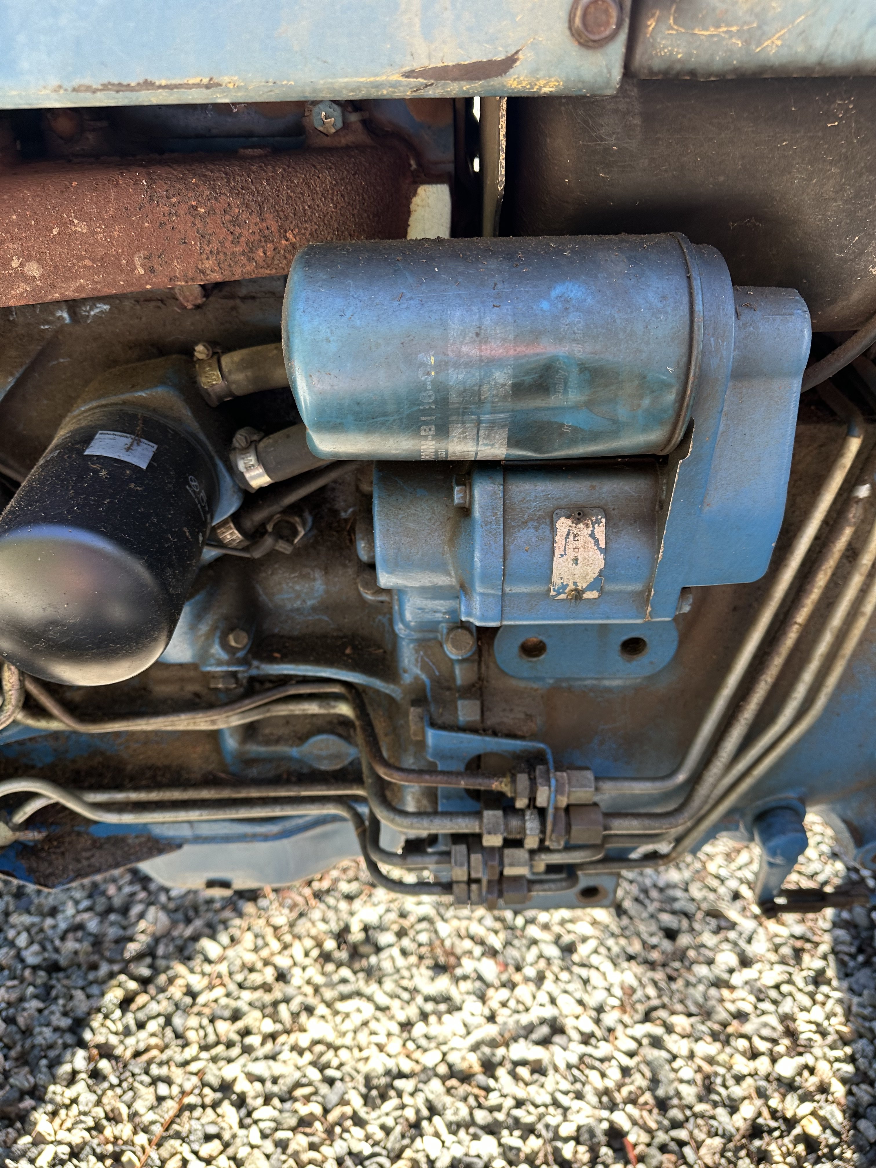

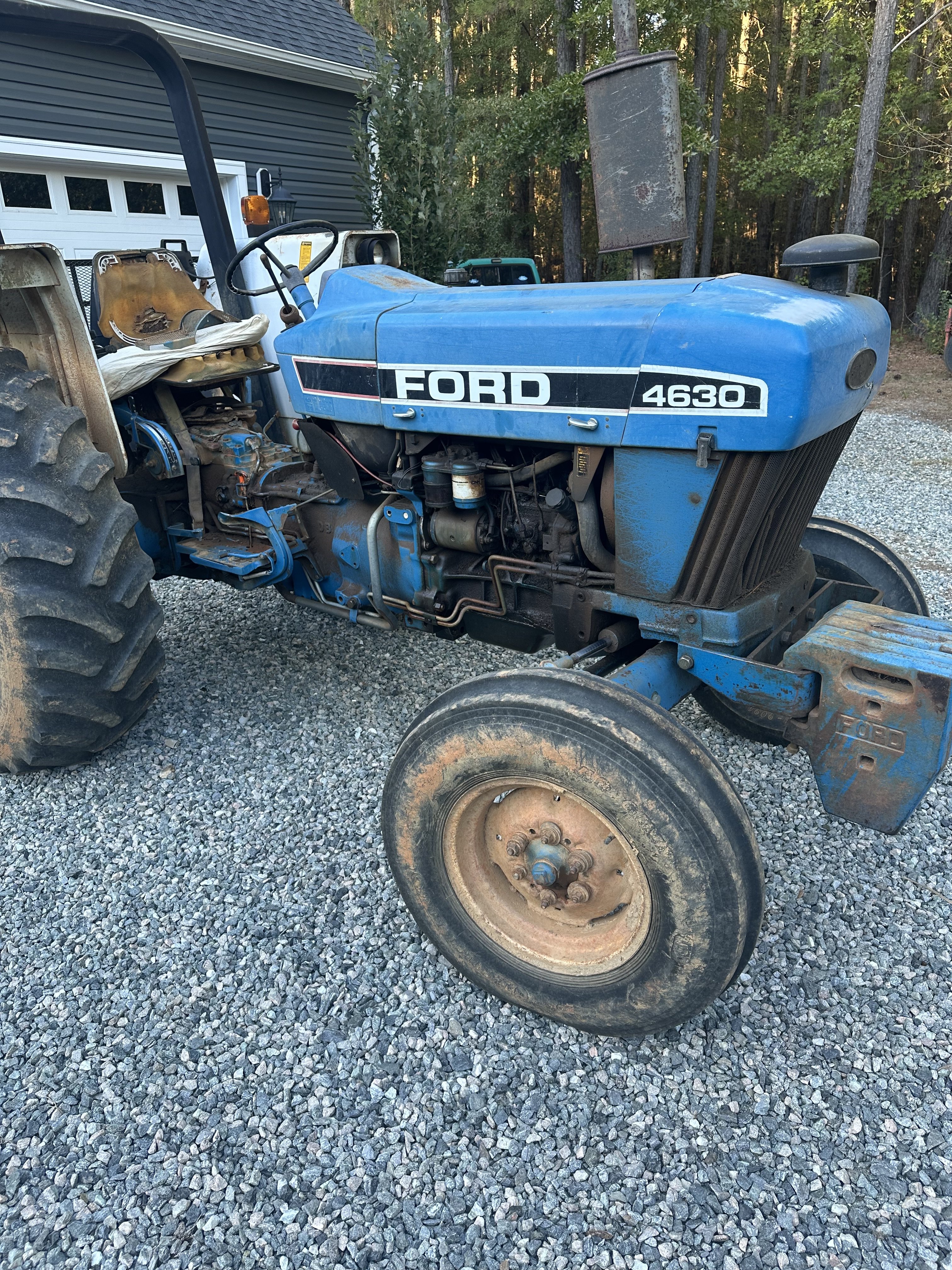

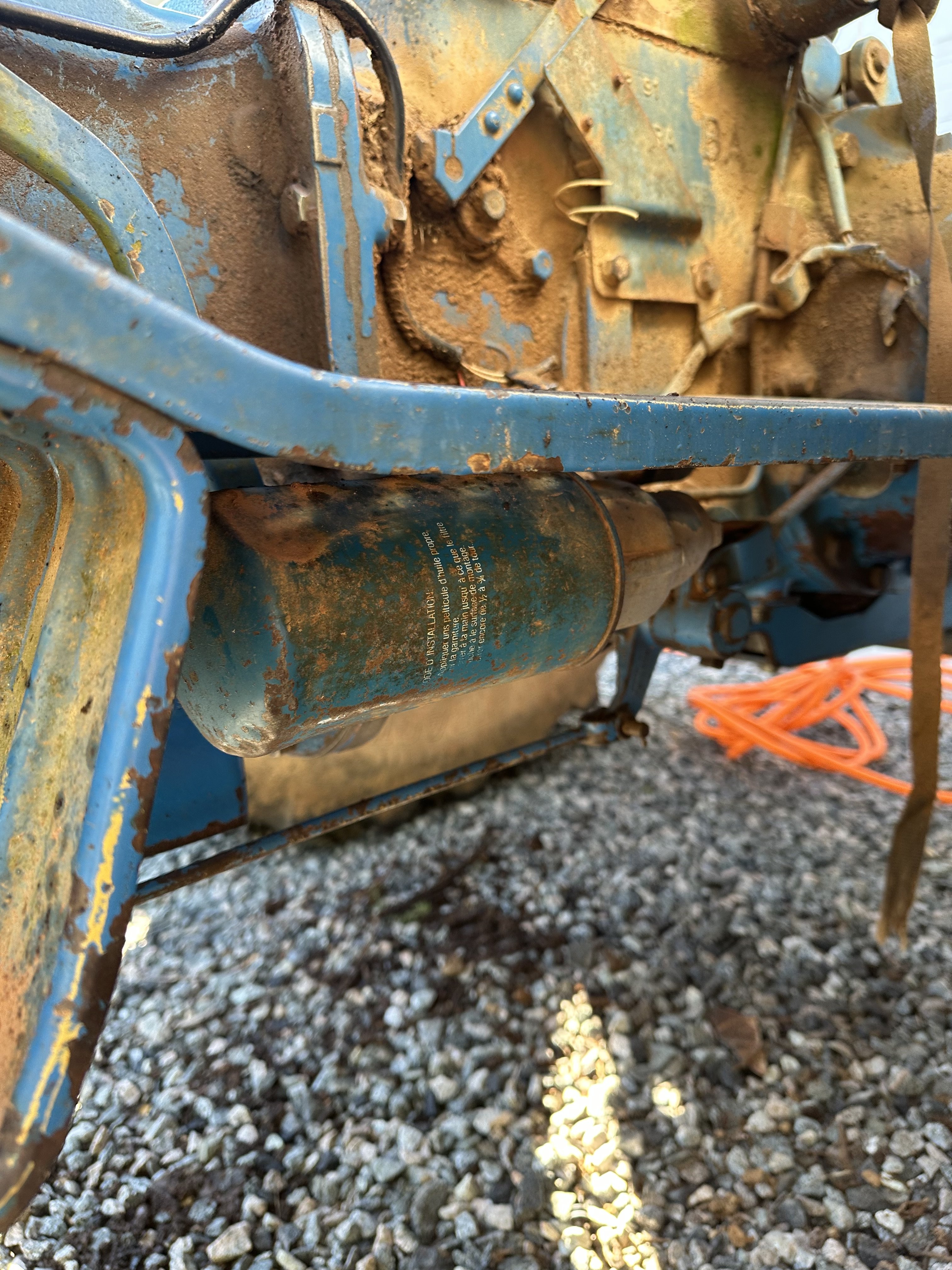

what to use for power steering fluid? Also went to look at one for sale in decent shape with 700 hrs on it and all the fluids look fine but it doesnt have any coolent that i can see in the radiator . it fired right up though . just fired it up and cut it off . going back today and fill it with antifeeze and watch for leaks. what would you guys do. in this situation.

I really like these tractors but if it has the 8x8 transmission with forward/reverse on a separate shifter I’d walk away
Good transmission when it’s working, zero parts availability when a synchronizer fails
If it has the standard 8x2 transmission buy it
Don’t trust the hour meter on a Ford tractor, look at the tires
700 hrs the rear tires should be original with 75% thread or better unless it’s been drive on paved roads a lot, Armstrong/Titan was the tire supplier around that time with long bar/short bar thread design. Even the front tires should be original with good ribs still, Armstrong or Firestone fronts
Went and drove the tractor put one gallon in and it came to the top .. brakes felt like they weren’t releasing felt a drag ..hole was rub in top of radiator from the air inlet pipe ..hr meter did not work. ..ran good though gears work hydro work power steering work ..I would rate it a 7 out out 10 .condition wise. ….intros the guy I would think on it. Oh yea when I release the clutch when out of gear i heard a wining noise ..sound like a bearing idk
