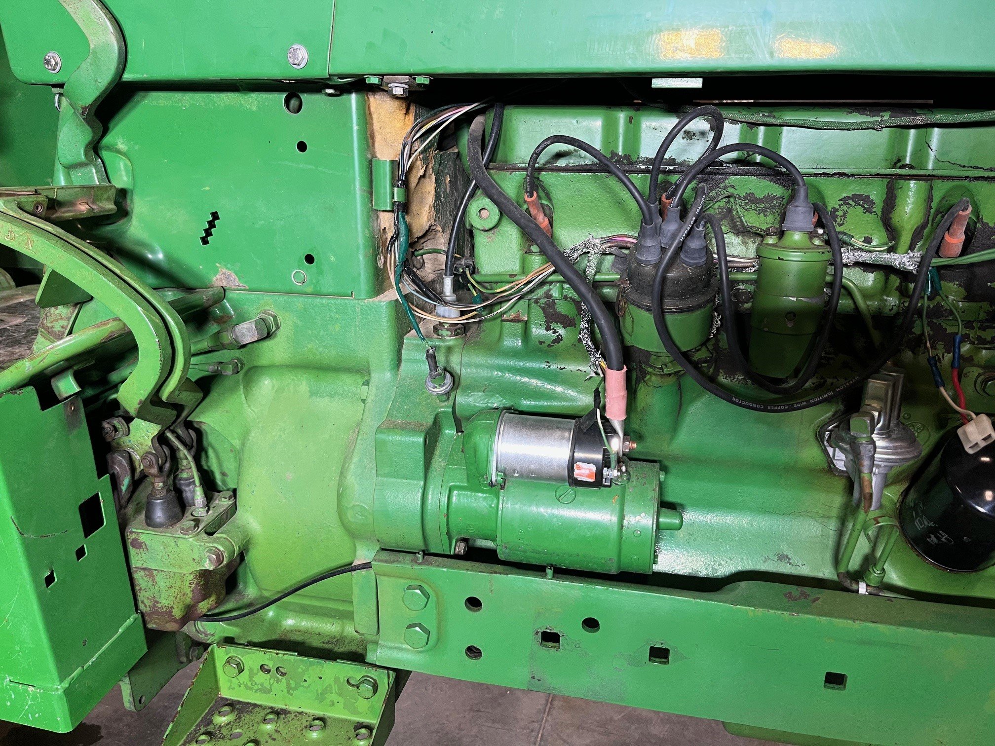

I have a 2520 that after sitting will not start with the starter button. If I jump across the solenoid (even momentarily) then it will start fine as long as it is started regularly,(every few days). If it sits, it will go back to needing to be jumped across the solenoid.
It appears to have a new solenoid on it, so I imagine the previous owner was having issues as well
Any ideas?

I'd have to check to be sure, but I think there might be a little relay remote from the starter which energizes the starter solenoid. My 2520 did not have a starter button like the 2510 did. Key switch did it all.

As Jim said check all wires and connections and be sure they are clean, mine did the same thing and it can be something you would never suspect.

So after getting a minute to dig deeper, I am only getting 6v to the S side of the starter solenoid and the coil. (12V at the alternator / other keyed accessories). The wire supplying the 6v gets very warm with the key on and engine off.....once the engine starts, it cools down.
What would cause the voltage drop?

What’s the coil wire have for voltage to it? There is a resistor I believe on some 20 series attached to the actual key switch because a 6v ignition coil is used even though the tractor is 12 had an 2510 and 3010 wired similarly and thats where they add the resistor it’s a bit different than some tractors where the resistor isn’t too far from the coil inline. That would be 6volt exactly. Is it possible someone wired the starter wire to an ignition terminal accidentally or ??? And might have enough juice to spin the starter while the battery is fully charged up after just having ran.
Are you sure you are not reading the “R” terminal voltage? The S terminal will only have voltage when the start circuit is energized by the key. I think it is very possible that the wire is getting warm because it is supposed to because it is being used as the resistor. IH tractors that also used Delco Remy electrical systems did this in that era as well. Now I am not a 100 percent certain Deere did this but I think it is a good chance. Everything Fixing Farmer said likely applies to your tractor. The R terminal is energized by the starter solenoid when cranking. This energizes the 6 volt coil with 12 volts to allow a hotter spark while cranking. Then the engine starts and the R terminal is not energized the voltage to the coil is reduced by either a resistor or the length of the wire in the harness. Sometimes in some applications a length of wire was actually added in the harness and it doubled back to get the proper length to provide the correct resistance. You need to make sure you are testing voltage on the “S” solenoid terminal when the key is in the crank position. I don’t think the low voltage you’re seeing on that other circuit is a problem.

This makes sense in regards to the resistance wire. The wire has obviously be altered in the past.....would a new wire from the harness to the coil with an inline resistor be an acceptable replacement?

The S terminal should only see battery voltage when the key is turned to start.
The R terminal is the one that would see ignition voltage (this can be less than 12 volts if the switch has a resistor on it or there is a resistance wire between the switch and the R terminal) when the key is on (run position), provided the wire for the ignition runs from the switch to the R terminal and then on to the coil.

Times 2.. refer to Jim’s picture in reply 12. When the “S” terminal gets voltage the starter should engage. This should only happen when the key is turned to the crank or start position or the start button is pushed if that is what it is equipped with. The “S” terminal connects internally to the electromagnetic coil in the solenoid that when energized pulls magnetically against the solenoid plunger to engage the starter drive and close the contacts to energize the starter motor so it turns.

You post telling the S terminal has power when the key is on is misleading. To be clear. The key has to be on for the start button to have power. However, the solenoid only sees power when you push the start button. That is not the same as the S terminal having power when the key is on, which most here would understand as the S terminal is energized whenever the key is on.
And the solenoid is only seeing 6 volts when the starter button is pushed. It has no power if the start button is not pushed. Is this, correct?
If so, you have bad contacts in a switch, wiring connections, or a bad wire. Only having 6 volts when the start button is pushed, instead of battery voltage tells me something is causing high resistance, and the wire heating is a sign of that.

Correct. The only time I have voltage on the S terminal is when the starter button is pushed with the key on. I am however only getting 6v. I installed a new wire to the coil in place of the resister wire (will need to install an inline resister) and am getting 12V to the coil with the key on.

Jim, Key on, no voltage at S terminal, Key on and starter button pushed = voltage at S terminal (6V)
