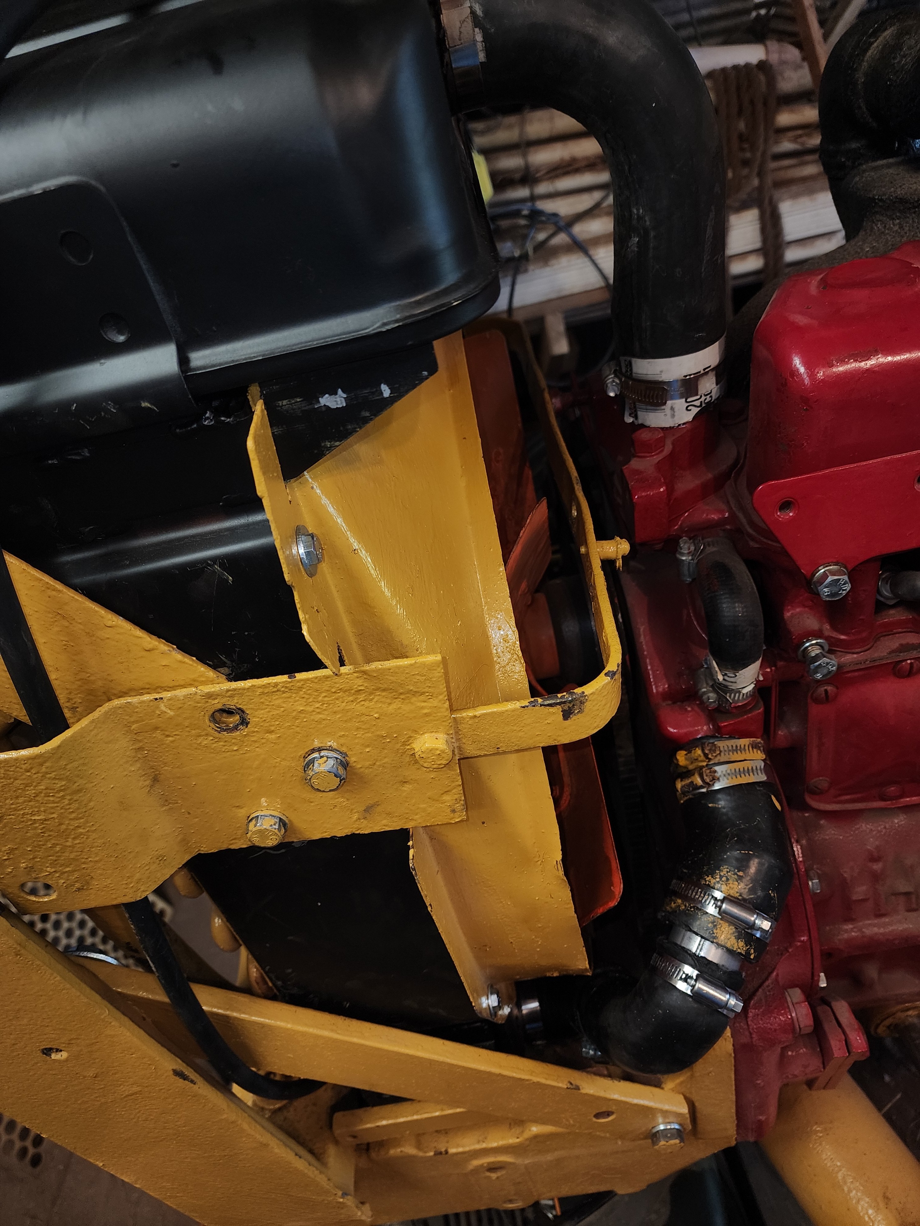

Got my new $209 chinese made radiator installed today. It sold as a replacement for a IH Farmall 504 gas or diesel with an IH number 377090R92. The junk dealer had said a 460 utility or 560 or 660 would also fit and Barnyard says a 606 would fit too. It fit right in and the fan shroud bolted right up. It had welded nuts on the inside so the front guard and rear guard bolted right up. It had brackets so the oil cooler line clamp bracket bolted right up. The oil cooler on the original one seemed to have offset screws holding it and I ended up setting it on the bottom shroud bolts with washers holding it tite and make a couple 2" brackets to hand down from the top shroud bolts to hold it in place.

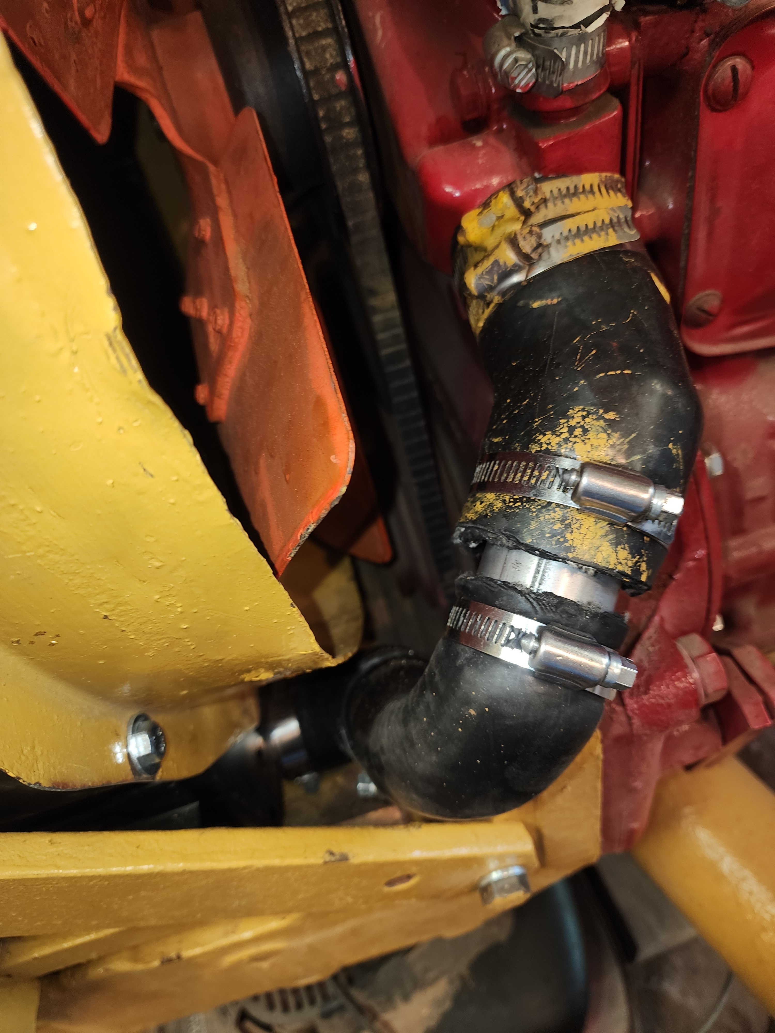

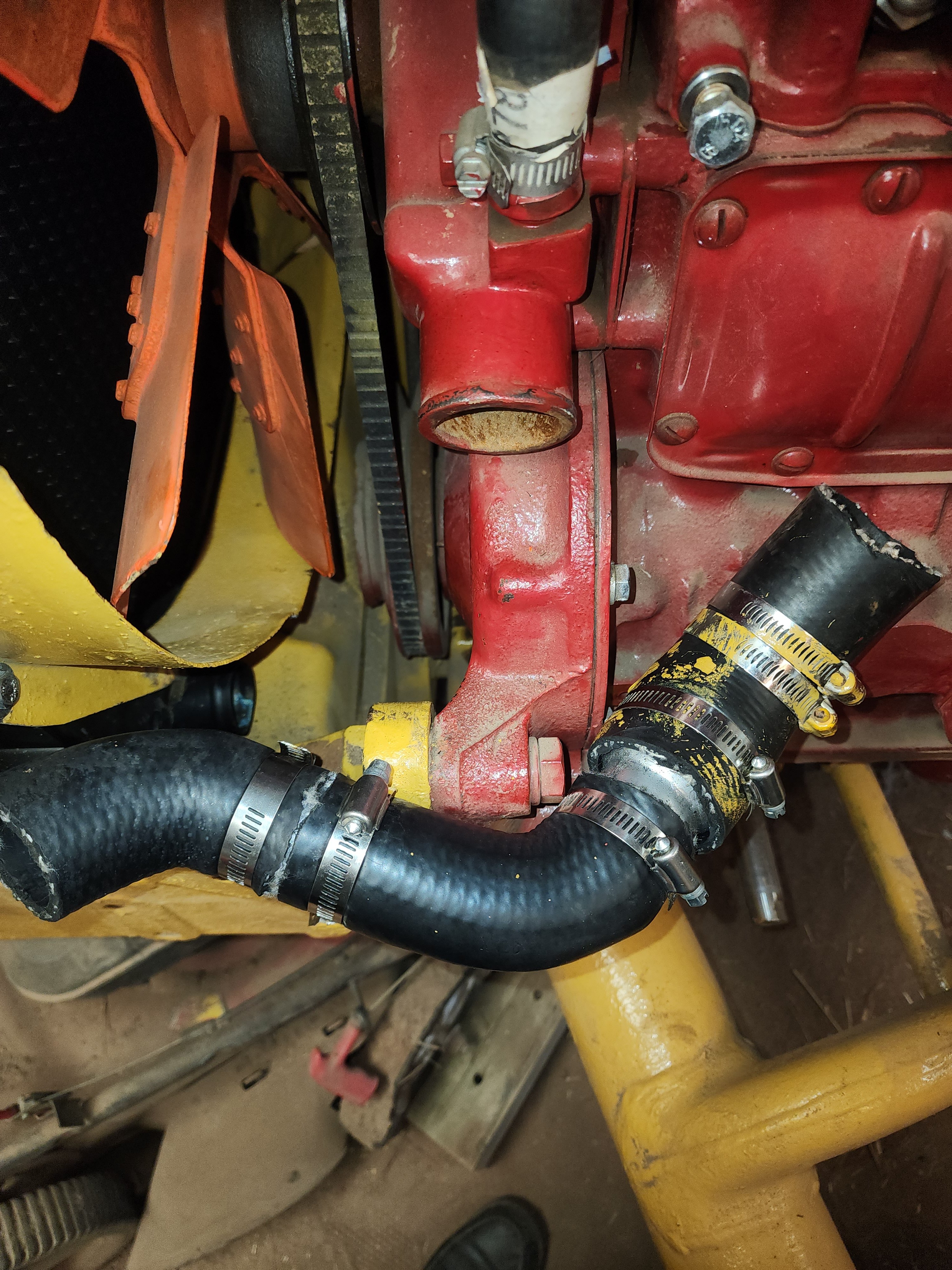

The only issue was the bottom 1.5" outlet that stuck straight out and my old radiator had a cast iron 2" outlet that angled up and out. After trips to 2 different parts stores in 2 different towns I ended up with a 1.5" Z shaped hose, a 1.5" connector, and a 1.5 to 2" adapter. Took a bunch of cutting and fitting but finally got something that I hope works. It is a tight fit. Pics below.
The only question I have on the radiator is where the rear bracket is close to the water pump support bolts where the top hose goes on. Looks like something must have been there but I don't know what. The radiator bracket only has one hole that is offset so it doesn't screw on to the bolt on the water pump. Is there supposed to be something else there?

View attachment 70415View attachment 70416View attachment 70417
That will work well for a radiator. Good luck with the electrical. Jim
