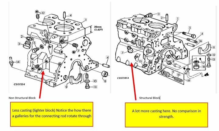

Which block, Structural or Industrial? A tractor should have a structural block as it is a structural member of the tractor. Industrial blocks mount on frames. Not saying an Industrial block will not work, but should have the side plates on the tractor, even if the tractor does not have a loader.
