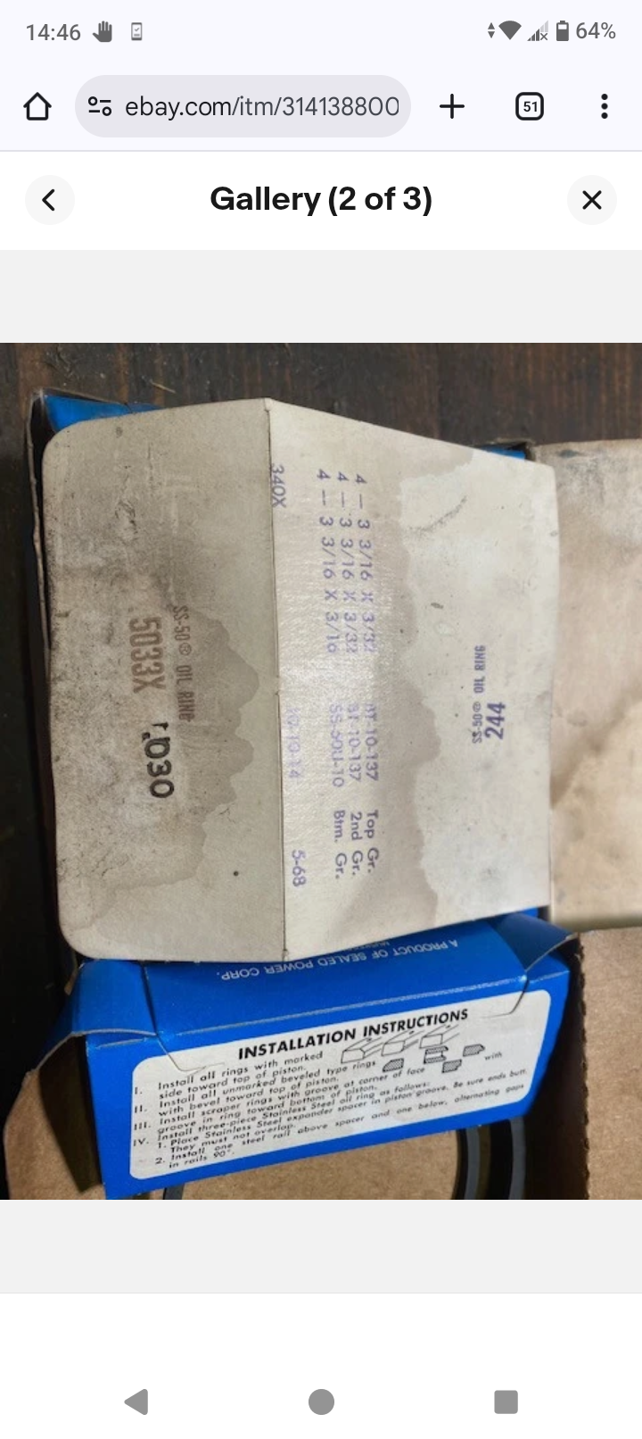

Duner, thanks for looking up the piston rings. The compression rings are right but the oil control rings on the tractor are 3/16 while the rings on eBay are 5/32. I know there’s gonna be some rings out there somewhere just have to track them down.

Screenshot_20260207-144625.pngAre these incorrect? .030 over 3 3/16. Oil ring width is 3/16.
