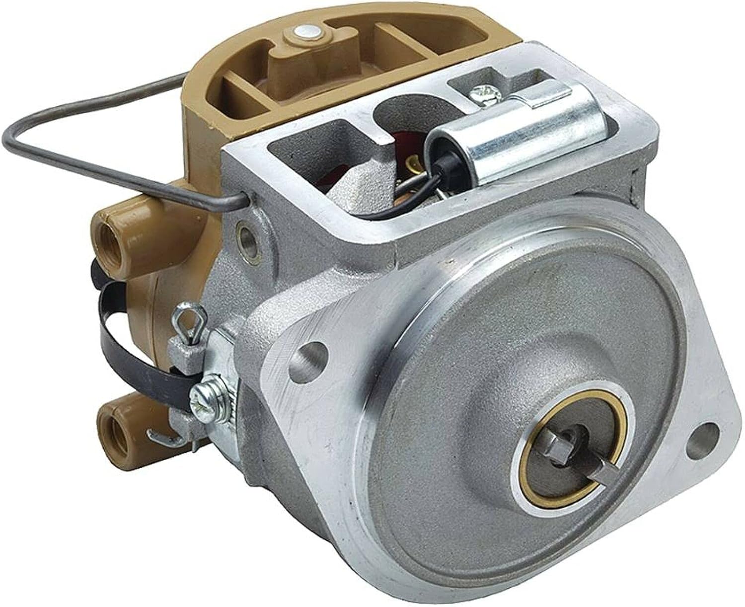

You could easily have an older engine in an 8N. Does the distributor look like this? If so, that's a 9/2N dist. You can put the older distributor in an 8N engine, but the question that comes to mind is why? An engine like that in an 8 generally equals orig 8N engine gone real bad, this one was handy.

You could easily have an older engine in an 8N. Does the distributor look like this? If so, that's a 9/2N dist. You can put the older distributor in an 8N engine, but the question that comes to mind is why? An engine like that in an 8 generally equals orig 8N engine gone real bad, this one was handy.View attachment 95194
Yes i have that style distributor
Early 8N models also have the same front mount distributor.
Early 8N models have the front mount distributor also.
