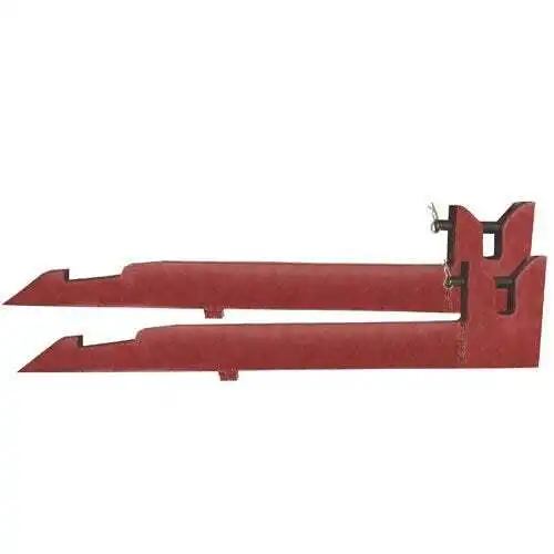

I found these Vintage IH adapters about 15 years ago. They are sized for Cat 2 pins, so the need for the bushings.

I am 67yrs old and I have been hooking up fast hitch stuff since before I can remember in all kinds of places. But I do try to always unhook somewhere reasonably level. And keeping the prongs lubed helps. I absolutely love it- easy-peasy. The only thing I get off for is to hook up a PTO, or mower chains. As far as 3pt stuff, I made some adapters that work but I mainly use on a spinner seeder or something light. The style that Cub 149 illustrated is the best kind- it works like those 3pt quick hitch adapters they sell- back under and lift up. My bigger tractor has 3pt and it is harder to hook up. Mark.
Cub149 -- YES That is similar to what I was thinking about making/modifying. I was thinking of a bolt across the top to close the hole. I can weld one up. Great minds think alike.
Anyplace I could buy something like those?

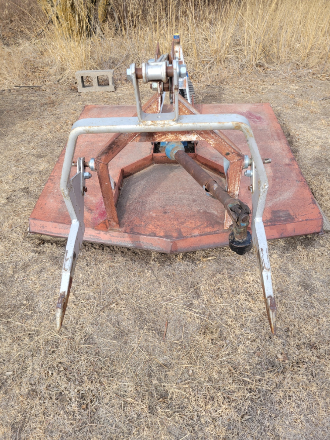

This is what I have for my Super C. It appears to be made in a mfg. plant instead of home-built. I got it out of a throw off lot that a friend of mine has for all the IHC tractors that he has. He just let me have it. I had to cut the prongs down to the smaller size.
Any time I've ever seen one of those sell at an auction, a fist fight usually breaks out. You owe your buddy about $300, LOL.
