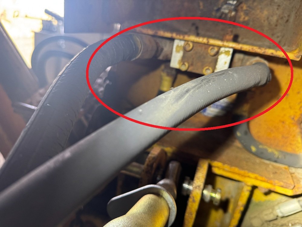

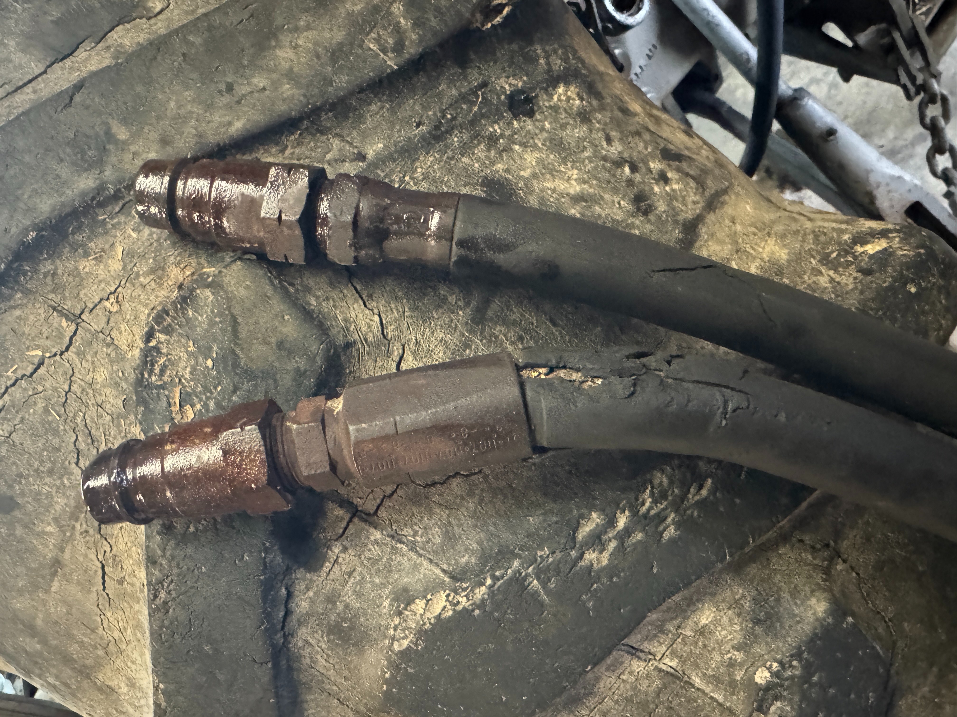

What is going on with this hose? Take a photo of it from above or better yet unplugged. It takes a lot to kink a hydraulic hose completely shut but stranger things have happened. View attachment 140400
The hose you have circled is just in horrible shape as are most of them. I have changed out several hoses but I've got more to do. So, after I compared the ends, I see a difference. Is that the problem? Are those not the right hose ends?
You don’t show the ends of the BH hoses. It looks like it might have the pointed tip style instead of the balls. Sometimes that can be a problem but I have also seen them work for years being mismatched. Screw the ball type loader couplers on the backhoe hoses and see if works then. Are there any marks or indicator letters on the hoe valve that might tell you which is supply to the hoe and which is the return?

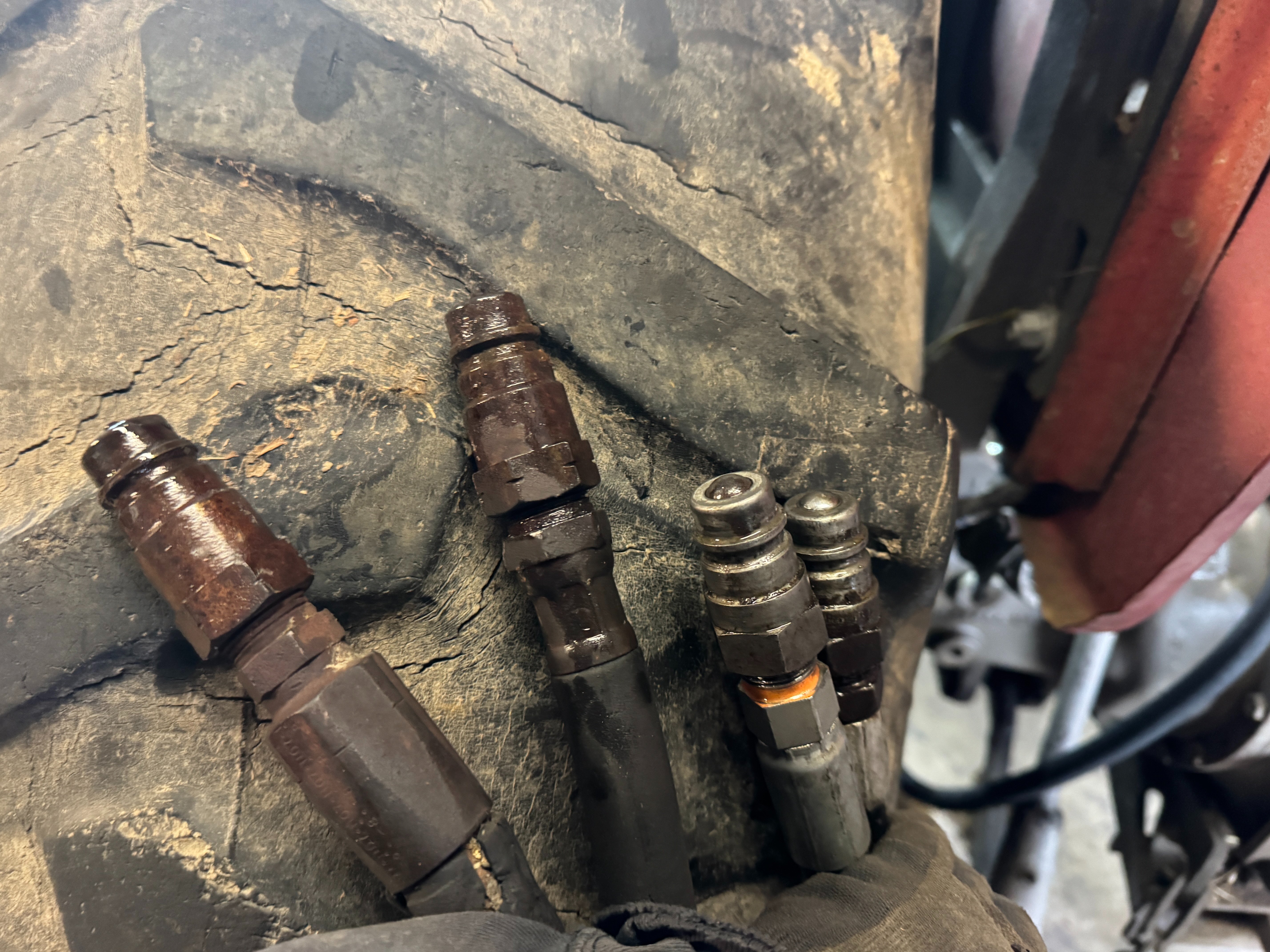

Why not get the new hoses and a pair of new male coupler ends. They should be the standard 1/2" Pioneer type ends, with the appropriate thread bores for the hoses.

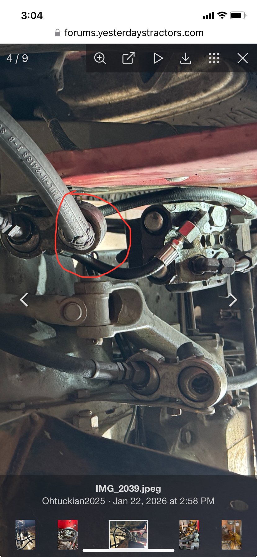

It looks like there is a block under the front of the backhoe that the 2 hoses attach to. Need to figure out if that is just a junction block or if it is a valve of some sort.

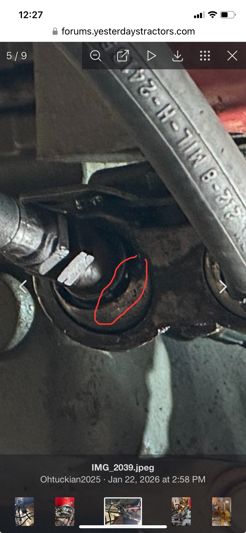

The hose under the circled one doesn't look like it is fully installed.
Looking closer I agree. If the area I circled in this picture is showing the ball bearings that are supposed to seat in the groove of the male coupler tip then that sleeve in the coupler is not slid into the proper position. Those back hoe hose tips need to be buffed off with a wire wheel or cleaned off with emery tape.
Ohtuckian, I think he is referring to the photos in your first set of posted photos labeled 2028 & 2029, are the hoses coming back towards the camera in these photos the ones you connected to the tractor? If so where do the hoses go that point down out of that block? Do they go to the single connections on each end of the BH valve block as circled here?
I believe it is a junction block that the manufacturer put on the backhoe to give an easy place to attach supply and return hoses between the tractor and hoe rather than going straight to the hoe control valve. The way the hoses loop down and towards the hoe valve and the hoses coming up to each end of the control valve matches that routing. And the two black hoses are the two hoses to the tractor remote couplers.

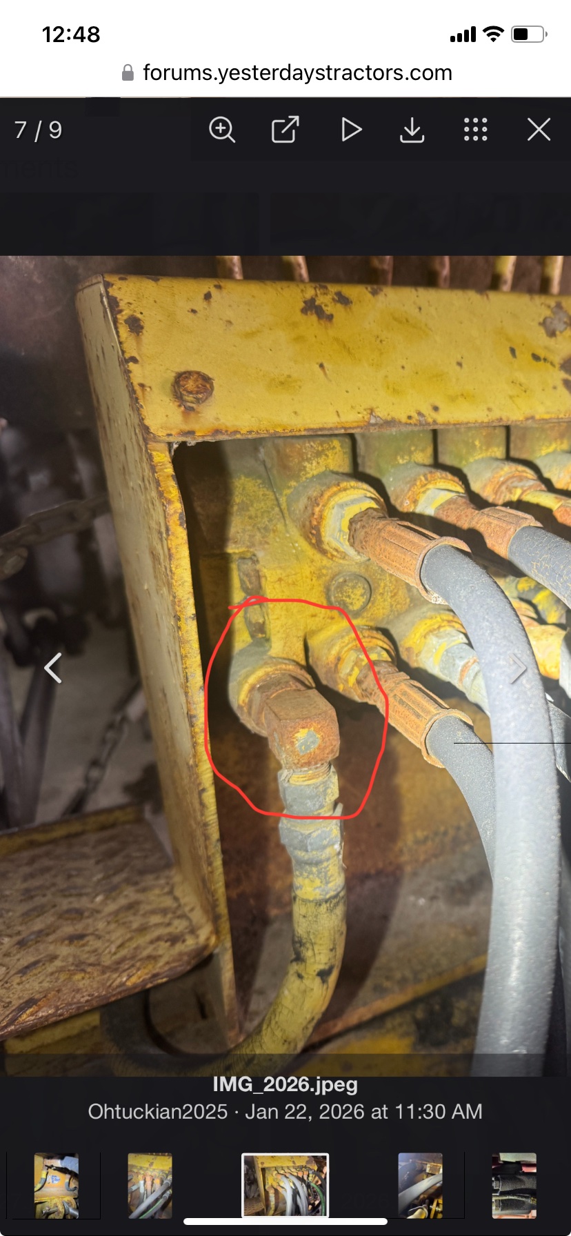

Which end block of the hoe control valve has the main relief valve in it? That would be the one that should get pressure. The one without the relief valve would be the return to the tractor. If you don't know take pictures that show the top of the control valve where the levers attach to the spools and the bottom of the valve bank behind the hoses. Those areas are blocked from view by the cowl and hoses in all your pictures of the hoe control valve.
Just to confirm. I am understanding you are using the two couplers that you have the hoe plugged into in these pictures to operate the double acting cylinder of your loader and the other single remote to operate the lift cylinders. And the loader hydraulics function properly when connected. Is that correct?
If that is correct, I have to believe there is an issue with the male coupler end(s) and/or hose(s) between the tractor and backhoe. Given the condition of at least one of those hoses I stand by my earlier recommendation of replace those two hoses and the male coupler ends on them. I think that area needs to be corrected before proceeding.

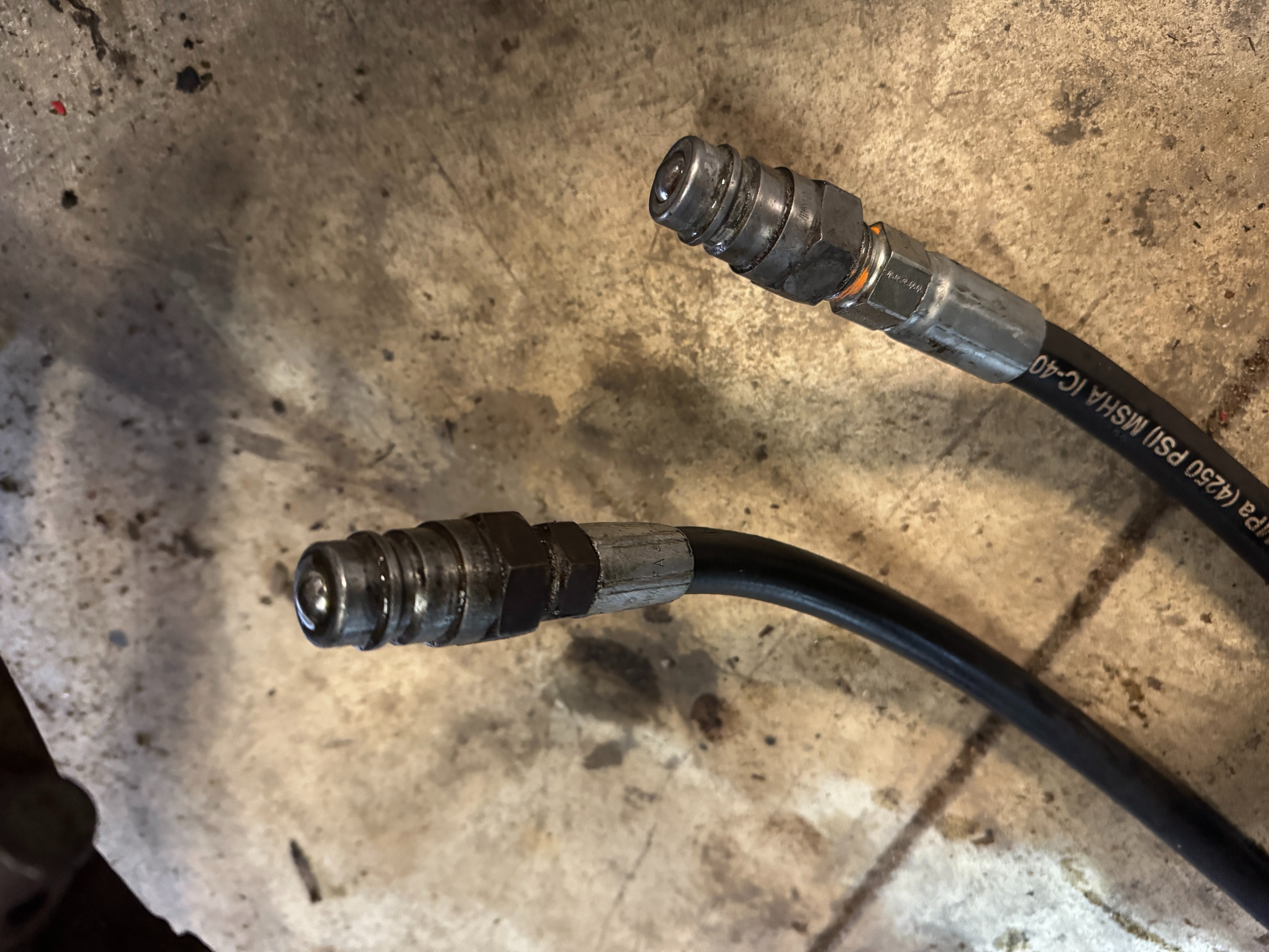

Yes, sorry about that. The hoses for the backhoe have a pointed depressor and the hoses for the loader (on the tractor) are a smooth ball. I'm going to unhook the hoses from the backhoe valve and see if they're even getting fluid. I didn't think that would matter, but after all the suggestions on here, I'm going out to try that here in a little bit.
