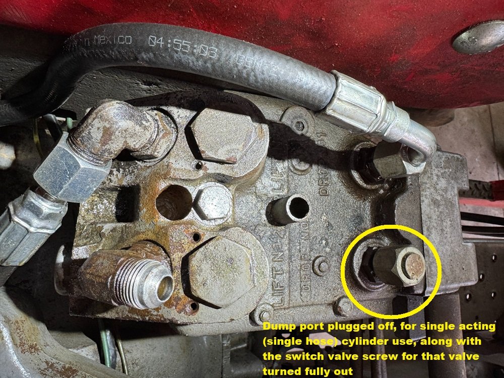

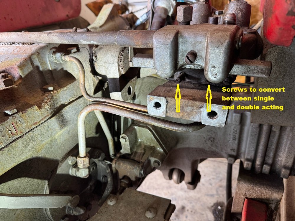

The screws operate a switch valve for each spool. Fully out is for single acting cylinders and the drop port is to be plugged. I am guessing the valve with one port capped off is set for single acting and operates the loader lift cylinders. The screw turned fully in is for double acting cylinders. That should be the spool operating the bucket cylinder.
Is there a way somebody could identify the screws in one of my pictures? I do not know what screws you guys are talking about.
Jim, who is more familiar with your tractor’s setup seems to be away from his computer right now. As long as you do your flow tests connected to the remote that had two hoses plugged in it that should give you a valid test. I am going to look at the MF (AGCO) parts site to find the single/double action switching “screws” to point them out to you.
Sorry, I can’t find a clear description in the parts diagrams of the “screws” mentioned. Your remote valve looks different from what I see in the parts book. I believe this is because your tractor has an optional “Auxiliary” system as Jim mentioned.
Thank you very much for identifying the screws!
The fact that I see a cap on the dump port of the right spool's ports indicates that is the spool you use for your single acting loader lift cylinders.
The left spool would be the double acting one (both ports have hoses). It is very likely the screws for the switching valves are set properly, if your loader worked properly.
This appears to be coming down to the quick connects are not into the left side couplers correctly and possible hose issues as has been mentioned several times.

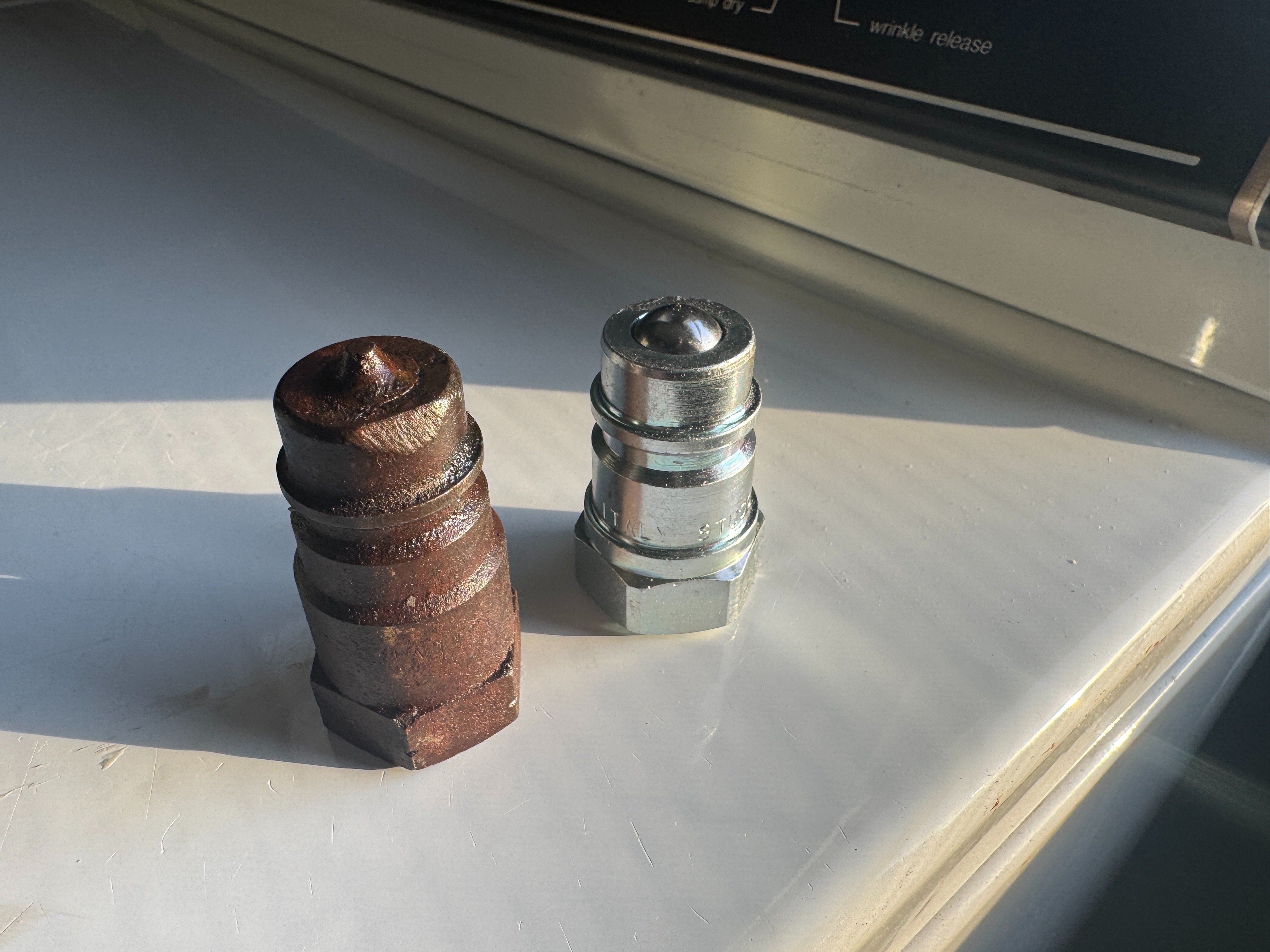

Well, guys, I feel like a complete idiot! I knew from the get-go that the hose ends were different, but I didn't think it mattered. It does! On the left is the hose end that came on the backhoe and the one on the right is what the tractor needs. I purchased 2 new hose ends and everything works as it should. However, one of the hoses blew out almost instantly. I will have to replace all the hoses because they're all in terrible shape. Looks like this thing has sat outside it's whole life. Anyway, I sincerely appreciate all the comments and suggestions! I've learned a lot!

Proper, matching couplers are important. Glad you got it.

Thank you for your suggestions. I changed the quick disconnect fittings and it all works as it should. I appreciate your input.
It might kink it, but 2000 psi +/- shouldn't deadhead against a kink. However, I agree, replace that hose before it blows oil all over you and your shop!
You called it! As soon as I changed out the hose couplers on the backhoe and activated the left outrigger, the hose blew and even though I was a few feet away, it got me in the face. No harm though, just annoying. Believe it or not, I was wearing safety glasses and that helped prevent it from squirting me in the eyes.
