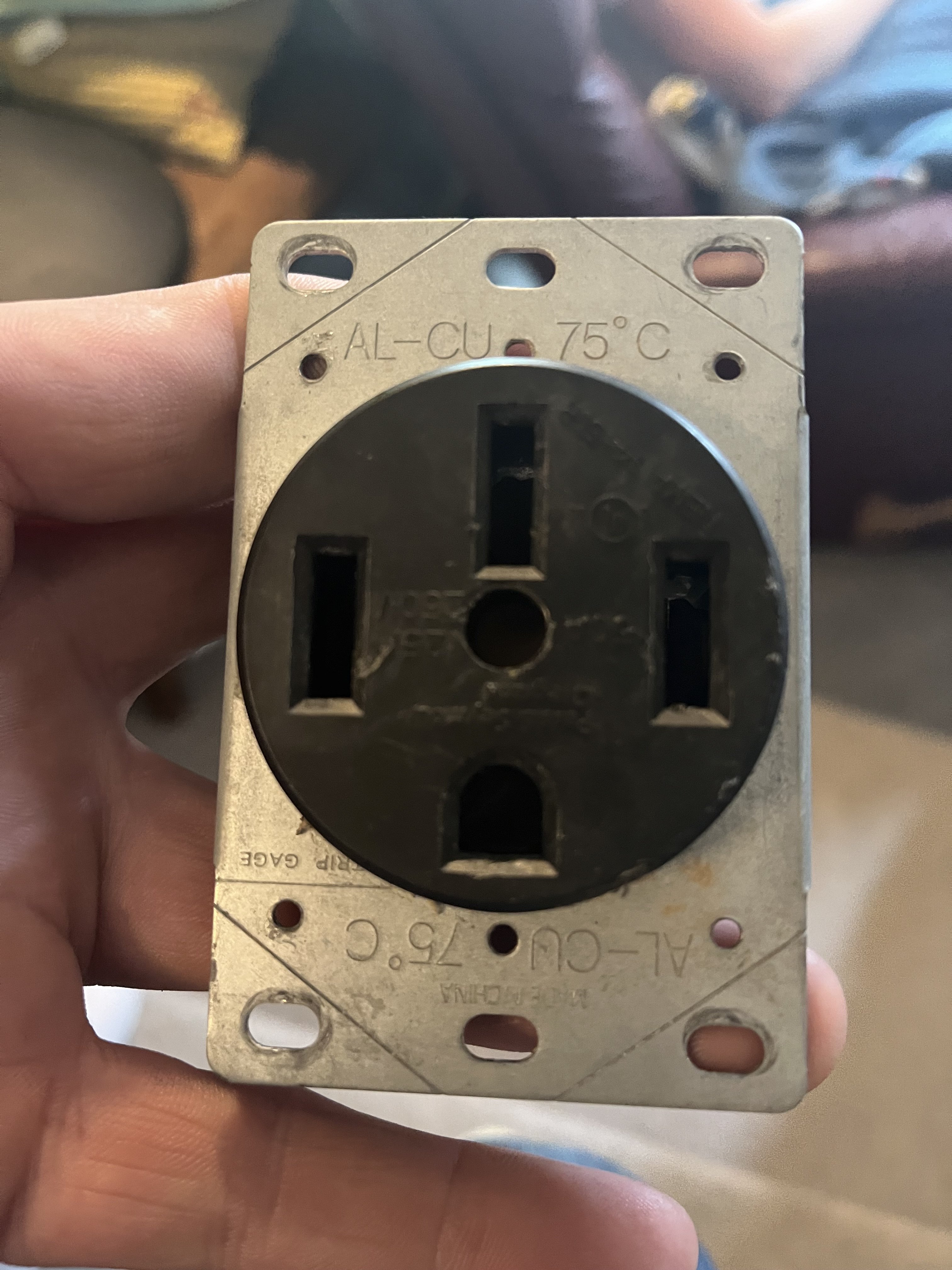

What is this plag used for? I don’t think I’ve seen a four prong plug before.

Looks like a regular 50A 125/250V receptacle, used for RVs, welders, some larger electric stoves, etc.
My welders all have 3 prongs, but are older. I believe this 4 prong gives you neutral and ground.
What I heard was that for modern day 220 appliances, which have electronic controls, they had to be able to split off 110 volts to run the electronics, which didn't work when only a ground was used as the 3rd leg. Or was it the neutral as the 3rd leg? I obviously don't know what I'm talking about! steve
Most common use would be for 50 amp RV service or an electric range. Current code sez dryers and ranges need four-wire service; that's been code for mobile home appliances for a long time.

Mornin Glenn, good question so for you and other non sparkles here’s the deal
The receptacle shown is identified as a 3 Pole 4 Wire NEMA 14-50R Grounding Outlet. It has the two Hot UnGrounded L1 & L2 conductors slots side by side,,the center slot is the Grounded Conductor aka Neutral and the rounded slit is for the Equipment Grounding Conductor. It’s 240 line to line but 120 from either line to Neutral. It can supply a 50 amp rv with two legs of 120 and other tools or appliances that require both 120 and 240 which is why the neutral and ground are both available
If a 240 volt only welder is used a 3 prong plug and receptacle can suffice as it has 240 line to line and the third wire safety ground.
While 50 amp rv is a common use a range or maybe a welder that needs 120 and 240 could use such a receptacle. The grounded conductor neutral is for normal return current while then EGC is ONLY for fault current.
Hope this answers your question

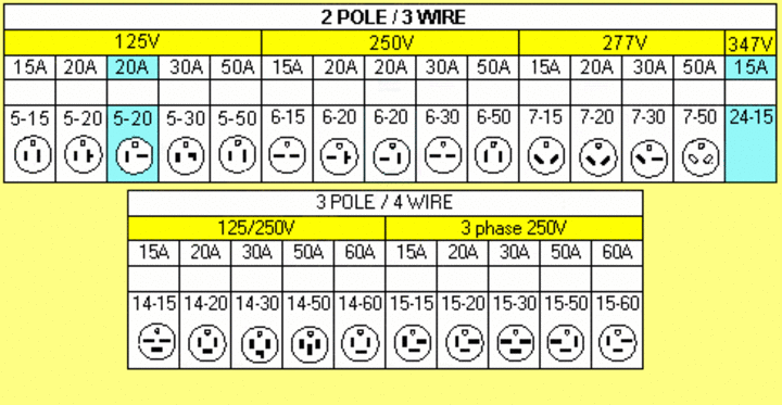

The four wire separates neutral and ground. A three wire uses the neutral as ground and the equipment has some type of bond from the frame to neutral. I converted our electric dryer from three to four because the duct started to arc to a nearby water pipe. Never happened in 40 plus years but it did it after a new dryer was installed.
